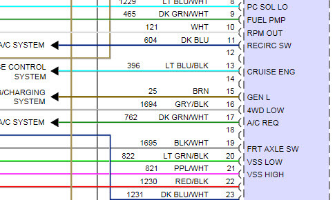

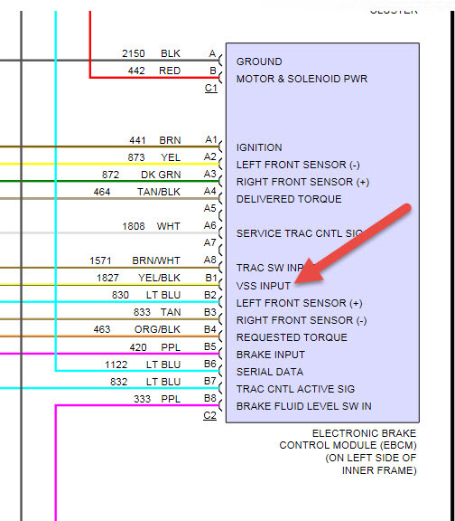

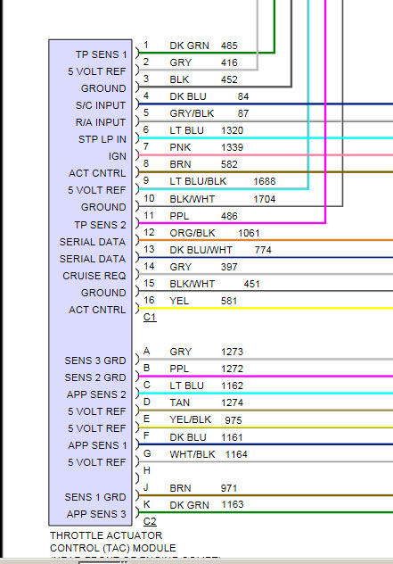

Trying to install a Gear Vendors over and under transmission on my 2000 GMC 2500. Looking for the ABS, Speedo and Cruise Control at the VCM. Pic I have from Gear Vendors is wrong.
Jul 2, 2015 at 10:42 AM
HMAC300
  • 48,601 POSTS
our annual for 2000 doesn't show a 6.0 it only shows 5.7, 6.5 and 7.4 engines but I'm pretty sure they were made that year. here is ones for abs, cruise and pcm. this is out of a 2001 truck
