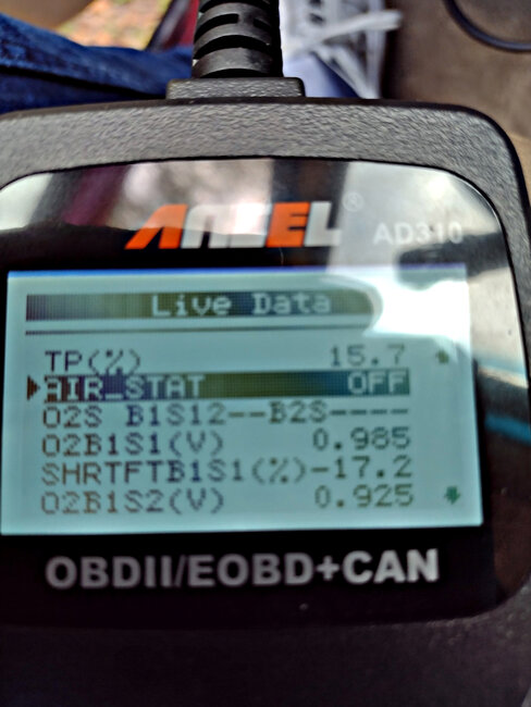

I got the error code P0420, Catalyst System efficiency below threshold Bank1.
I know that I have a possible exhaust system leak, but also wondered if it could be the O2 sensor that is after the catalytic converter. The insulation sheathing is either worn off or chewed off. I tried to get a decent picture of the live data codes.
The O2B1S1settles to varying between around .950 and .965 approx., and the O2B1S2 varies between .925 as shown here in the capture to around .985.
I'm not sure what that means. Any hints? Thanks.

Based on the live data, the engine is running very rich (too much fuel). As far as your question is concerned, code P0420 usually indicates the catalytic converter is bad. That isn't always the case, but in many cases it is.
As far as the O2 sensor is concerned, the scan tool indicates you are getting a signal voltage from it while the engine is running. And the sensor is within range.
So, here is what I need you to do. We need to determine if the converter is bad. If you look through this link, it explains what to check. If you have an infrared thermometer, you can check the converter temperature at the inlet and at the outlet to see if there is a variation. The difference should be between 30- and 100-degrees difference between the front and rear. The rear will should be hotter.
If the temperature is the same at both ends or the rear is cooler, replace the converter.
Let me know what you find.

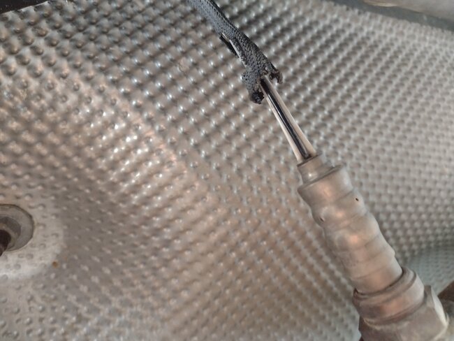

I ordered an infrared thermometer and should be here Friday. In the meantime, I found the nuts missing on the connector flange of the muffler, the one on the engine side of the muffler. Found replacements and am putting them on and tightening them up. Had a bad exhaust leak with those off. I also noticed that the o2 sensor wires have one wire with no insulation. Sheathing covering the wires disintegrated for about 3 or 4 inches and wires exposed. All have insulation but one. I've enclosed a photo. Is this normal?

Yes, that is expected. They are exposed to a lot of heat. On the other hand, I didn't realize there was an exhaust leak pre-catalytic converter. That can cause the oxygen sensor to think the engine is running lean.
When that happens, the computer tries to compensate by adding fuel to the air/fuel mixture. This could be contributing to the code. Also, if the fuel mixture was extremely rich for a long period of time, it may have damaged the converter.

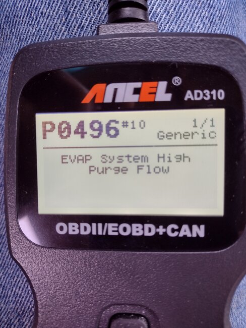

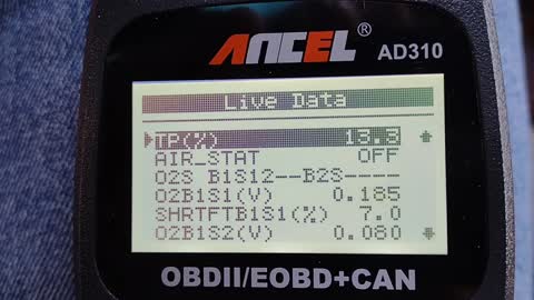

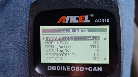

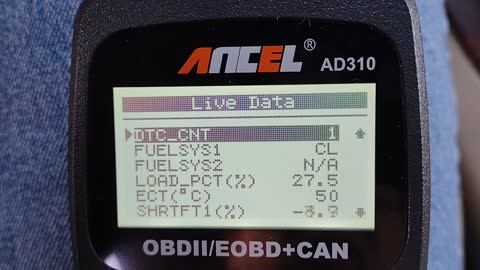

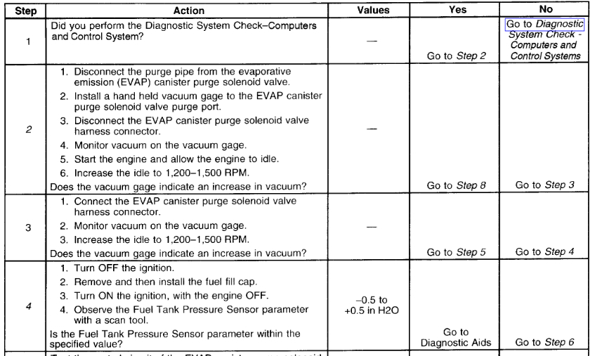

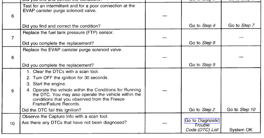

Hi. I just ran the car and recorded three videos of the Live Data from the OBD2 scanner. The only code that shows now when I read the codes was P0496, which I have another separate question here on that.
Craig
Feb 7, 2023 at 6:43 AM

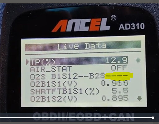

Watching the live data, I noticed the oxygen sensor, bank 1 sensor 1 is not producing a voltage signal. Is that correct? See pic 1 below.
The next two pics are diagnostic for the new code.
Let me know your thoughts.
See pics below.

O2B1S1 is at 0.910 in that image. I never saw it go to zero. It always had some voltage present. Thanks for the pics for the other code.
