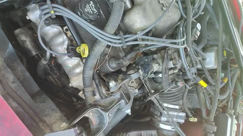

Here is the video requested.
Mar 18, 2025 at 8:42 AM
It is hard to tell from the video, can you film the engine from under the hood? From what I can tell from this video it is not good, but I want to be sure.
Mar 18, 2025 at 9:46 AM

Yeah sure thing sorry about that.

So anything?
Mar 19, 2025 at 7:48 AM
Wow, that engine is hurt, sorry. The engine will need to come apart to see what happened. You can confirm it with a compression test. Thanks for the video, it makes things easier for us.
