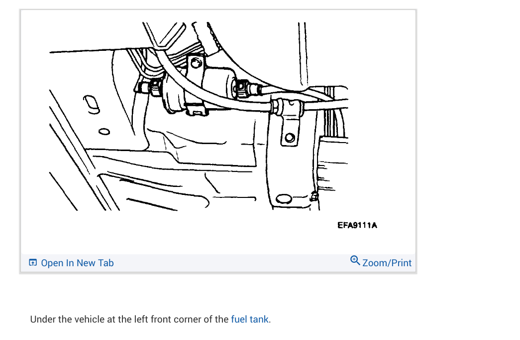

Need help locating the in line fuel filter
2004 HYUNDAI XG350
242,000 MILES
[email protected]
MEMBER
1 POST
FOLLOW
I've raised the car and traced the fuel lines under the car from tank to firewall and no luck.

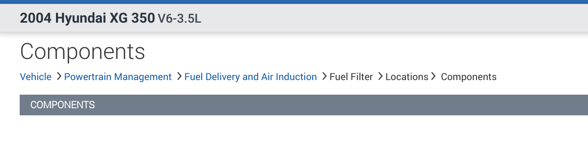

It's by the left front corner of the fuel tank. I have the information and a diagram of it in the diagrams down below. I hope this helps.
