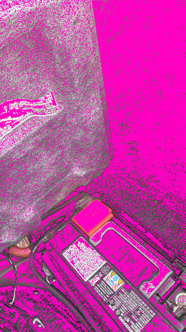

Can you tell me the part sitting on top of the spare in the image is used for? The image is taken from the trunk of the car listed above SXT.

No image came through. Please try uploading it again.

Here you go.

If you are asking about the item with the handle on it, that is the main battery for the car.

Thanks for your response, I am asking about the item connected to the wires on top of the spare tire?

See if you can get a wider image of it. In the image we have it's all a pink blur with only the top of the battery identifiable. Sorry

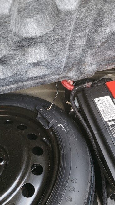

My mistake. First one is a .gif. Let's try this again.

Okay, that's a lot better. That is the antenna for the remote entry system, it is supposed to be clipped into a holder that would be in front of the spare on the shelf. Looks like the clip released or failed.

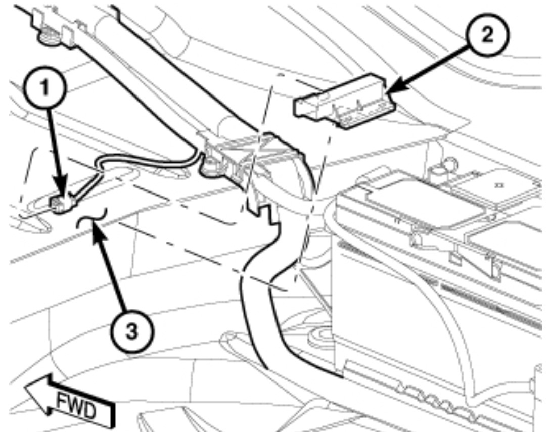

Awesome. Where can I find the diagram?

The picture I attached is all they show.
