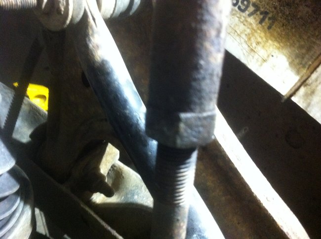

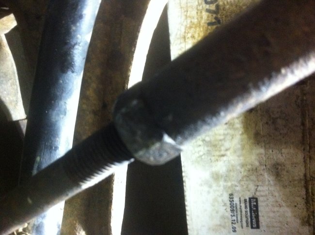

I tried that a few times.Will not losen.I am going to change the inner one to.can I remove the inner tie rod while the outter one is still attached to it?Here are a couple pics of the nut I cannot losen.

have you tried what I suggested by heating then cooling with the penetrating oil an dtapping nut all around? that usually works you can pull the inner and outer with no problem other than the boot will have to be replaced on to new inner.

Yes I did tap it..Not sure what the deal is.The inner one is going bad anyway.Its not tight in the joint.Lits of play.I was going to replace that next pay day.But I'll just do it now..Thanks for the advice..This site helps allot

I tried the heat,cooling,an tapping one more time an it popped loose.It did not work the first few times I tried.Anyway,rented the tie rod adapters an the inner came out easy.Put all the new parts on an just got a wheel alignment.Good to go.Appreciate the help you guys give.It helps allot.Especially for someone like me who likes doing my own work.
