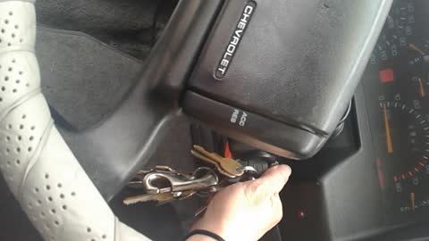

So is the engine cranking and not starting or not cranking over? Can you please shoot a quick video with your phone so we can see what's going on, that would be great. You can upload it here with your response.
Sep 26, 2019 at 10:19 AM

Not sure if you got video?
Sep 26, 2019 at 2:23 PM
I dont see it? Did you upload it?
Sep 27, 2019 at 4:33 PM
LISA MARTINEZ
  • 23 POSTS
I did twice.
Sep 28, 2019 at 7:32 PM
LISA MARTINEZ
  • 23 POSTS
I read code by putting paper clip in obd-1 and I got no codes.
Sep 28, 2019 at 7:40 PM
Thank for the video. it sounds like the fuel pump has gone out (no pressure). To confirm here is a guide to help test the fuel pressure:

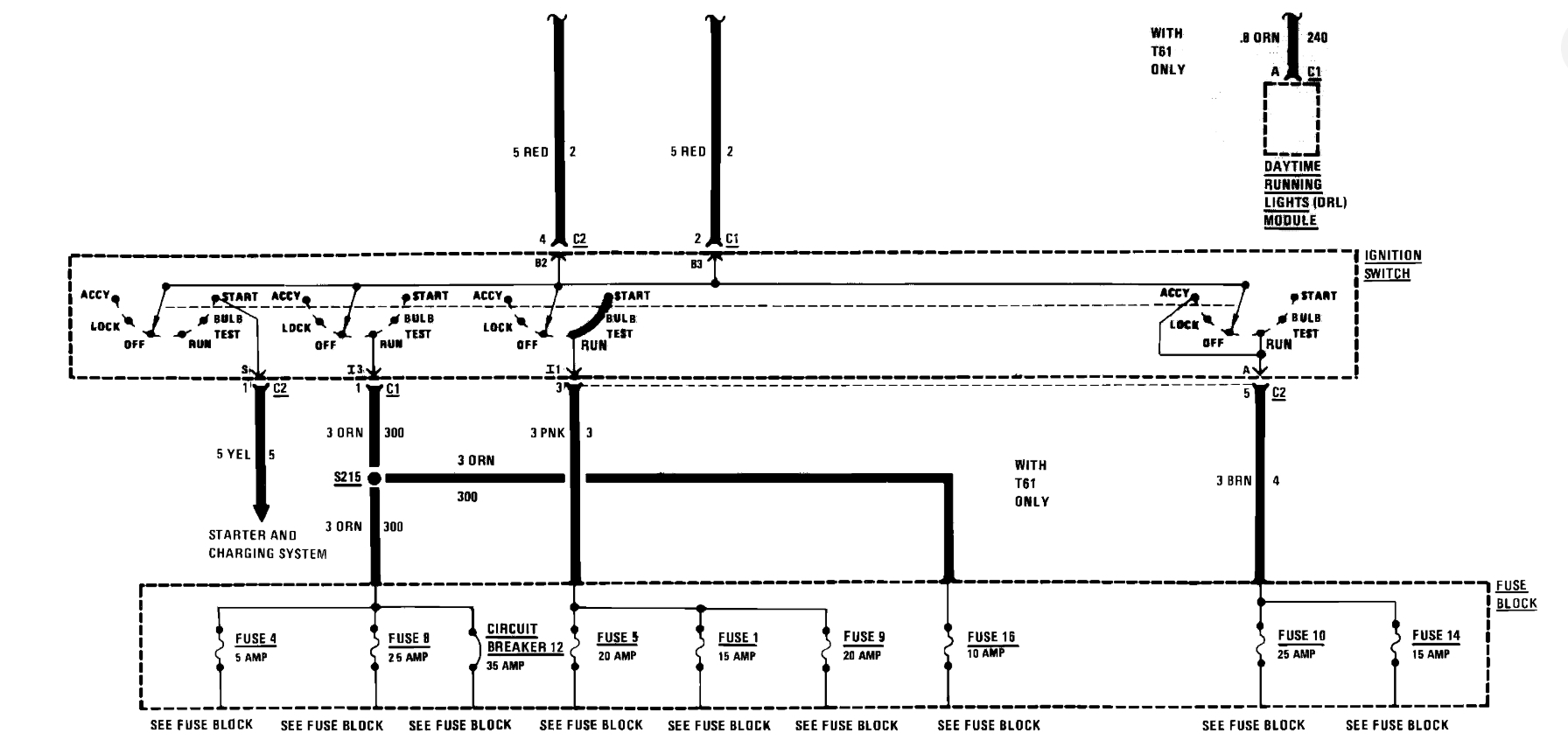

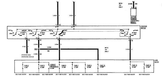

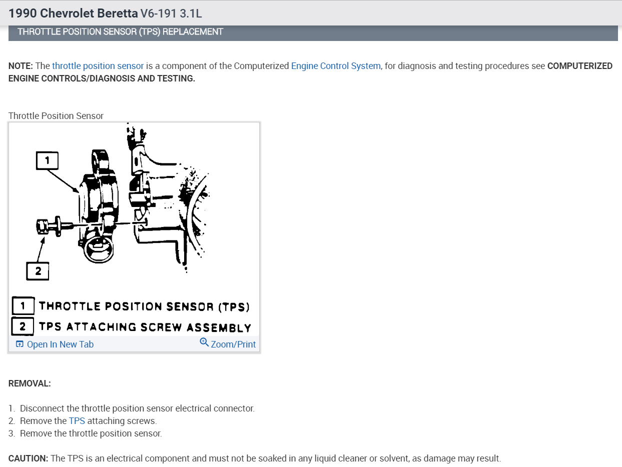

I am getting good fuel pressure, reading a code 12 and 22.
Oct 16, 2019 at 3:59 PM
Code 22 is the TPS sensor out which can cause the issue. here is how you replace it. Check out the diagrams (below). Please let us know what you find.
Oct 19, 2019 at 10:18 AM
LISA MARTINEZ
  • 23 POSTS
Nope it's good. I have a question, if ignition went out it would tell the PCM cannot start. how to clear codes and how does it know that it has a new one or bypass?
Oct 19, 2019 at 11:04 AM
Yes if the switch went out the PCM will not get power. To be sure here is a guide and the ignition switch wiring so you can test through it. To clear the codes disconnect the battery.
