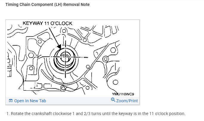

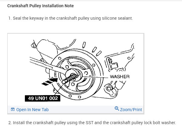

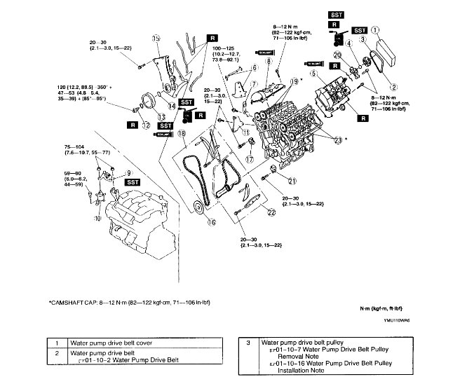

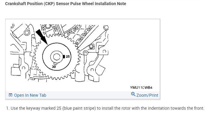

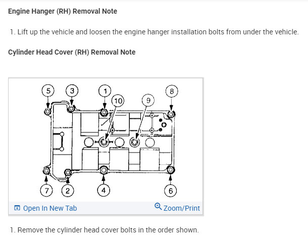

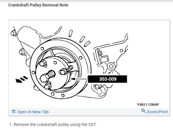

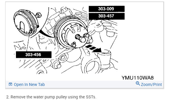

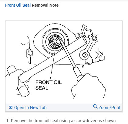

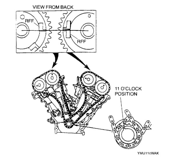

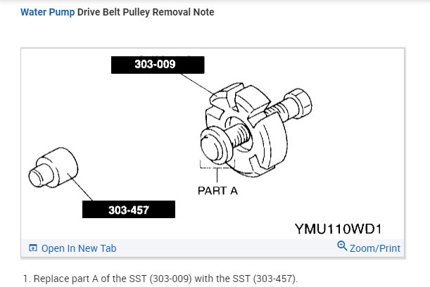

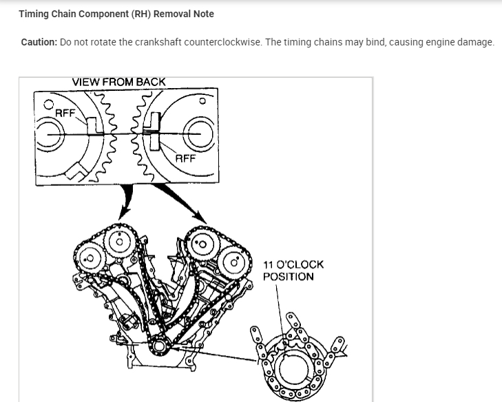

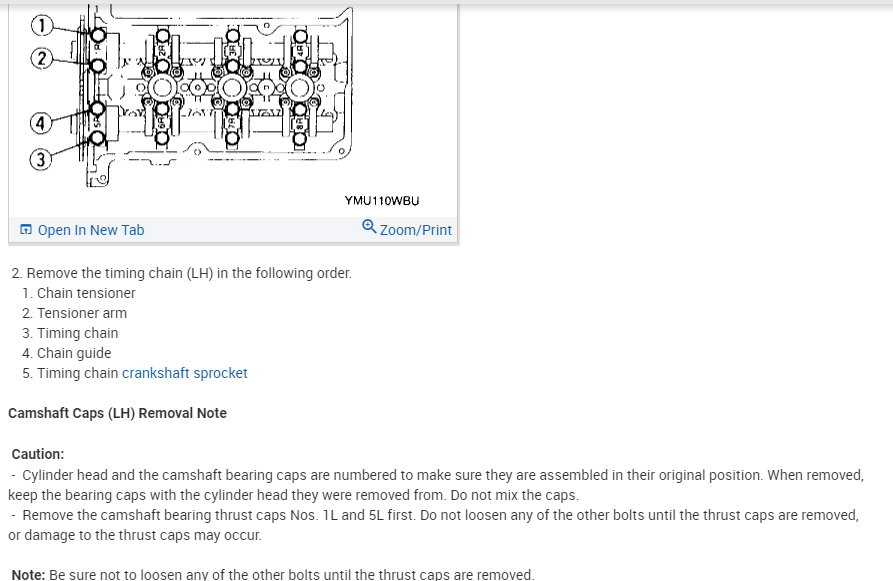

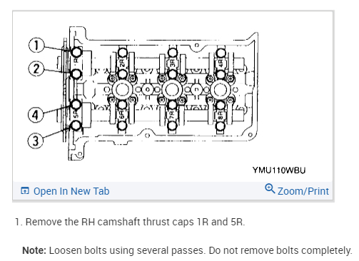

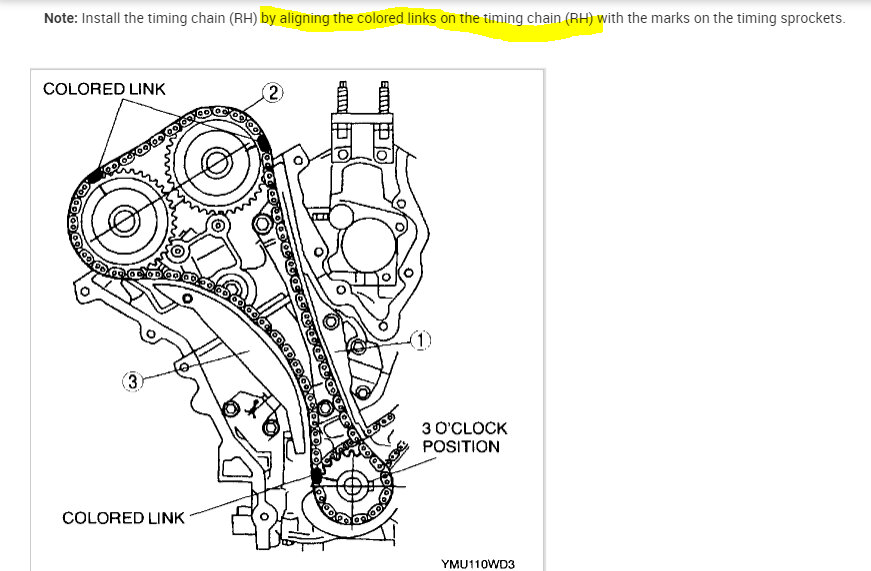

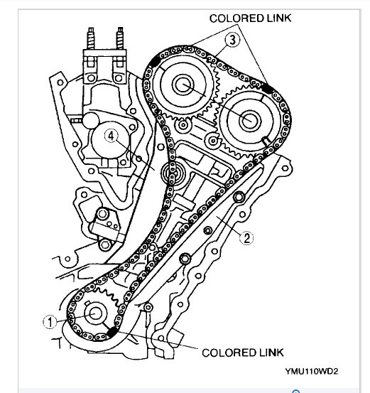

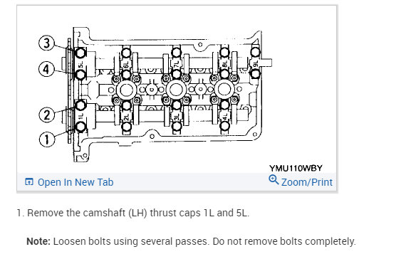

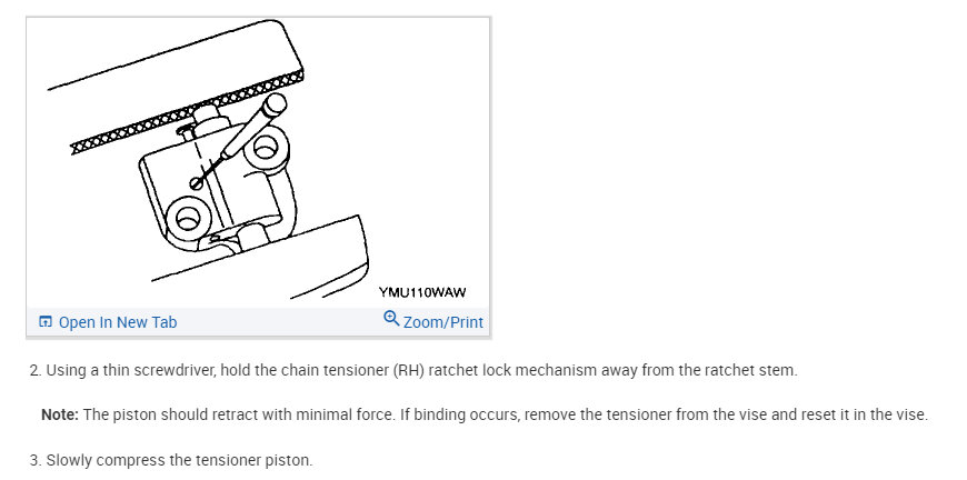

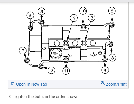

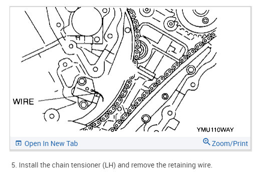

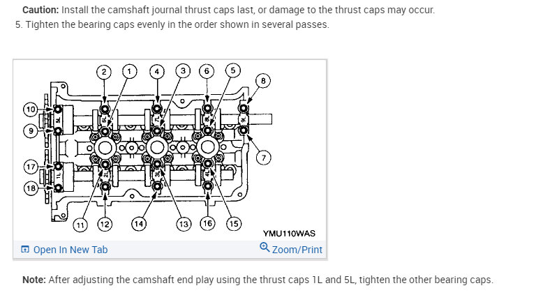

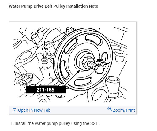

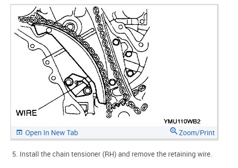

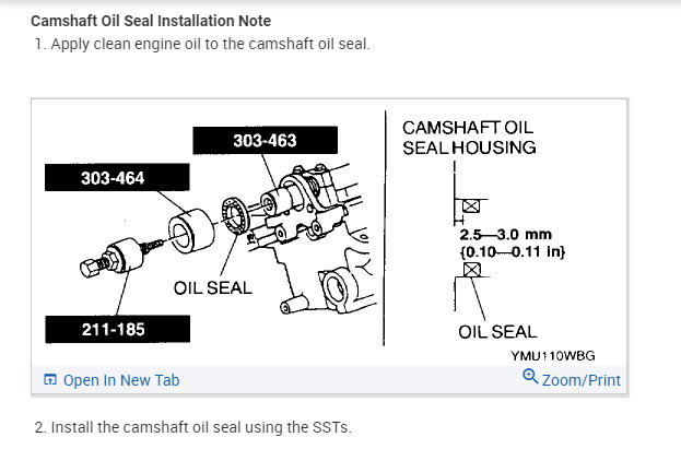

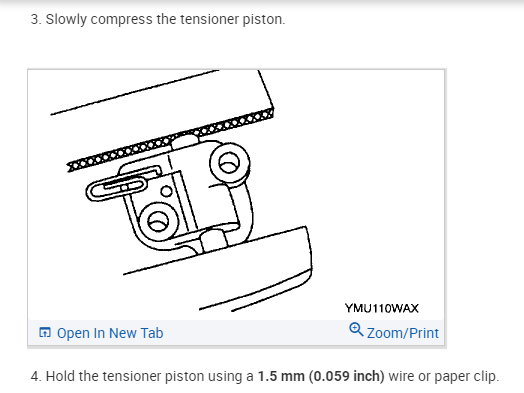

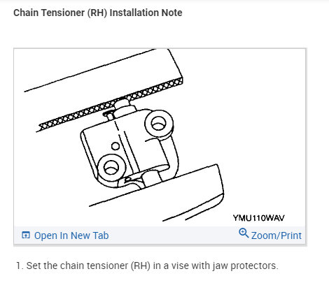

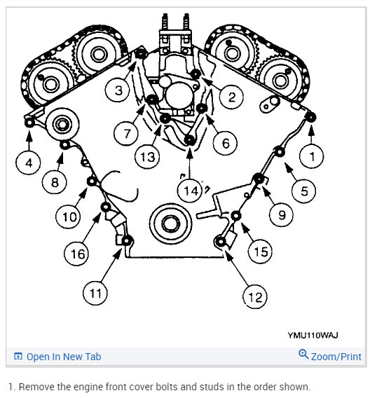

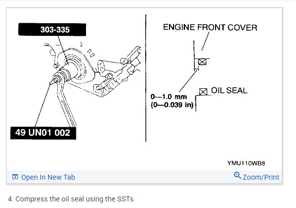

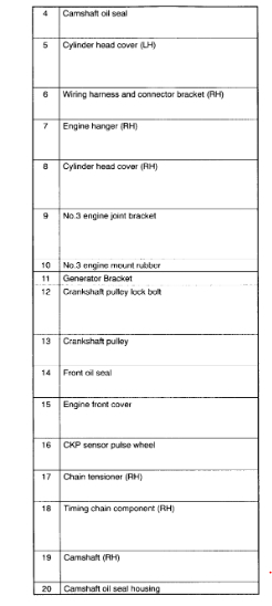

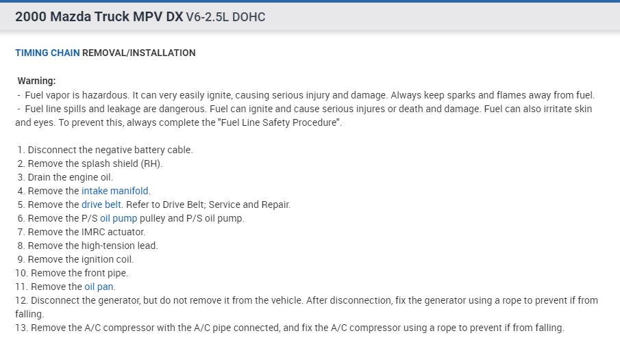

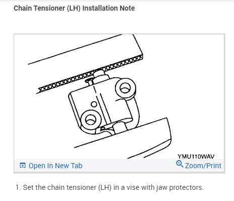

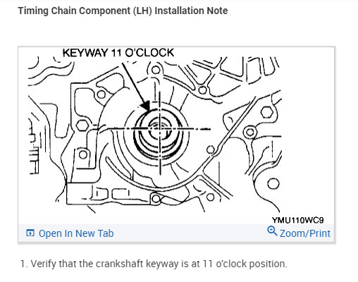

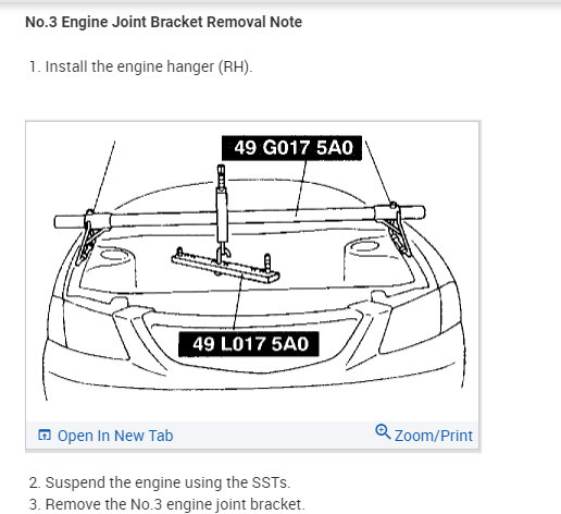

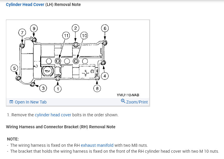

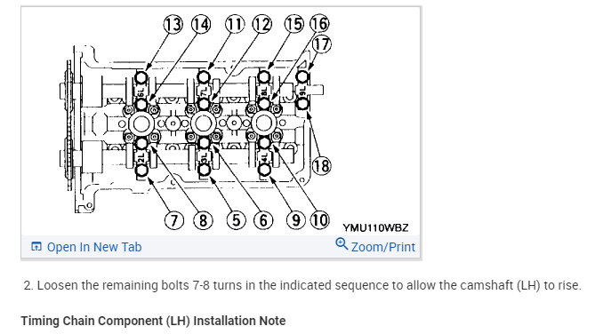

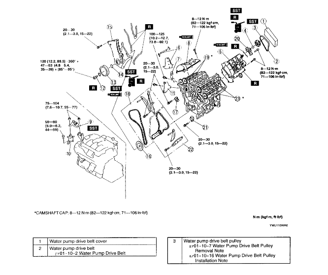

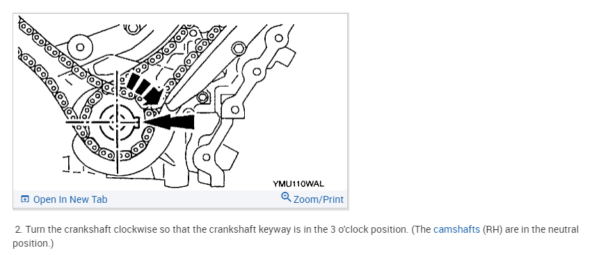

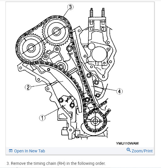

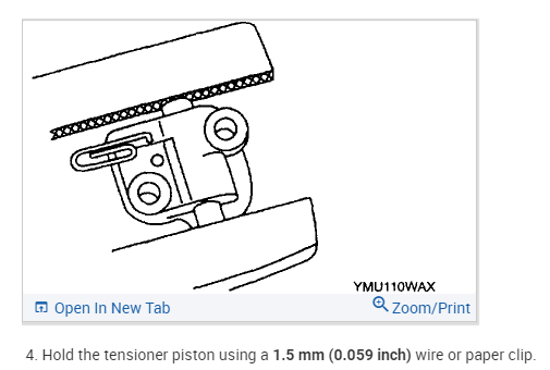

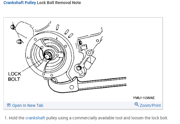

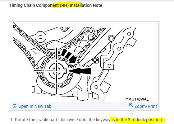

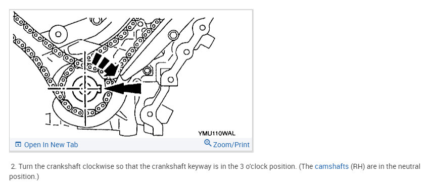

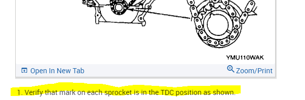

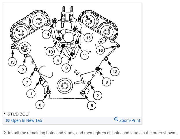

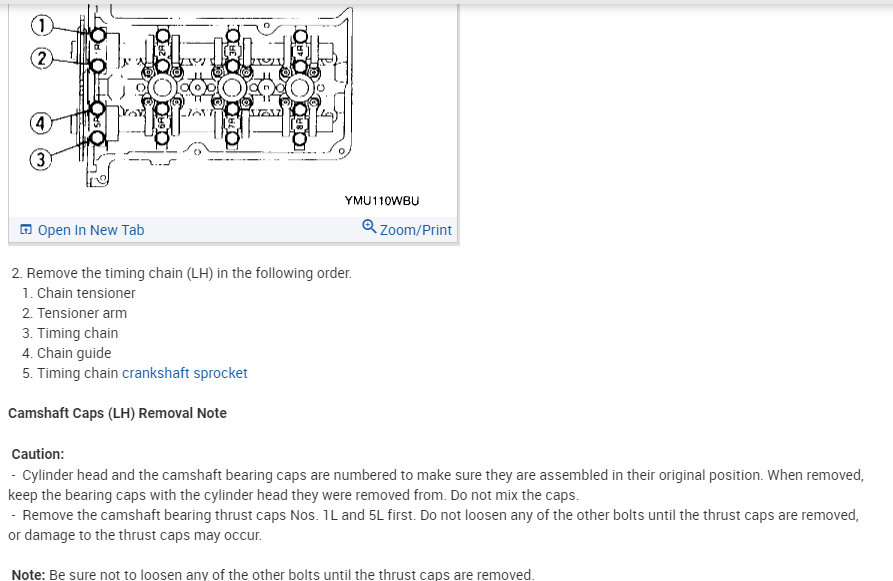

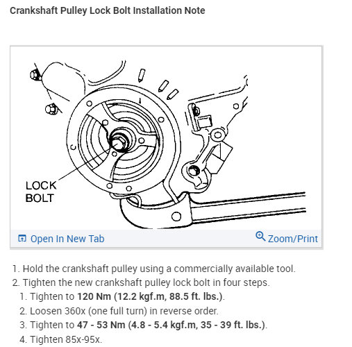

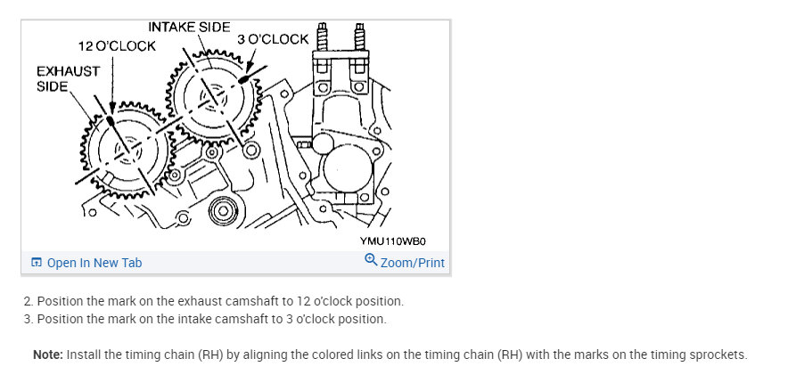

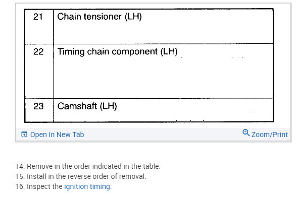

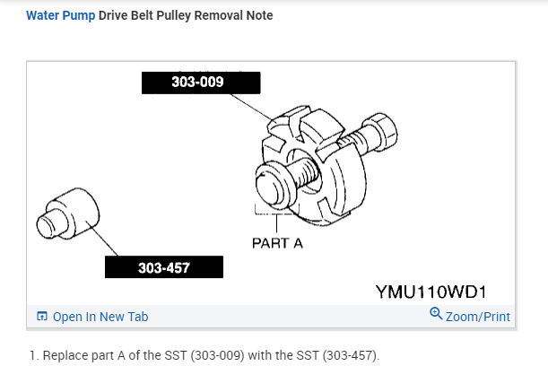

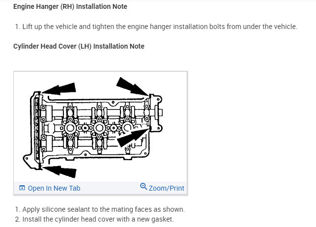

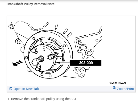

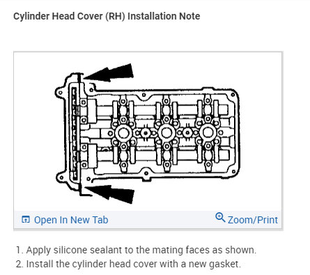

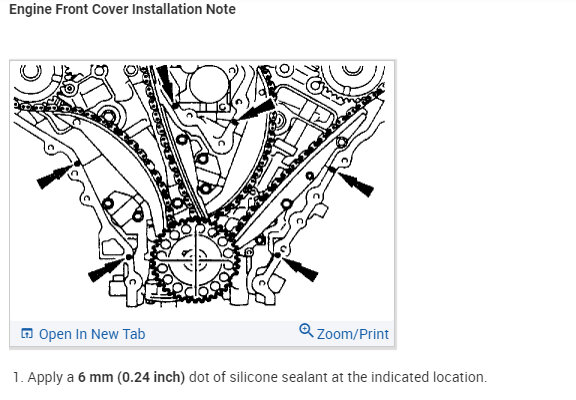

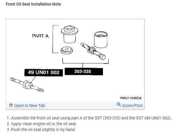

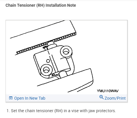

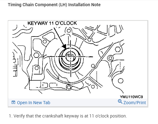

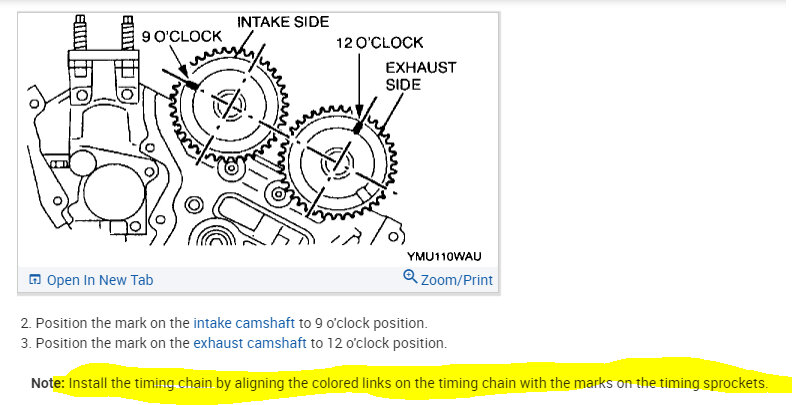

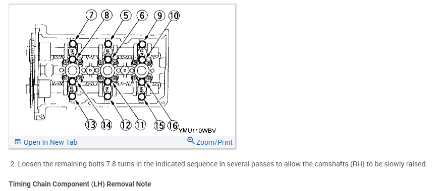

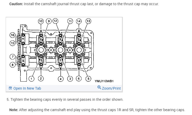

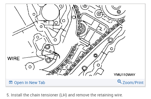

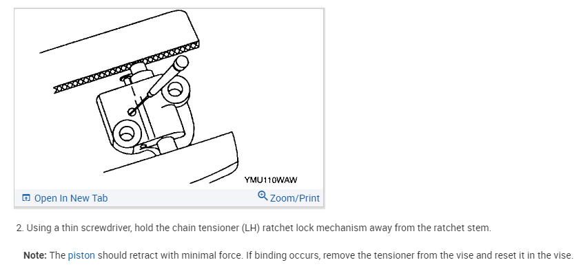

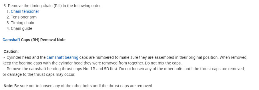

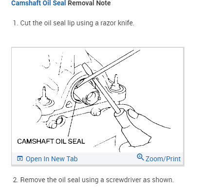

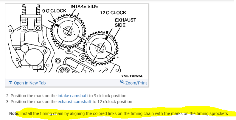

There isn't a specific cam tool for this engine. Proper timing chain alignment is done by aligning the colored links on the timing chain with the marks on the timing sprockets.

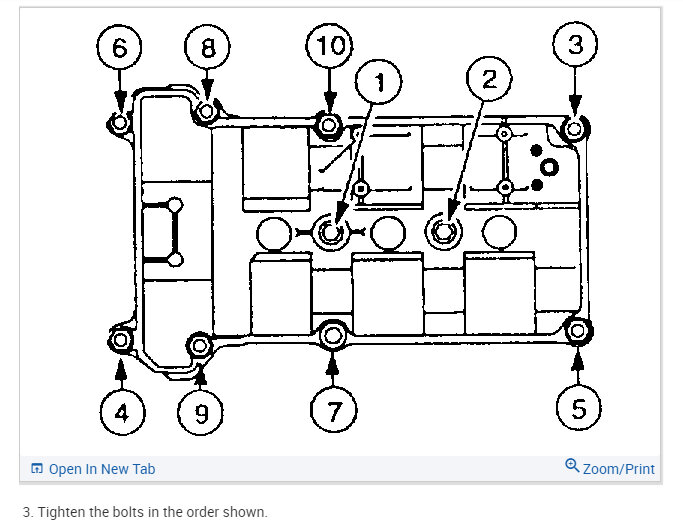

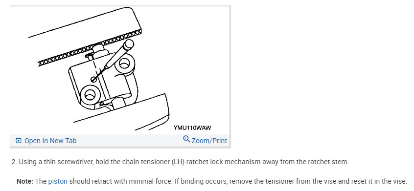

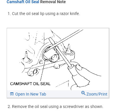

If you look below, I provided the directions for the removal and installation of the timing chain. Take a look through them and let me know if you have questions or what I can do to help.
See pics below.
