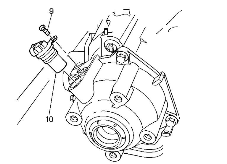

Good afternoon.
The speedometer may be the sensor on the transmission. It usually sets a code when it has failed.
The ABS has a fault code stored. I need that code to narrow the area of failure for you.
https://www.2carpros.com/articles/abs-wheel-speed-sensor-test
The transmission may be a clogged filter in the pan. I would start with having the transmission service first and see if it helps.
