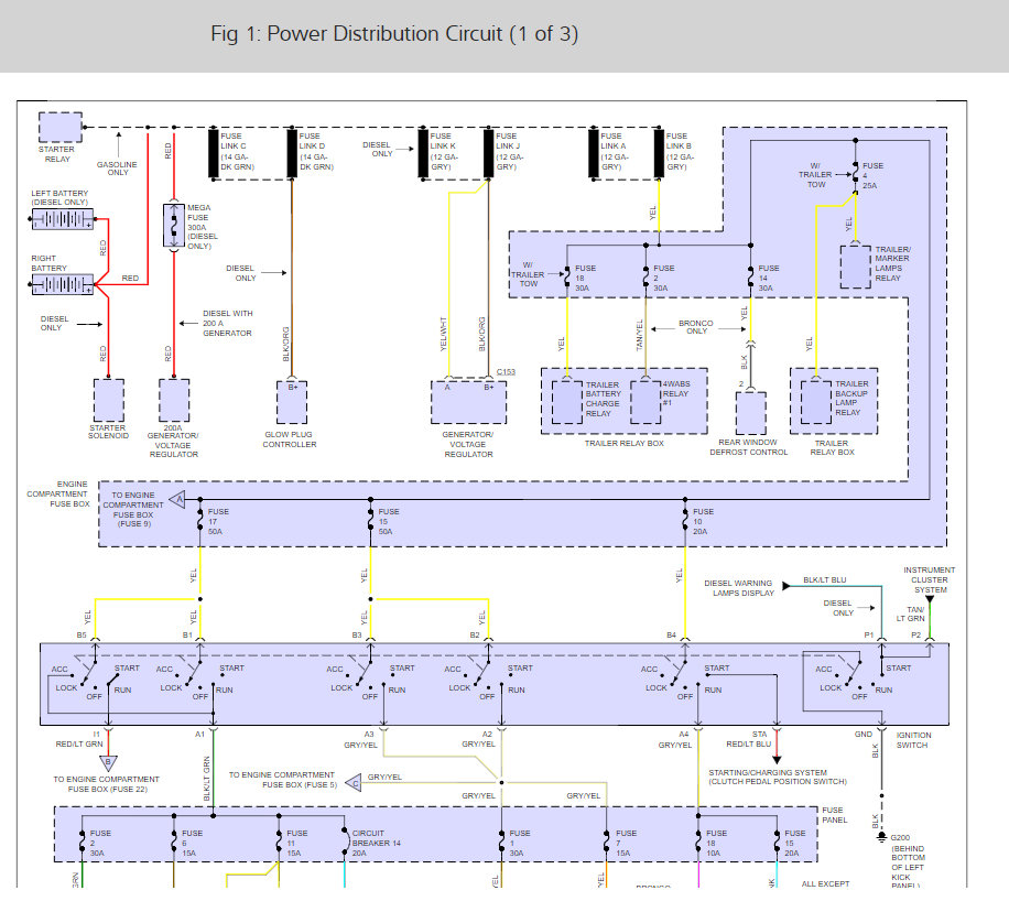

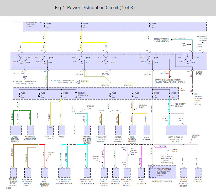

This is just a plow truck. The engine is a 460. It goes for about one hour or so and shuts off with no warning. let it cool off starts up like always. No codes at the Ford dealer. One time I was parking it and raced the engine and it would shut off the minute it hit 1500 rpm's on the tachometer let up the gas and it would stay running.. Every time it stop running it is working hard over 1500 rpm's . The Ford dealer ship has given up. I am desperately needing help.
