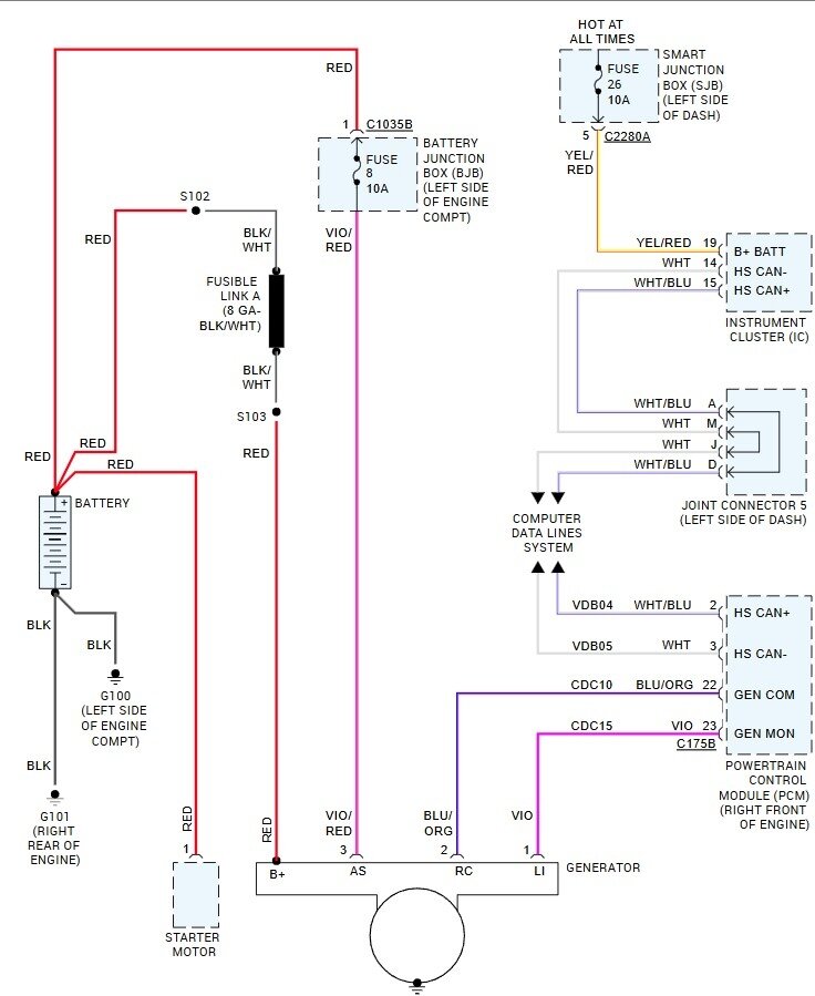

Hi Steve. Thanks for all your help. I tested the battery and it was 12.72 when I turned on the lights it dropped to 12.04. I started the car and there was no change, it stayed at 12.04. I let the car run for a few minutes and stayed at 12.04. I did the drop tests and from negative to block 0.00. positive to alt lead, 0.00. positive to the battery feed terminal on the fuse box, 0.02. I cleaned all the leads from the battery, alt, and battery terminals on the fuse box, no difference. I even did another parasitic test to make sure and nothing, it was the same as before. The new alternator came with a checklist showing everything working before it was packaged. Could it be the PCM not sending a signal to the alt to charge the battery?
Jan 4, 2025 at 6:15 PM
I would take the alternator in just to be sure it still works. These days failing out of the box is unfortunately common. Take your meter and check at the alternator connector for battery voltage on the red lead and the Violet with red lead. Now check between the center pin and ground, you want to see under a volt as it's a ground circuit. If it all looks good at this point, I would have the alternator tested, if it passes then further testing requires a scan tool that can read the live data for the charging circuit to verify it isn't a break in the harness and is the PCM. If you want a very powerful scan tool you could get a copy of FORScan and the wired adapter they recommend. With that you have a tool as powerful as the dealer tools.
