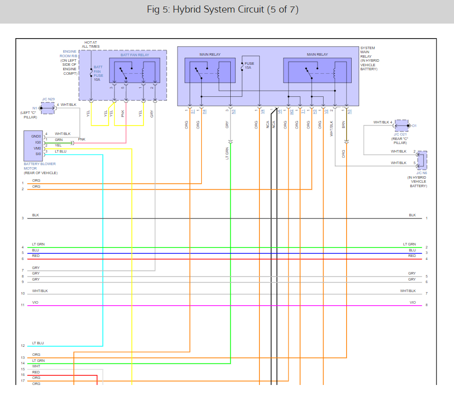

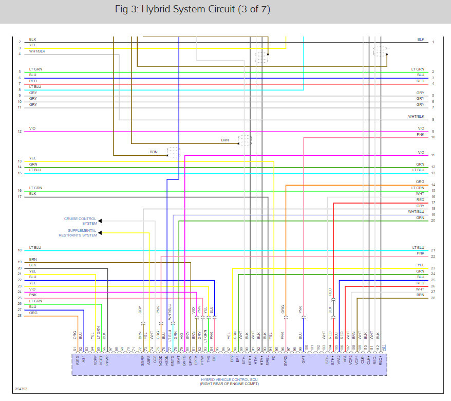

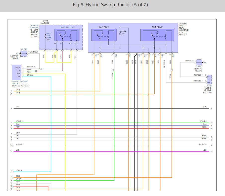

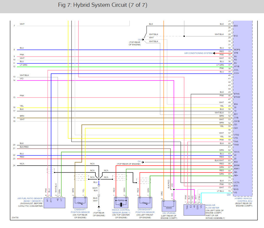

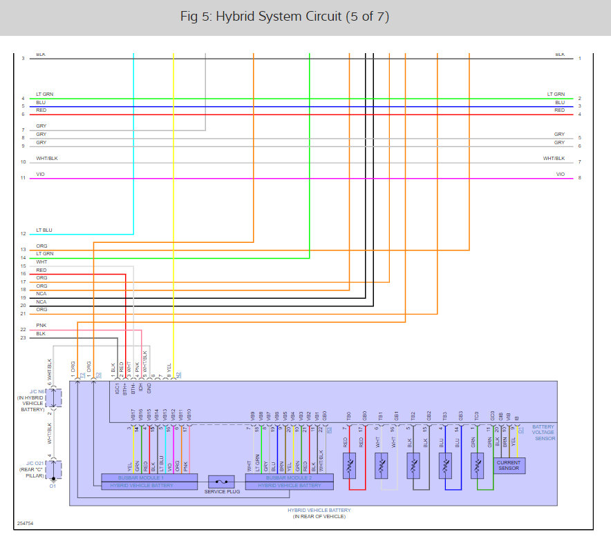

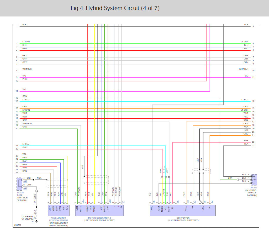

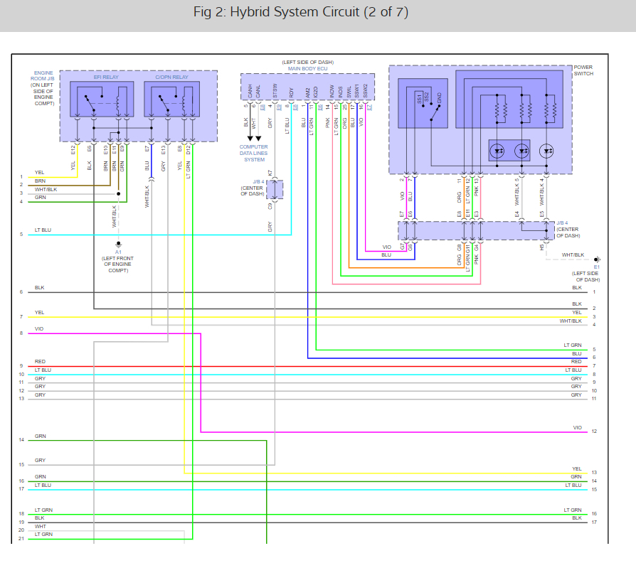

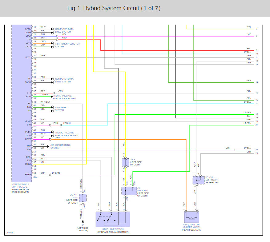

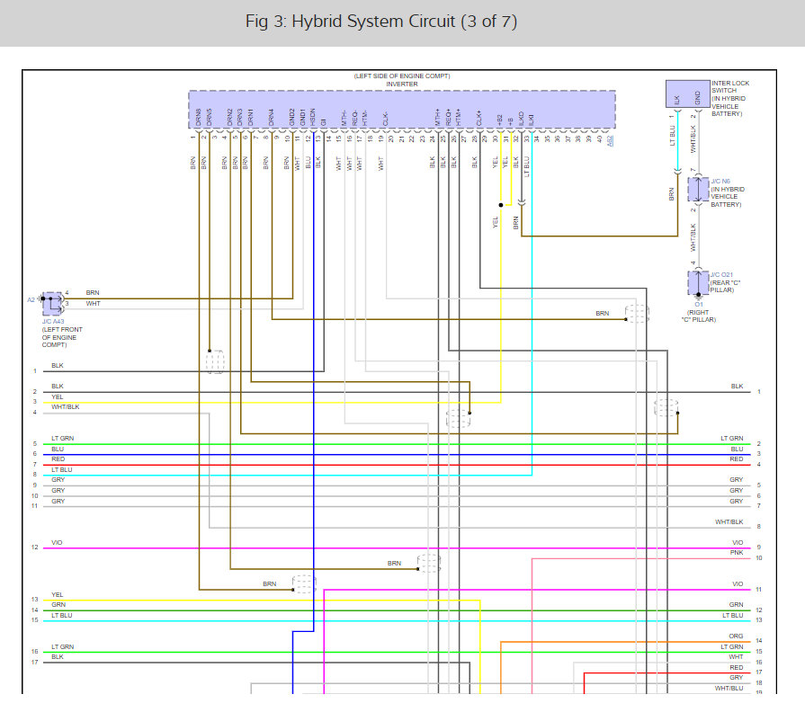

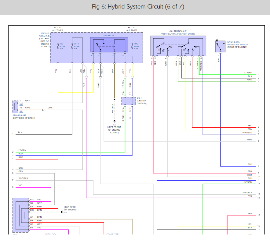

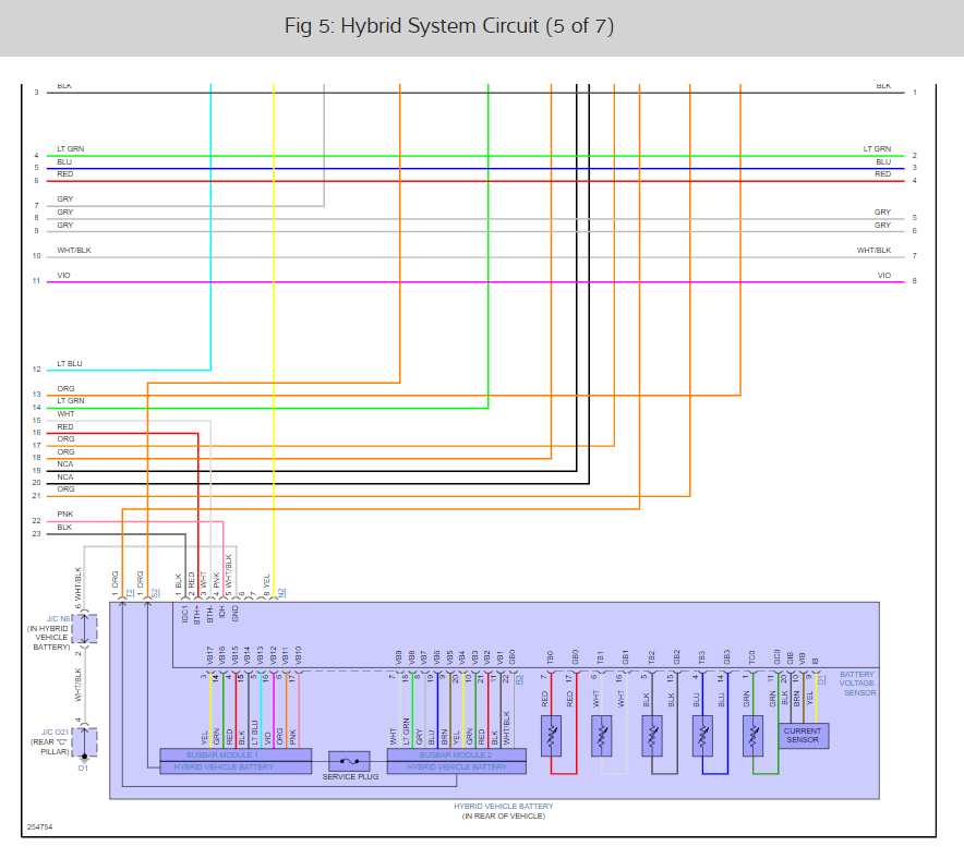

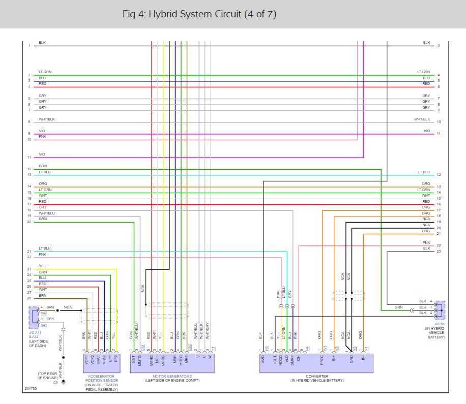

Yep, they can have the same color but go to different ECM connectors, here is a guide to help you check the connections once you are done with the repair and the engine/ECM wiring and ECM repair.

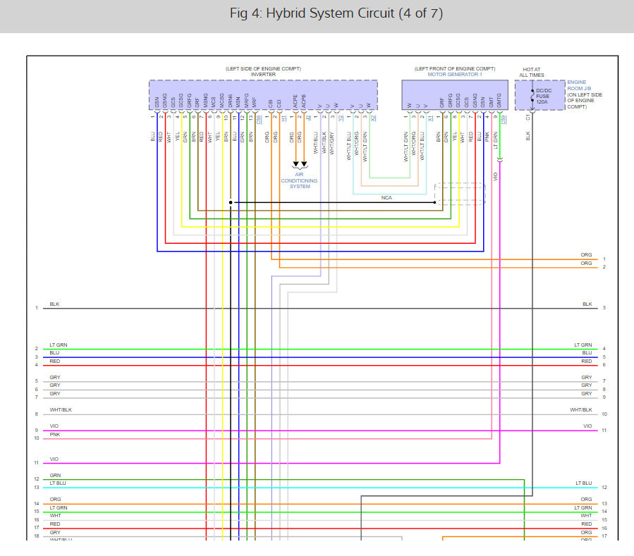

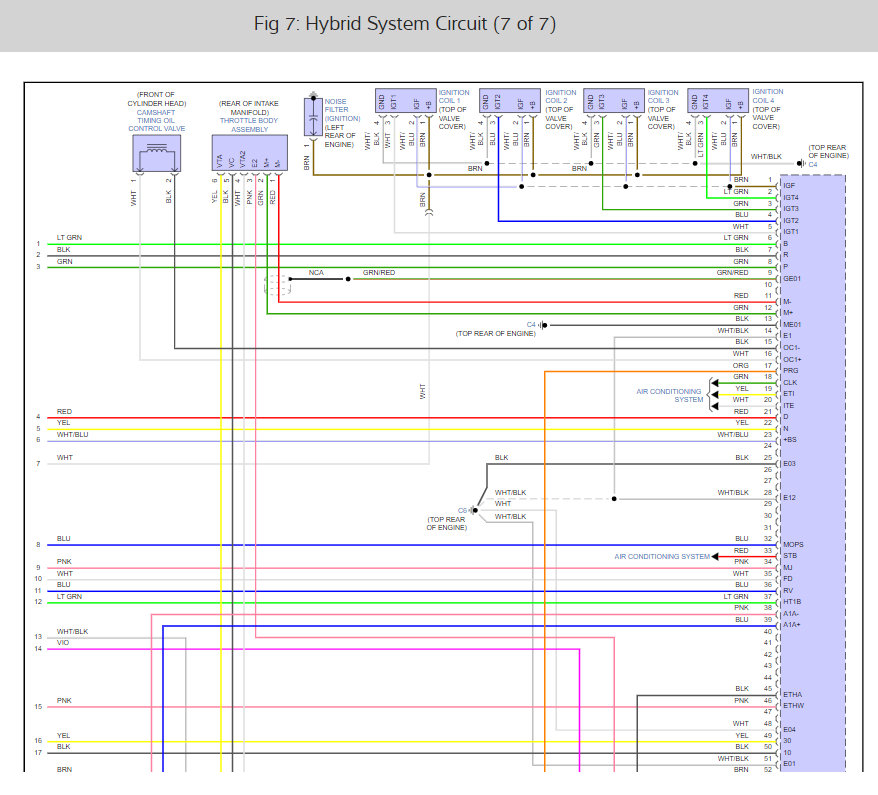

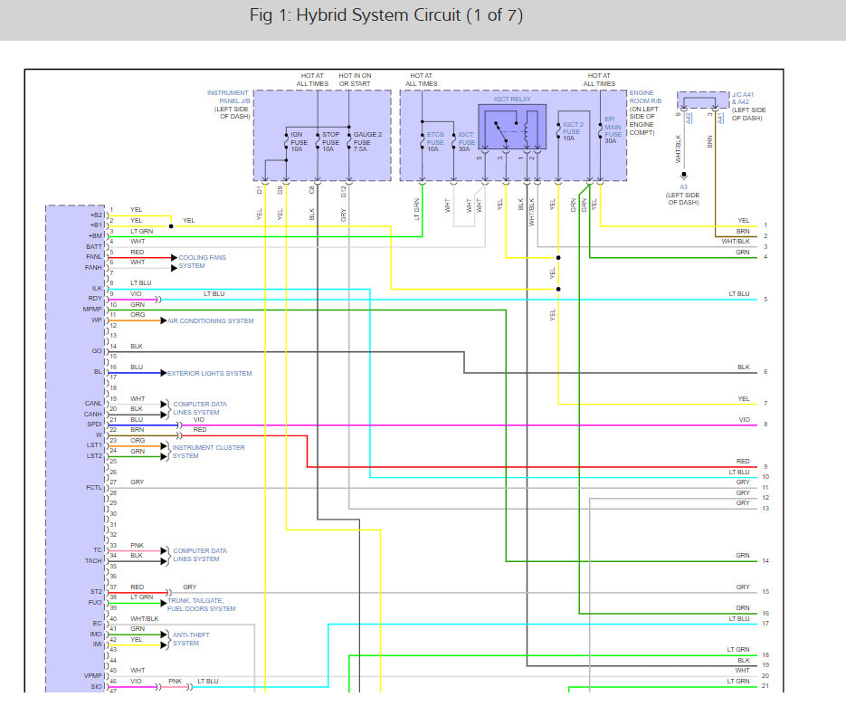

It says this car is a hybrid, so I have the engine and hybrid wiring diagrams together. Check out the diagrams (below). Please let us know if you need anything else to get the problem fixed.
Jul 14, 2022 at 1:58 PM
07SOZU143
The hybrid diagrams don’t match up to my car, I’m looking for wire diagrams for a 2007 Camry LE 2.4 4 door sedan, it’s not a XLE or hybrid model Camry. I am just waiting on my impact wrench to come in the mail tomorrow and get started working on doing a lot of work remaining to the vehicle. if you happen to find the exact wire diagram for a 2007 Camry LE 2.4 please feel free to reply back, also please make sure that if you post photos, they won’t be blurry when I save them to my phone. Thank you, hope to hear back from y’all shortly.

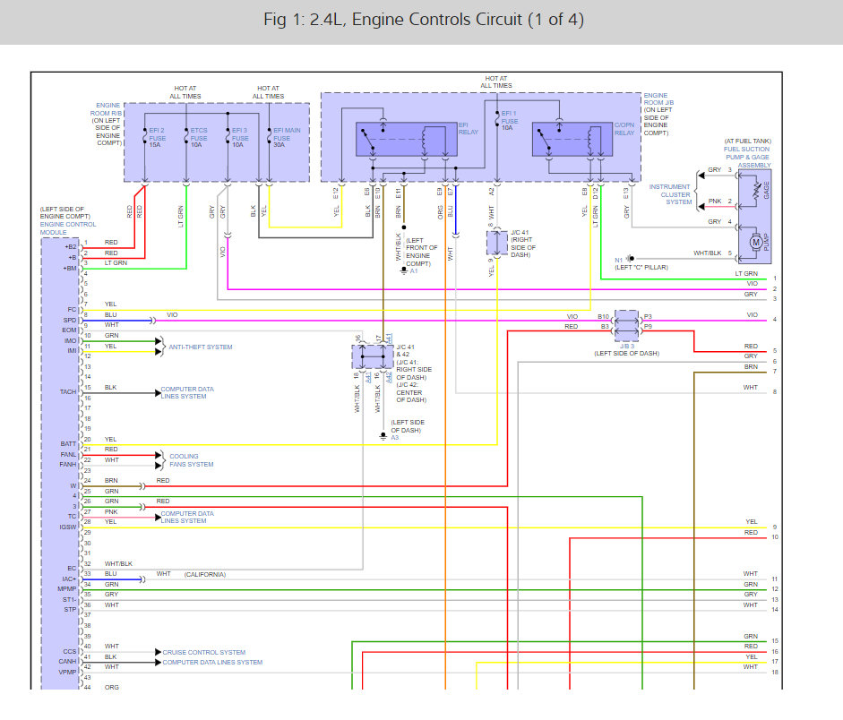

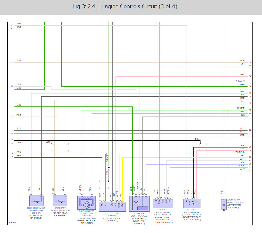

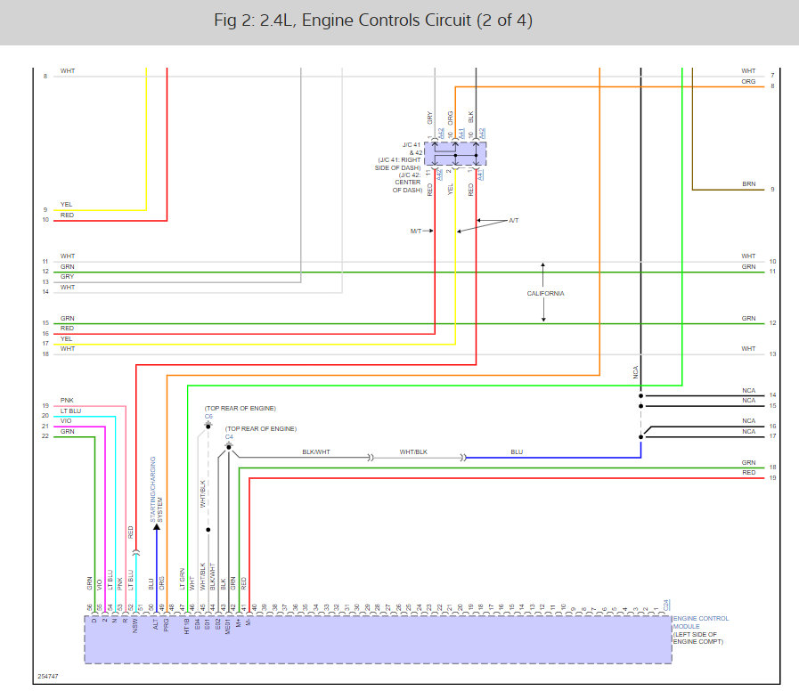

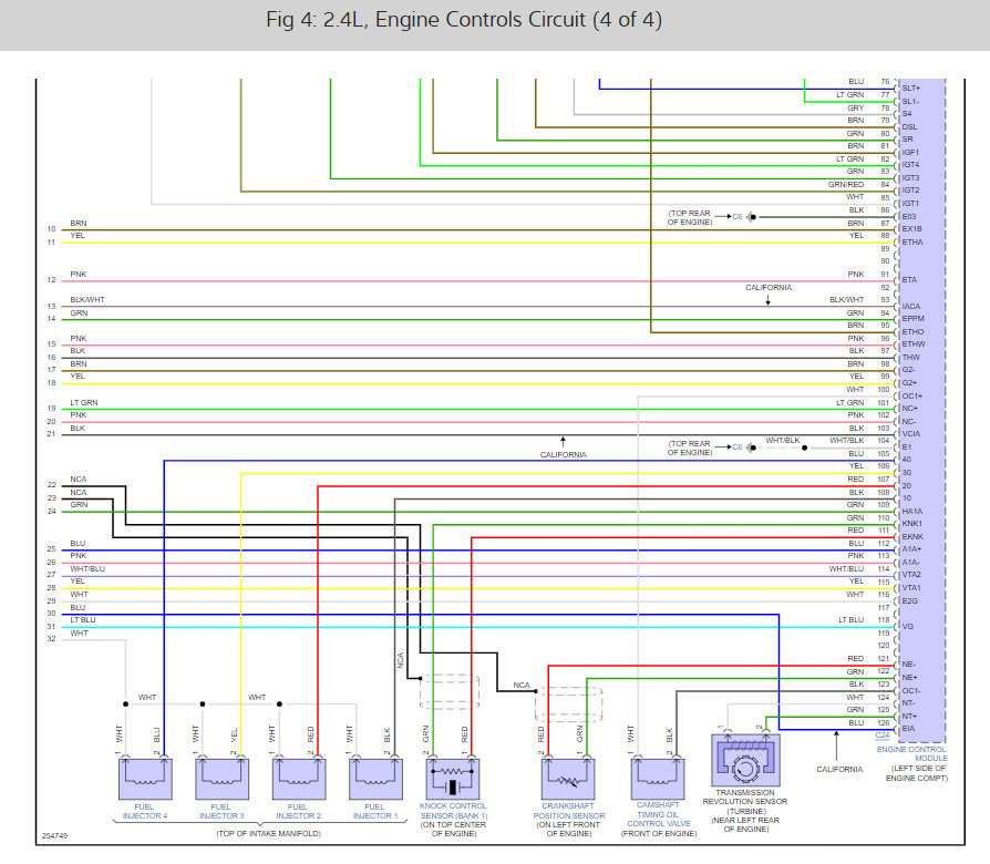

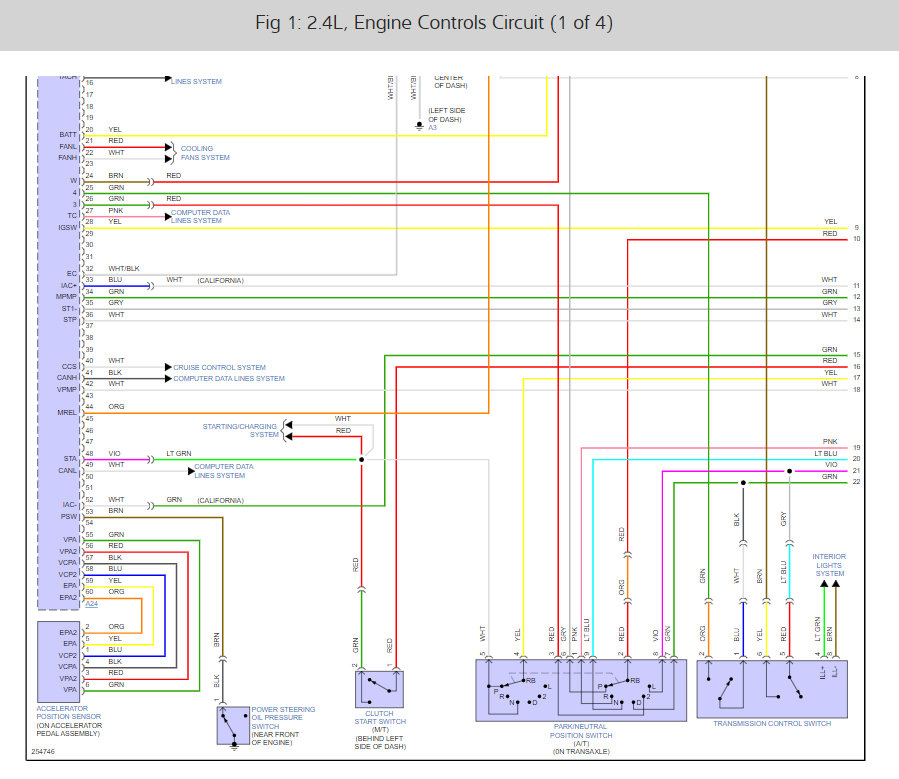

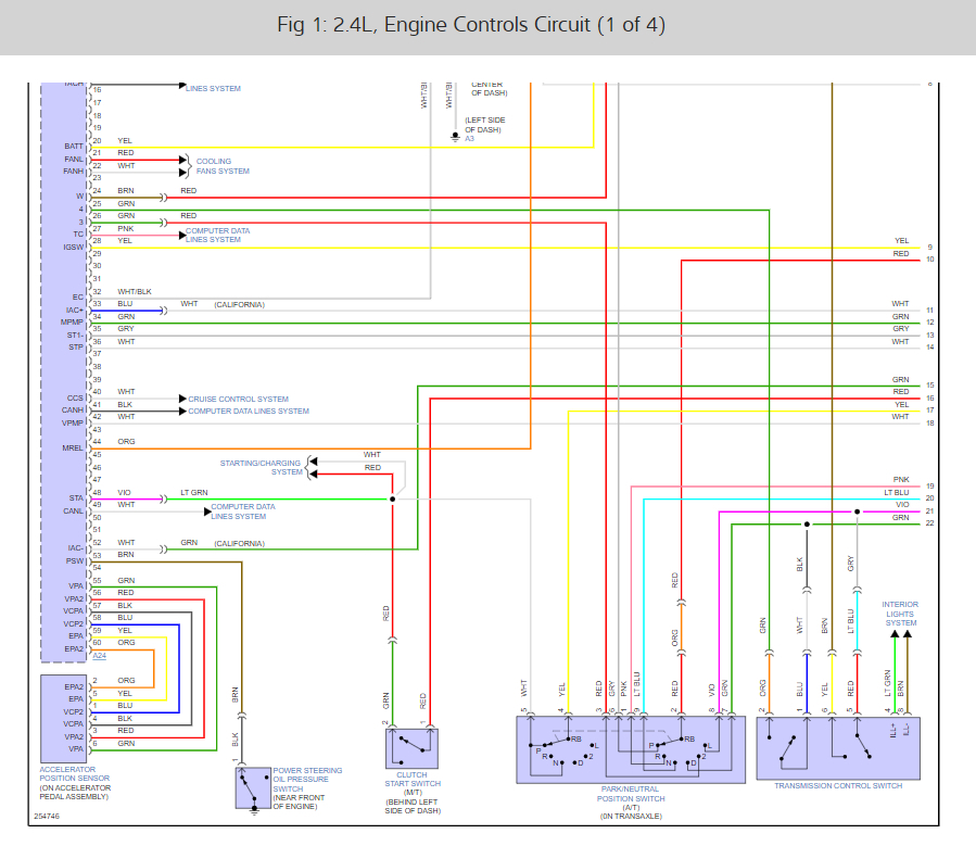

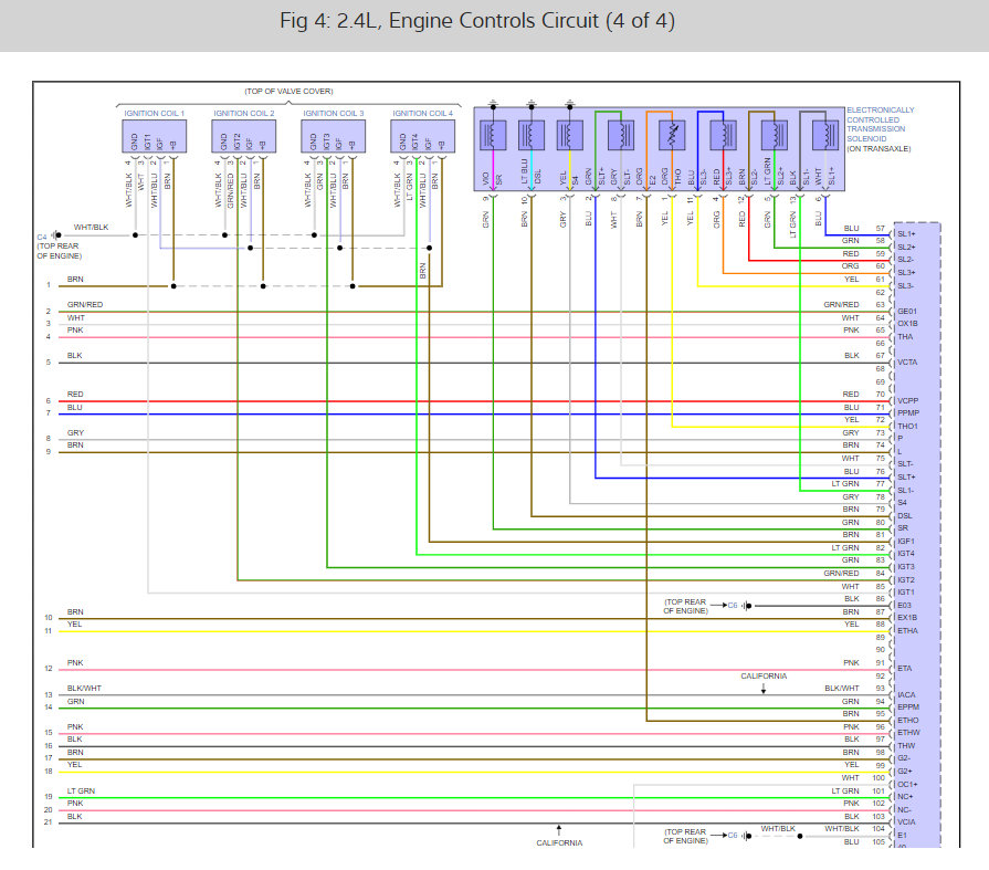

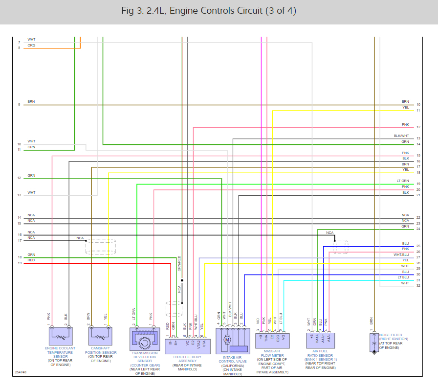

Are the ones I gave you blurry? please let me know. Here are the regular engine wiring diagrams for the non-hybrid engine car. Let me know if you need anything else.
