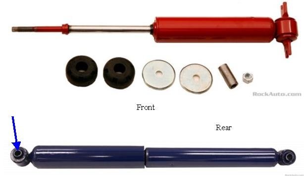

In addition, there's some things to be aware of to avoid some common do-it-yourselfer mistakes. When the top of the shock absorber mounts with a long threaded shaft like yours does, you slide on a metal washer, a rubber bushing, slide it through the frame, then slide on another bushing, washer, and the nut. Do not over-tighten that nut as it will lead to early bushing failure. The nut is supposed to be tightened just until the rubber bushings expand to exactly the same diameter as the metal washers. That leaves them room to flex freely. The top shock absorber in the photo is for a 2004 Ram 1500. This one shown includes a metal sleeve to prevent you from over-tightening the nut. Not all come with that sleeve. There was no V-6 engine used in the 2500s. These same shock absorbers are used in the 2500 with the V-8 engine. You might find different shock absorber part numbers for use with a diesel engine because there's a lot more weight to hold from bouncing.
When you have a stud welded or bolted to the frame, and the shock absorber has a round rubber bushing that slides onto it, there is almost always a lip on the stud that limits how much the bushing can be compressed. Those nuts are tightened fully. The washer will run up to that lip and won't let you over-tighten it. Your design is a little different, and is the lower one in the photo. This one has a metal sleeve pressed into the bushing. My nifty arrow is pointing to it. That also limits how much you can tighten the bushing, but there's one more critical factor with these. Once installed and the nuts are just run on by hand, you must lower the truck onto the tires, bounce it a few times, then tighten those nuts. That insures the bushings are not twisted when the truck is sitting at normal ride height. Too many people tighten those nuts when the truck is jacked up with the suspension hanging down, then, when they lower it onto the tires and the suspension settles, those bushings are clamped in a permanent twist. As they twist further, back and forth as the truck bounces, they will be over-stressed one of those ways, leading to them tearing apart and early failure. We see a lot of these failures when it's due to the hardware and not the shock absorber itself. Settling the suspension before tightening the bushings applies to all other suspension parts with these captive bushings. Mainly that includes control arms Parts that are free to rotate after installation, such as anti-sway bars, can have their bushings tightened while the vehicle is raised up and those parts are hanging down. Those bushings don't twist back and forth while driving.
