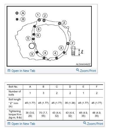

The torque converter nuts go to 38 ft lbs
See the diagram below for sequence and torque spec of the bell housing bolts

Thanks I got it snugg all the way around. You wouldn't know were I can find an engine harness diagram I didn't think to tag it cause so much at once for me.
