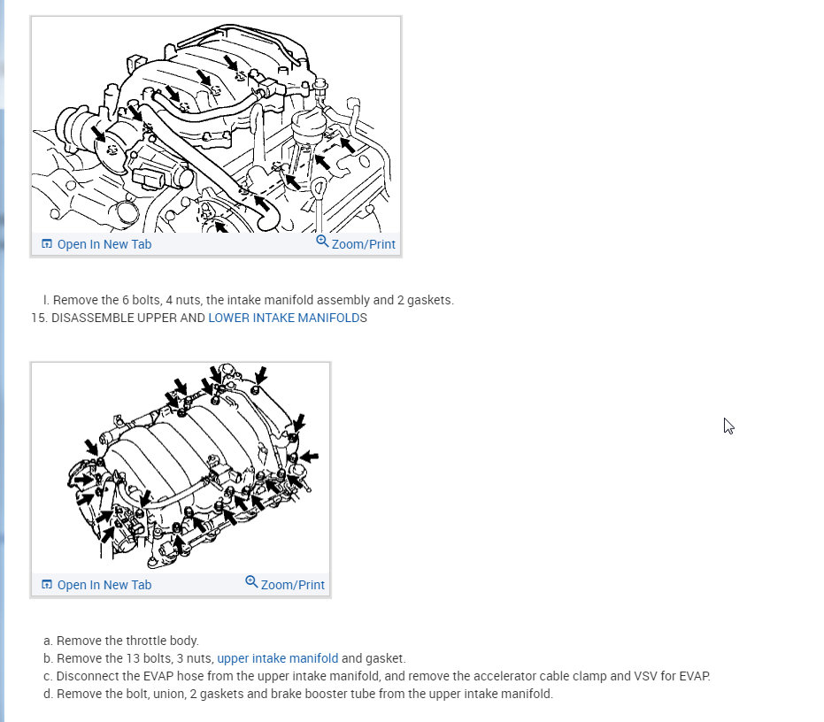

So this will be my first time doing a head gasket and need good easy to follow detailed head gasket replacement instructions on how to do this properly. also any tips or pointers to make it any easier would be appreciated. thanks
Aug 5, 2020 at 8:54 AM

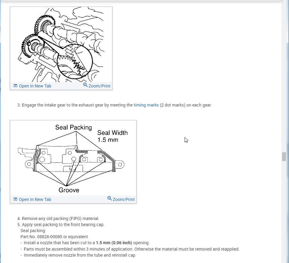

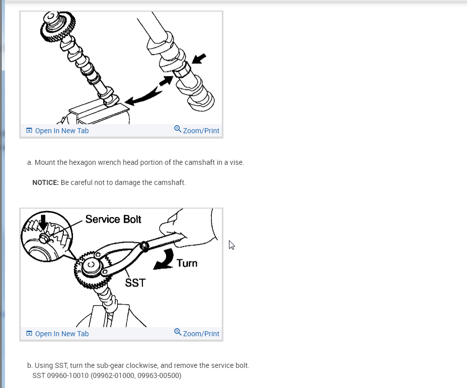

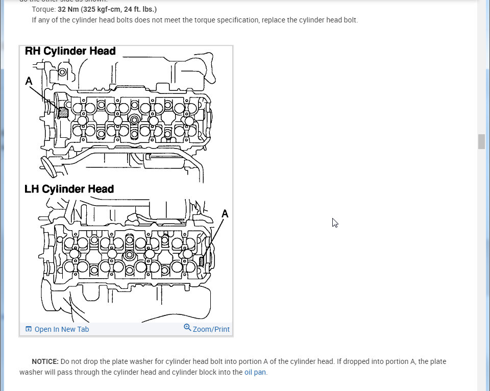

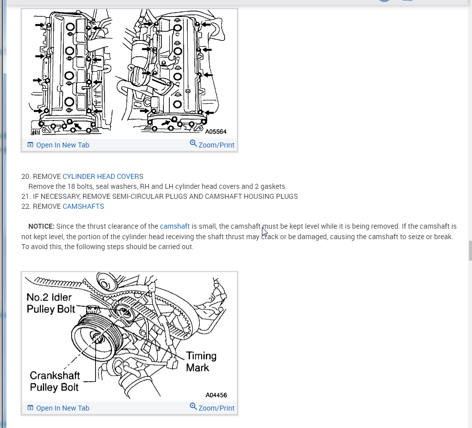

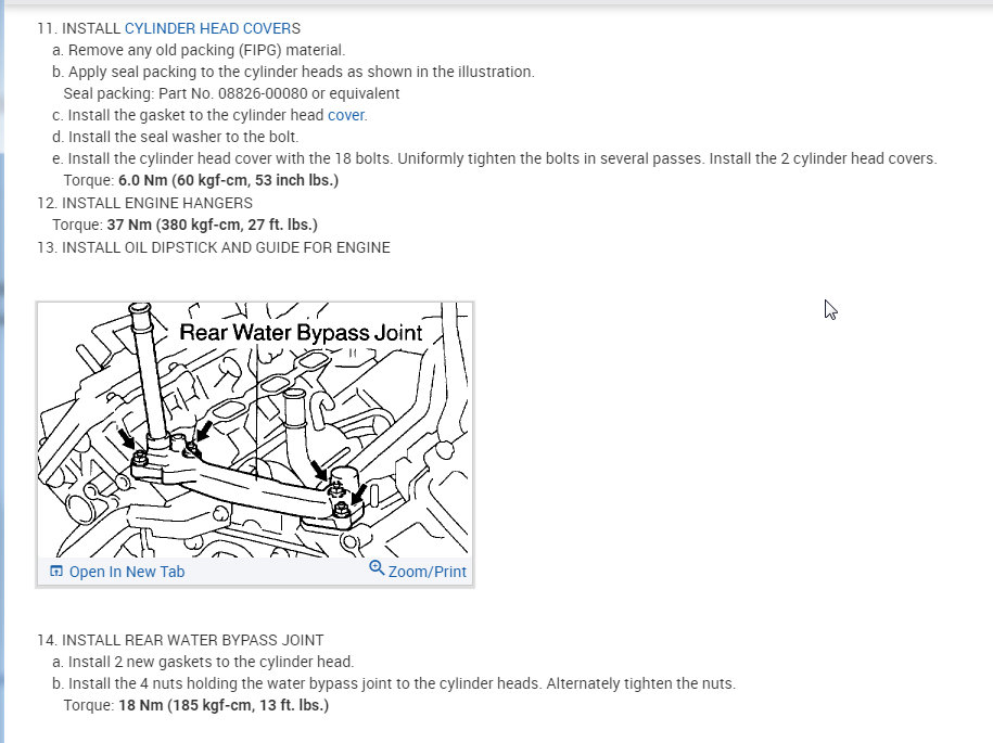

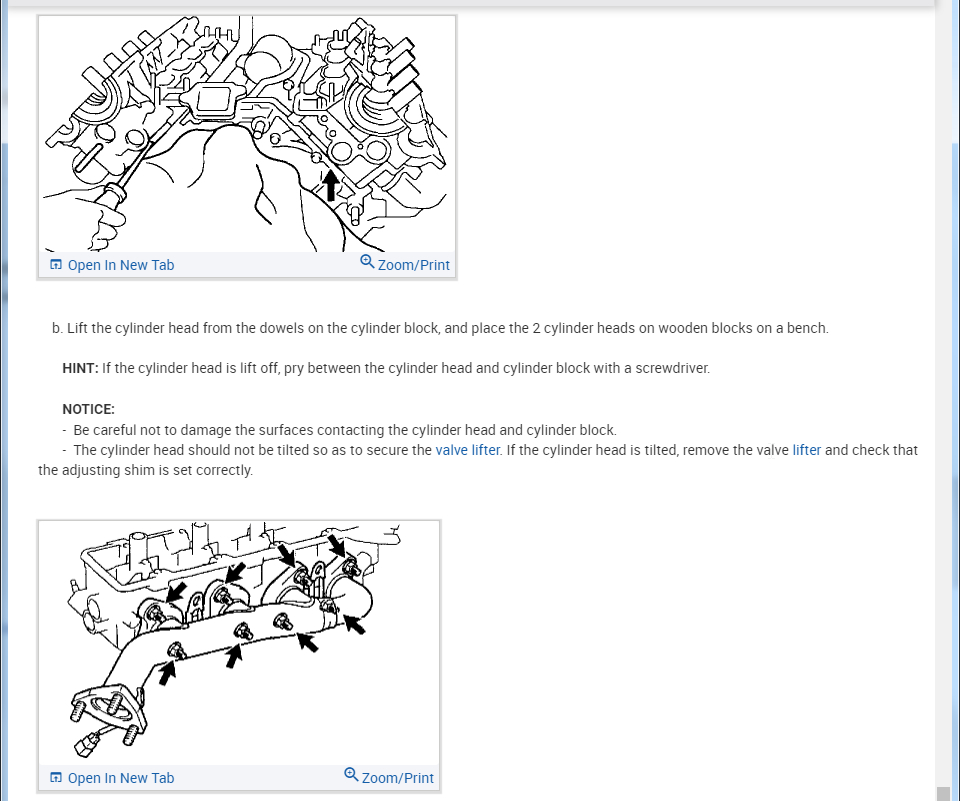

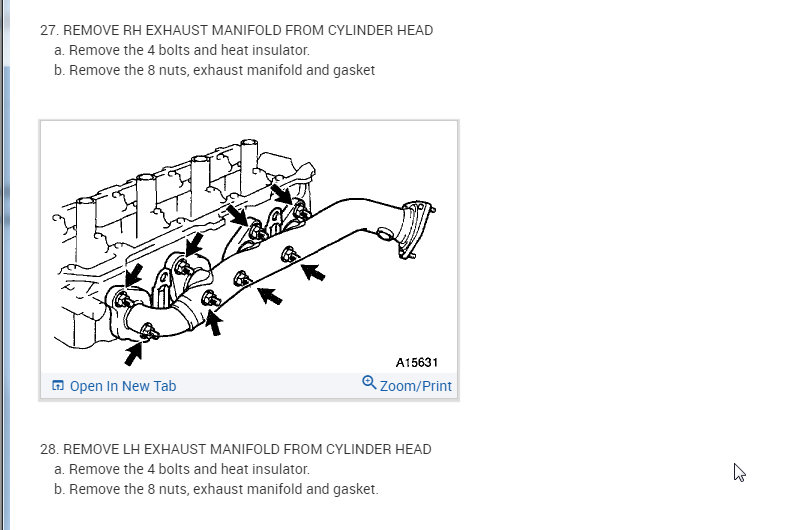

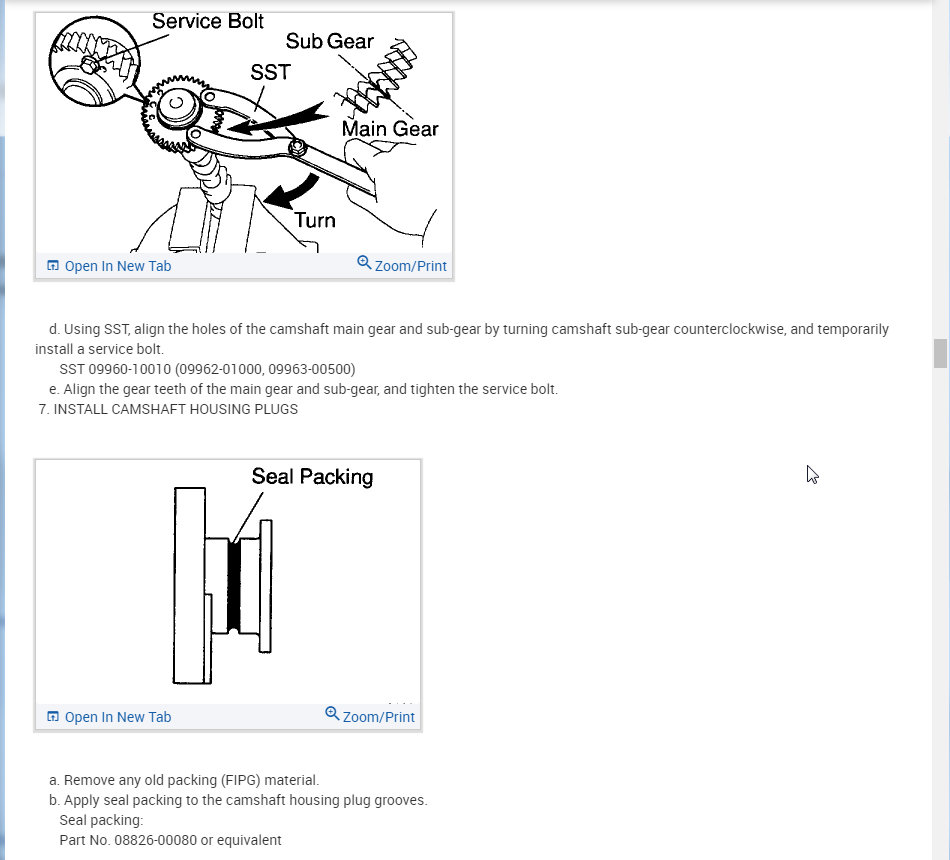

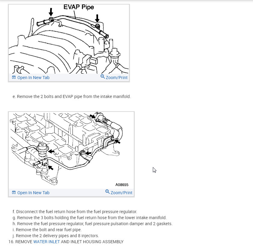

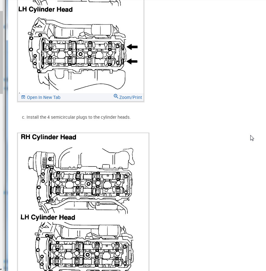

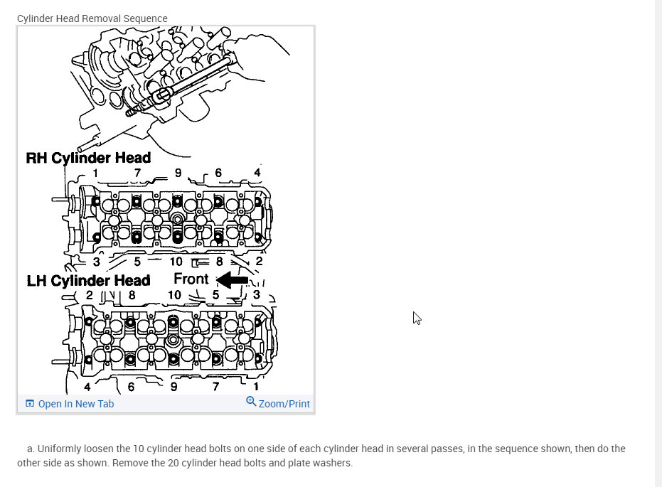

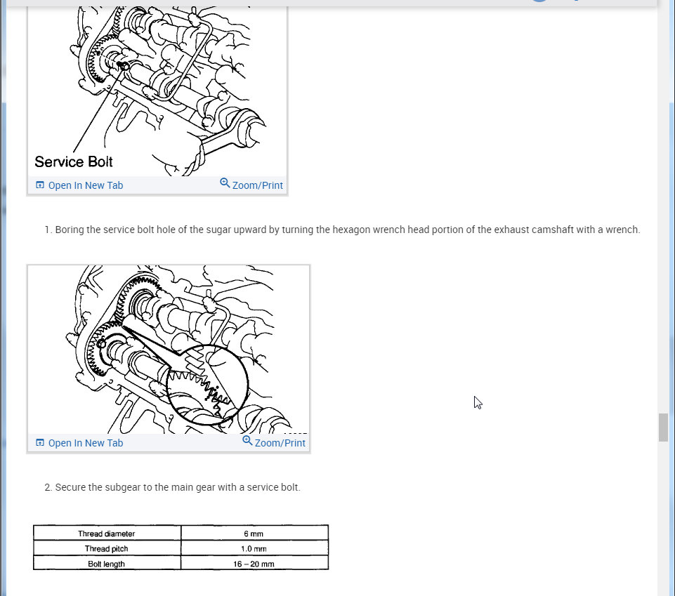

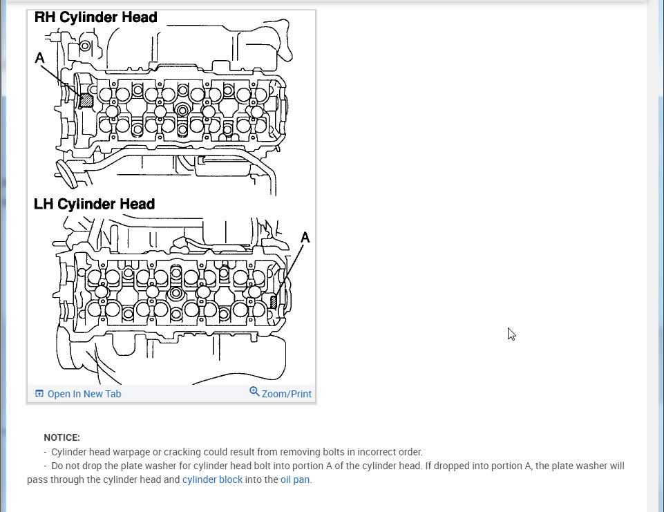

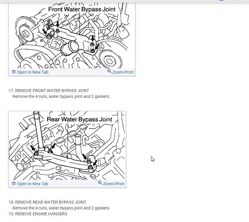

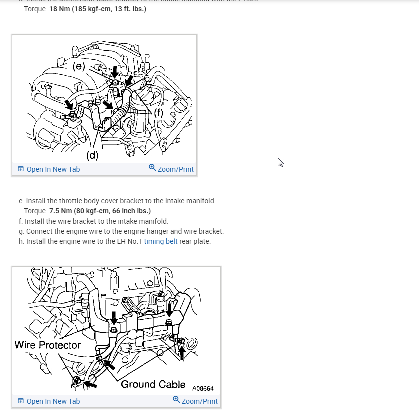

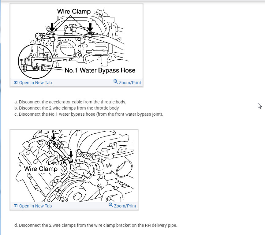

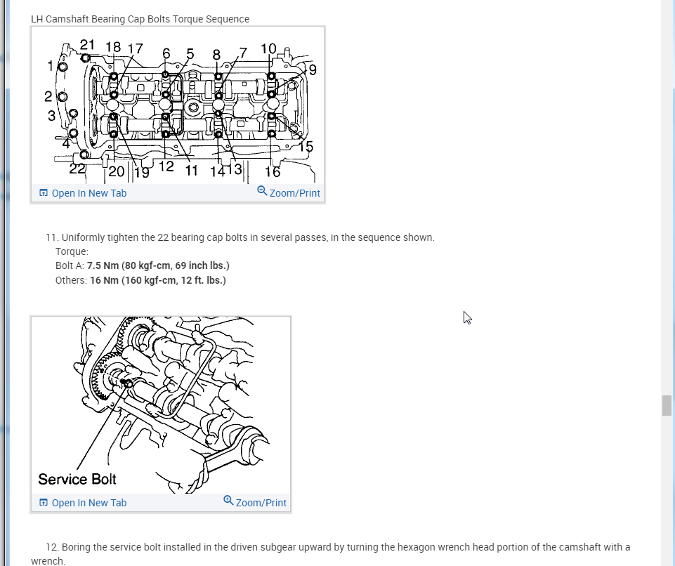

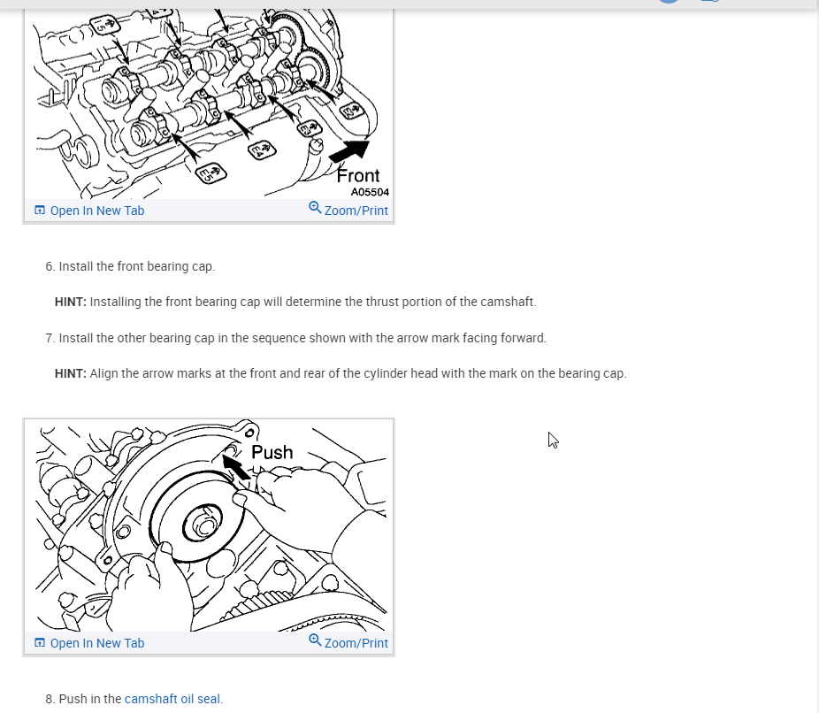

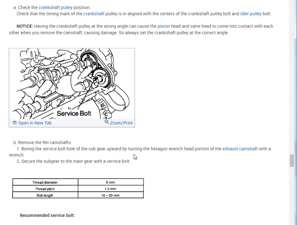

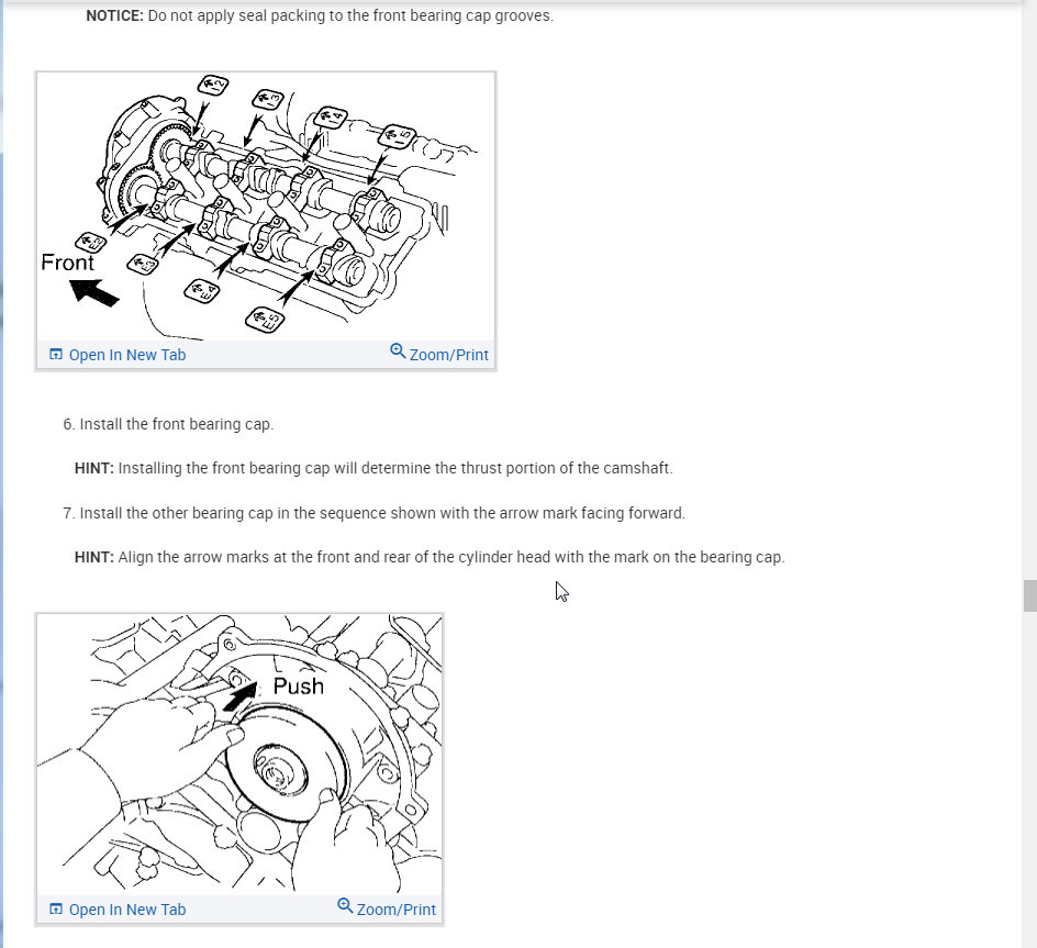

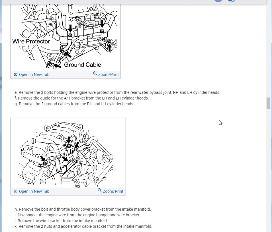

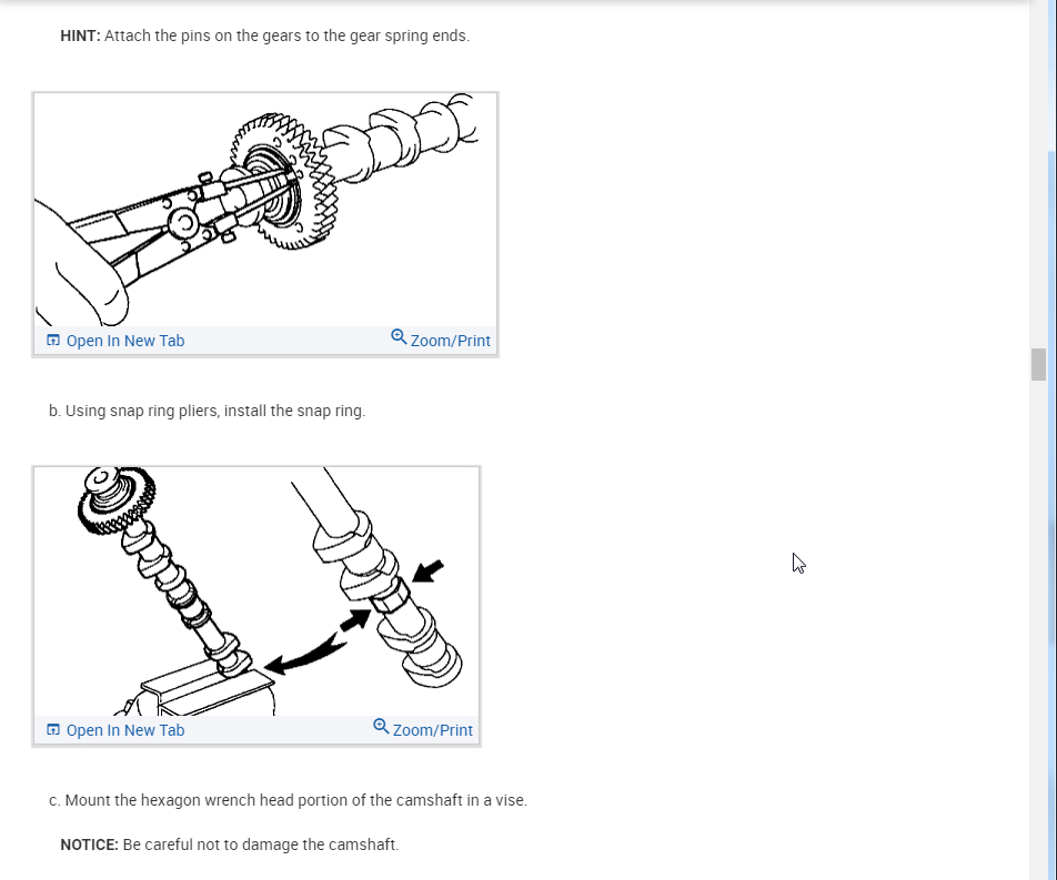

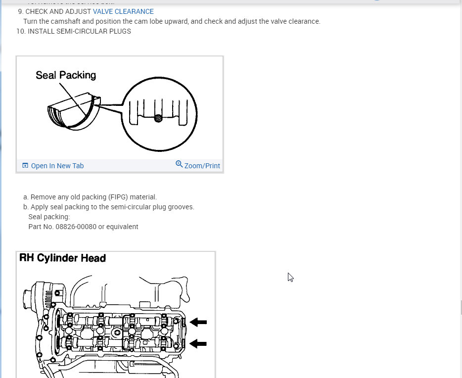

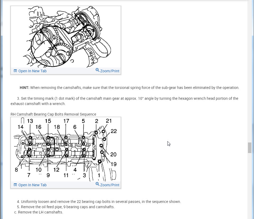

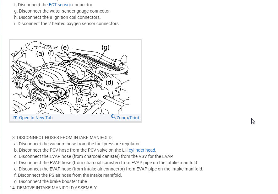

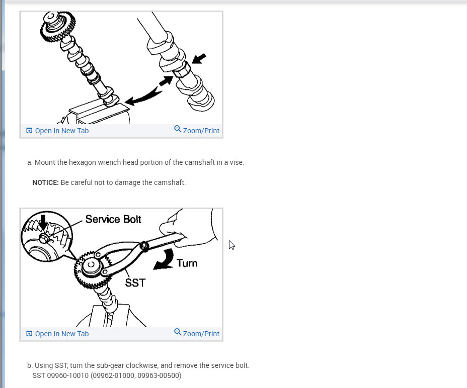

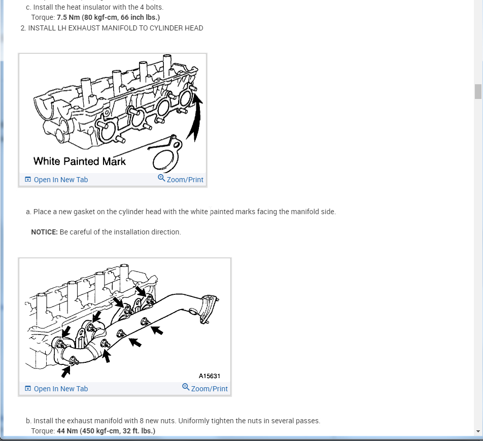

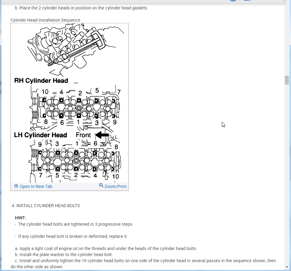

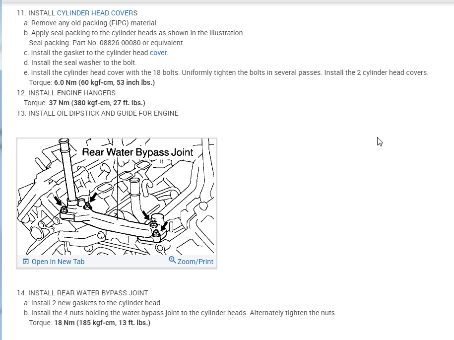

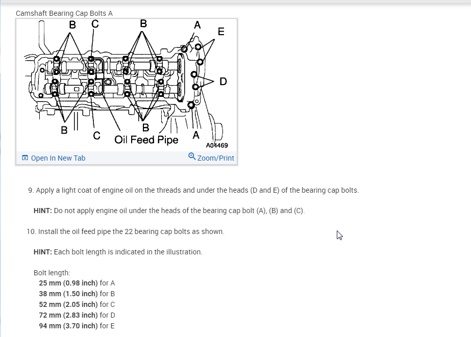

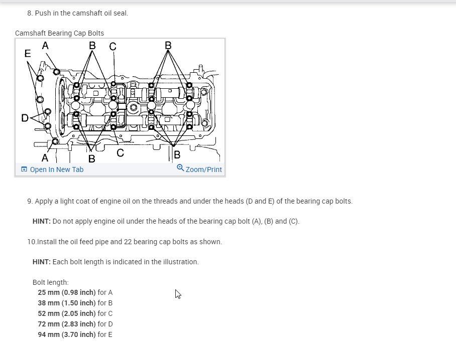

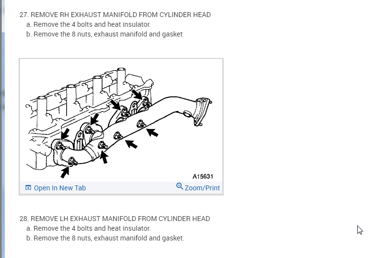

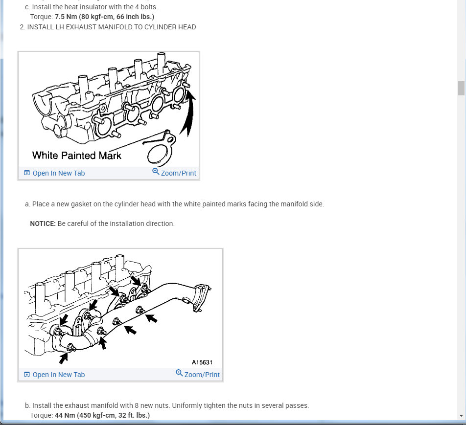

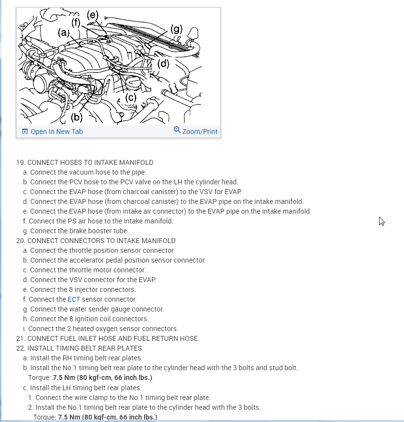

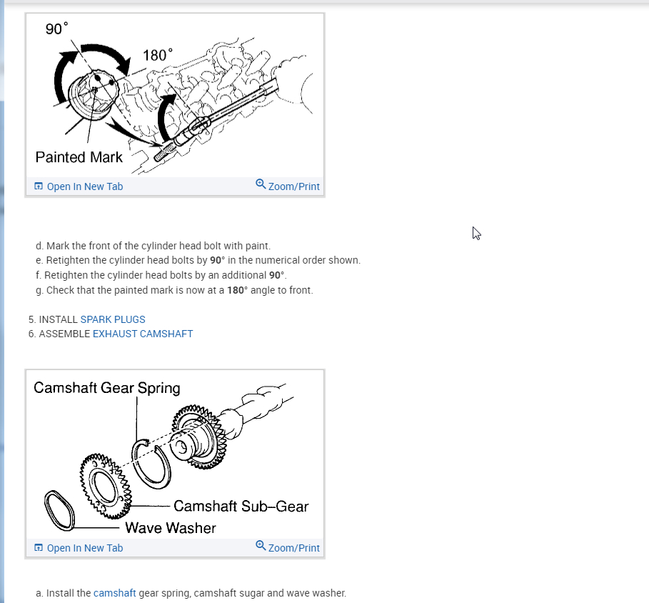

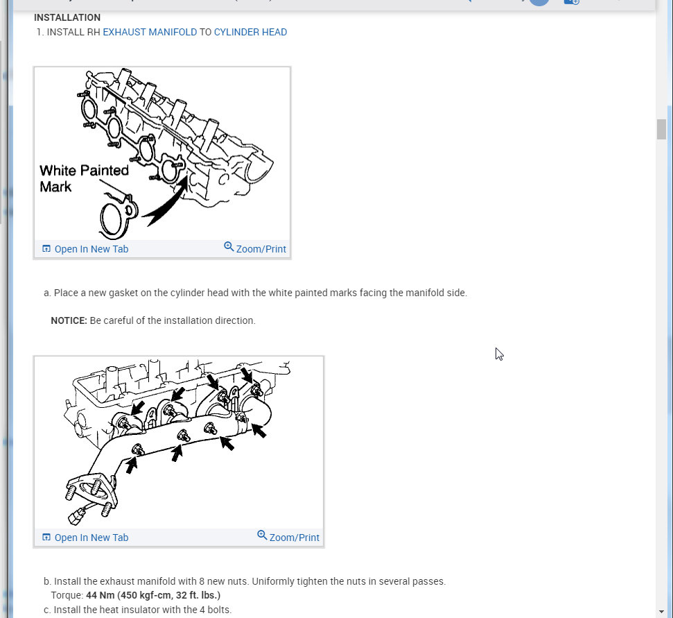

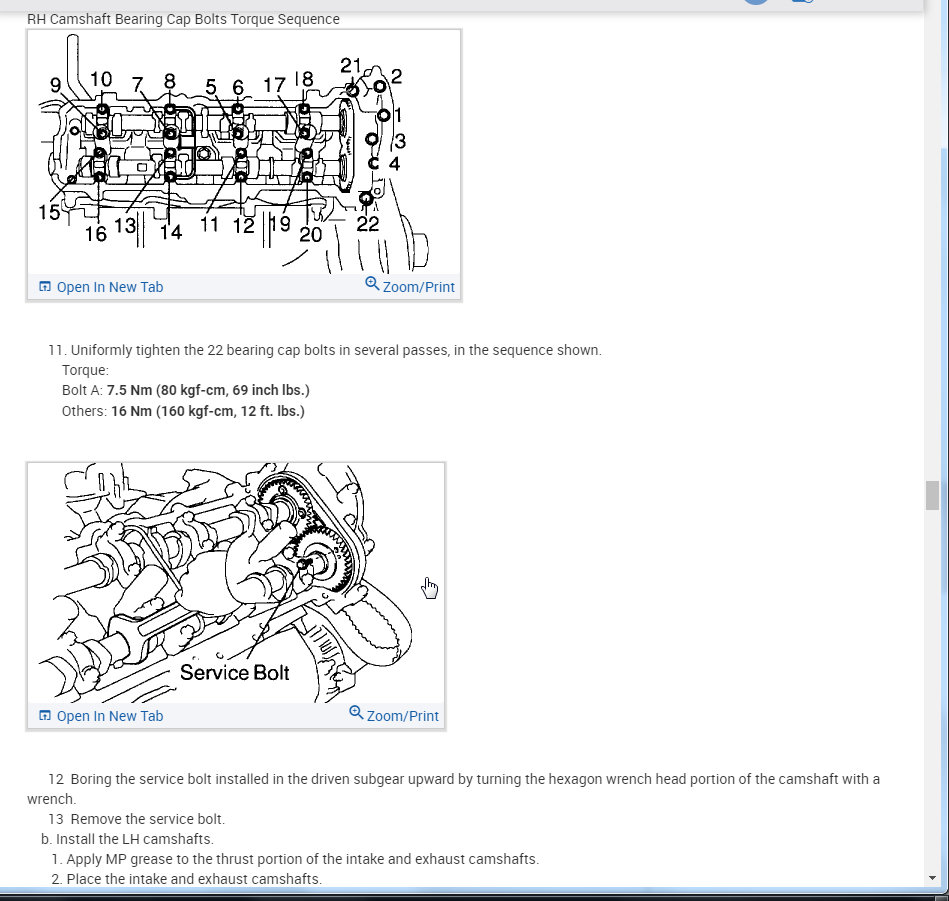

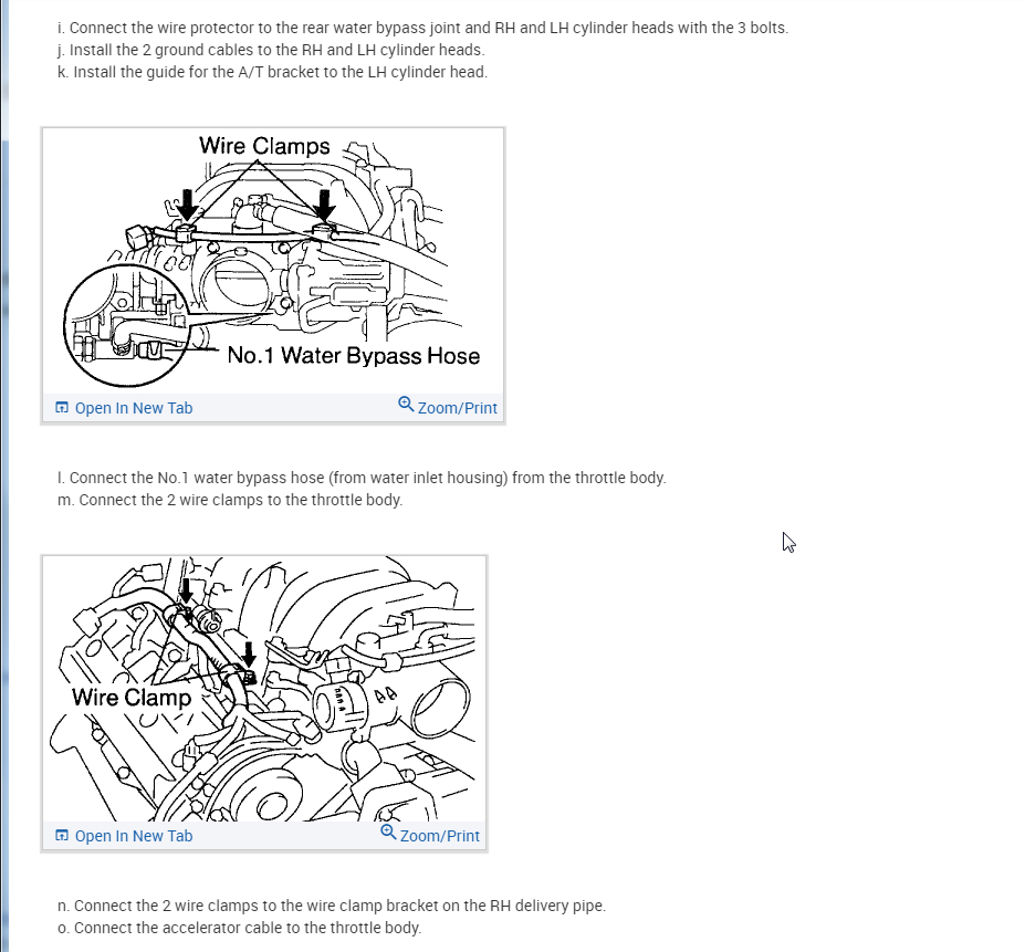

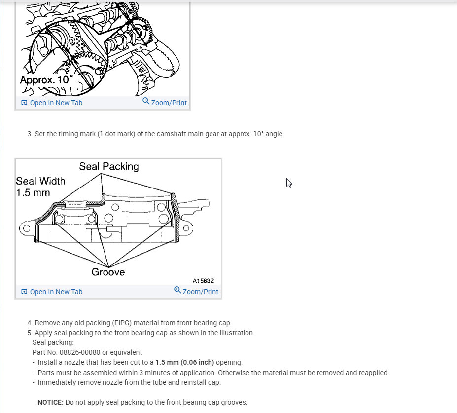

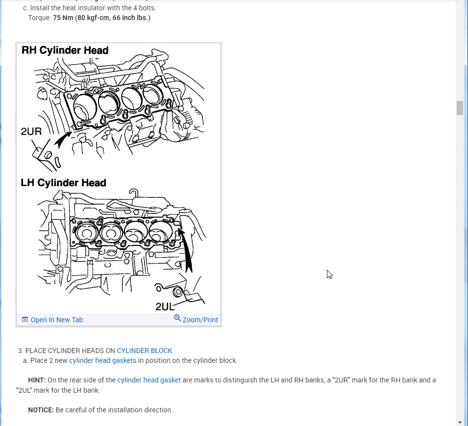

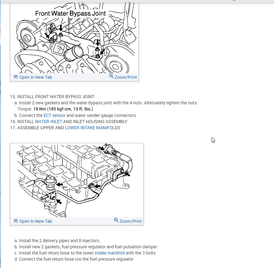

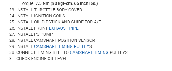

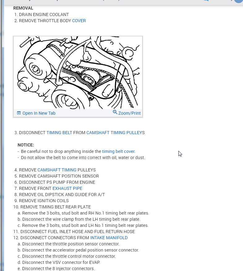

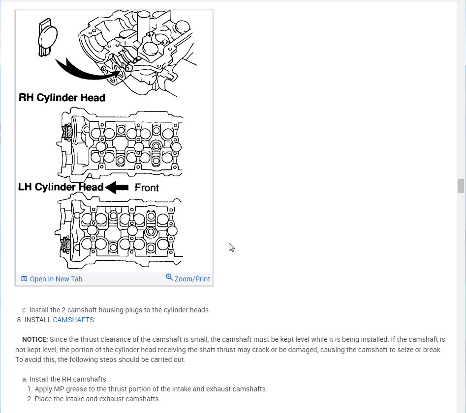

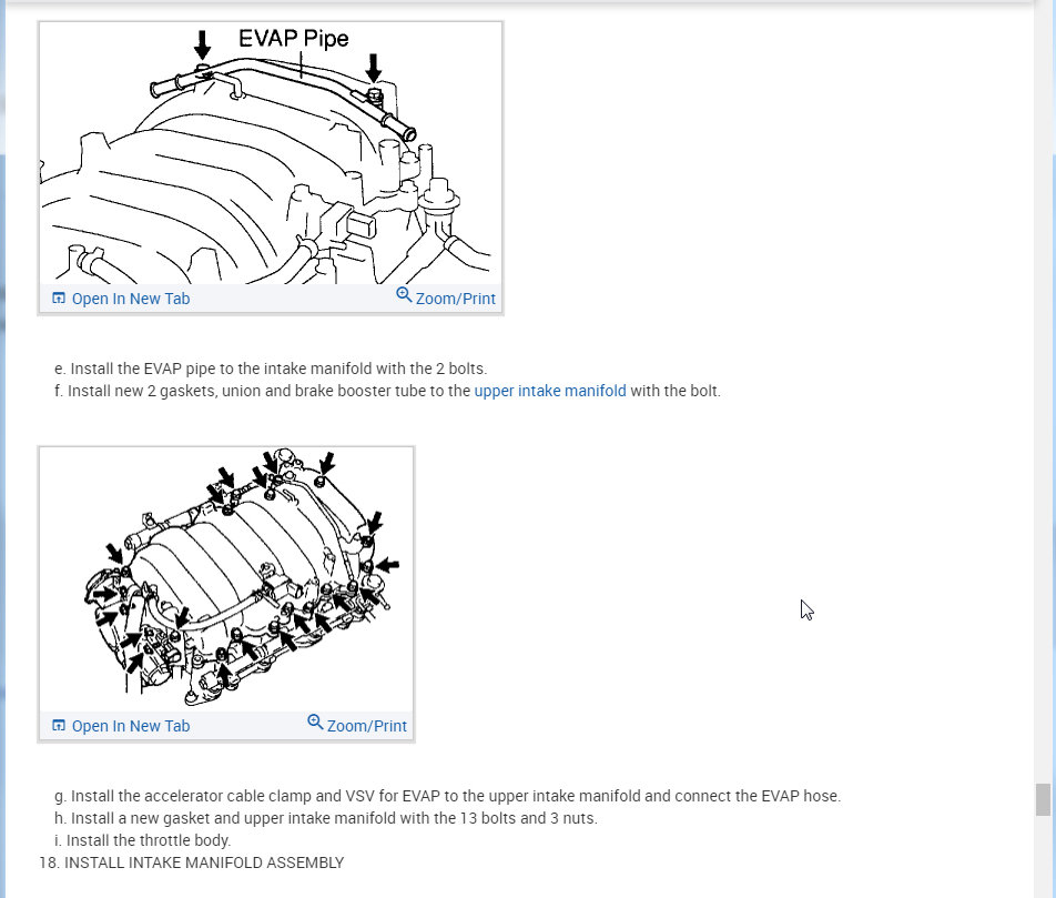

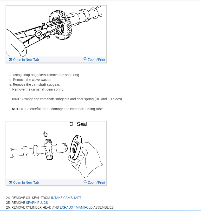

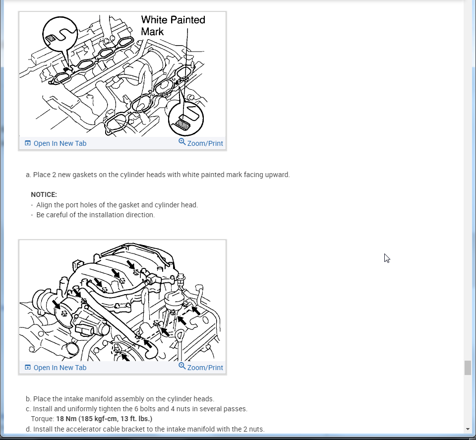

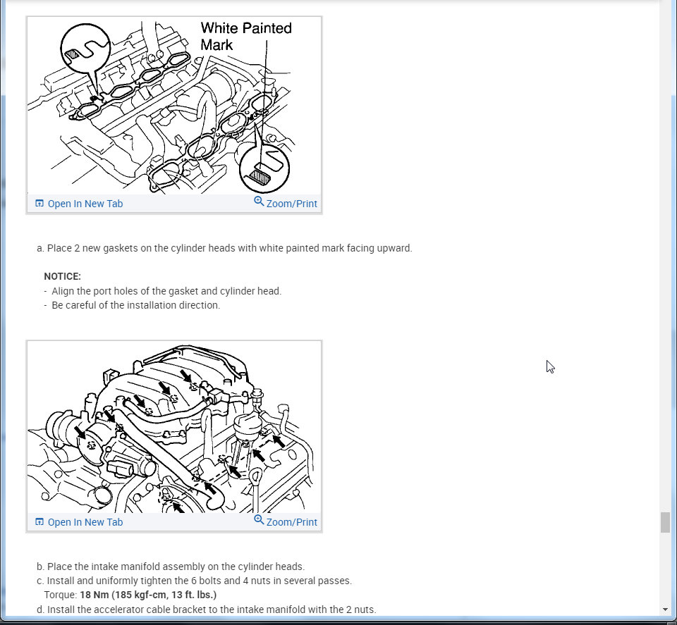

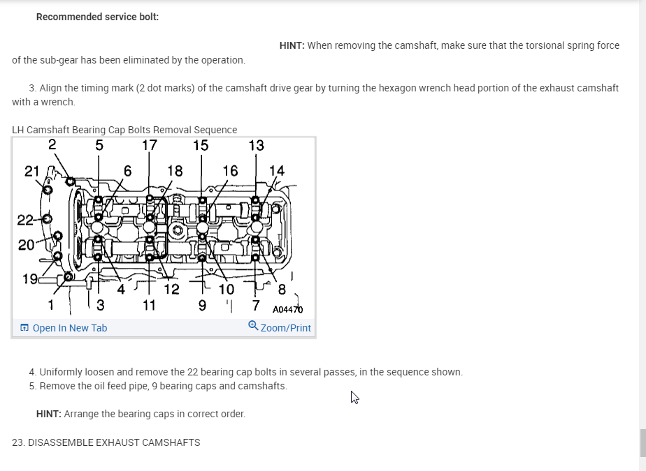

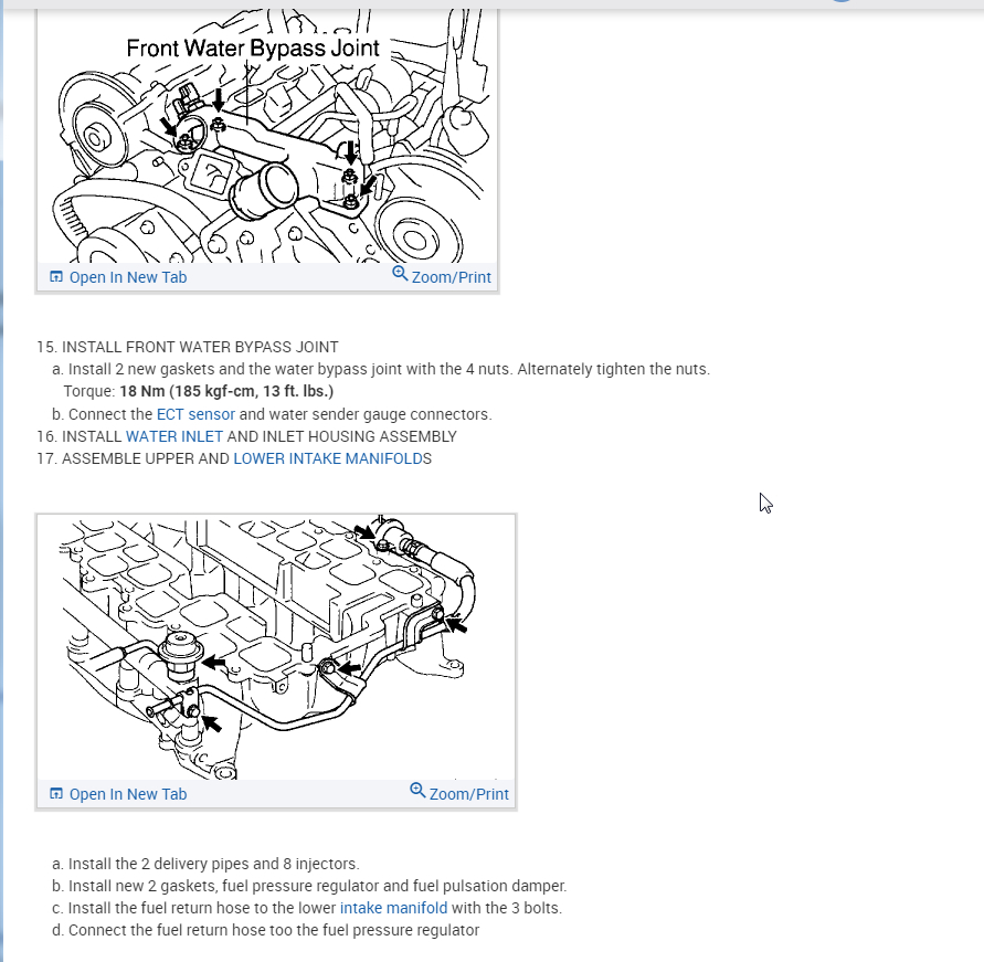

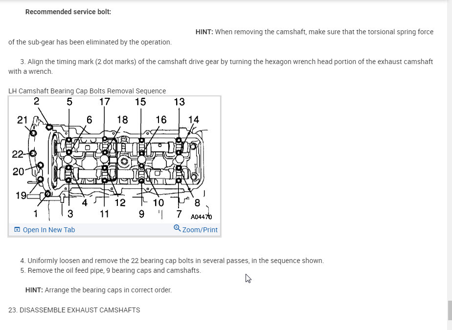

I attached very lengthy instructions on how to do this for the 4.7L because this is not a easy job. These are pretty detailed so I doubt you will need much more.
Let us know how you make out. Thanks.
