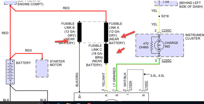

Not charging did check on alternator alternator is good check the wiring to the alternator all voters are good except black and white wire in the middle stator it has a low voltage I need a wiring diagram of the electrical system

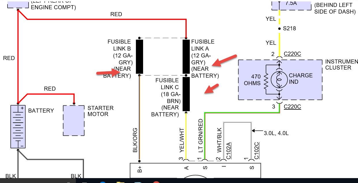

see pic and check fusible links as well as belt and tensioner both should be replaced at 60,000
