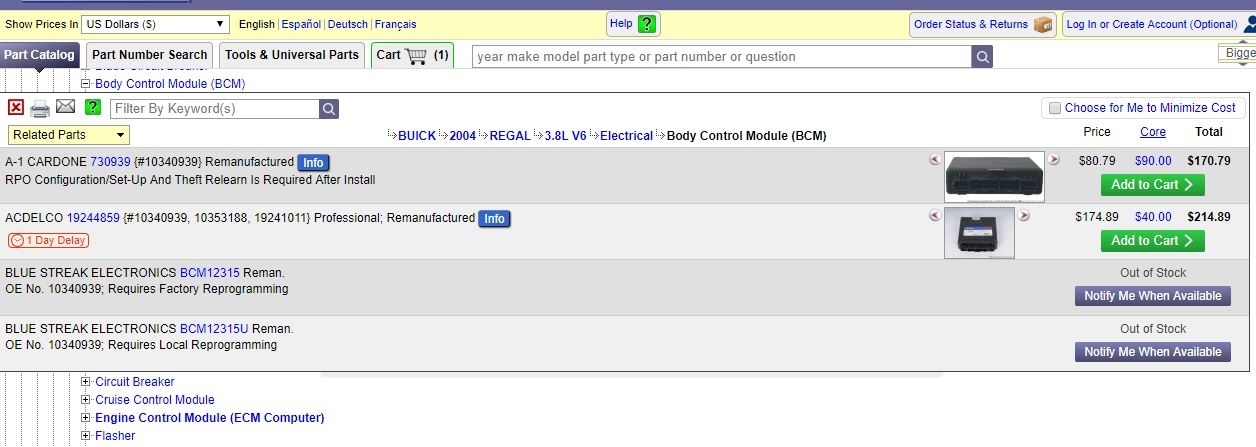

Good evening,
The labor is one hour. That is about $100.00.
The programming is $125.00
The part is $175.00. .....................................................

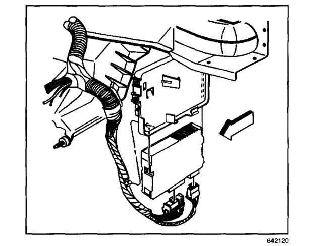

I attached the replacement instructions for the BCM. It must be programmed with a scan tool in order to work correctly.
BODY CONTROL MODULE REPLACEMENT
REMOVAL PROCEDURE
1. Disconnect the negative battery cable.
2. Remove the left instrument panel insulator.
3. Disconnect the BCM electrical connectors.
4. Push the BCM up and move the bottom of the BCM away from and out of the mounting bracket slot in order to remove the BCM.

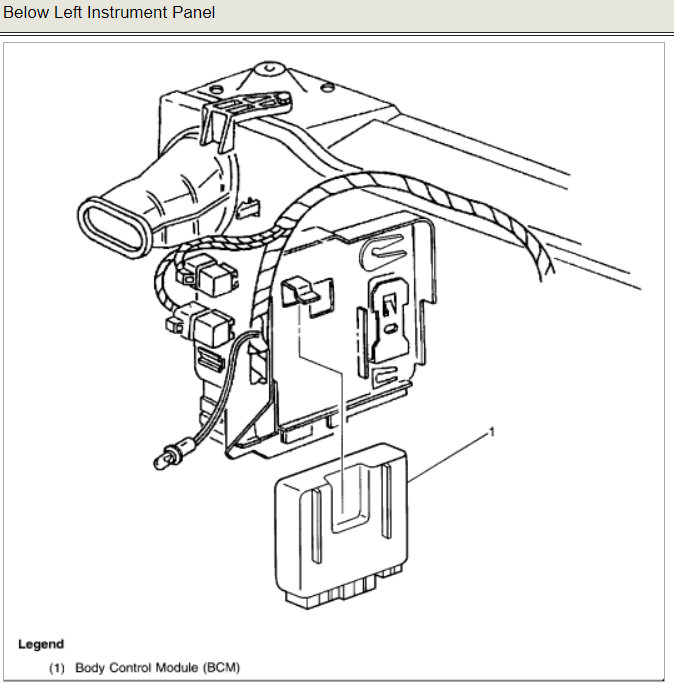

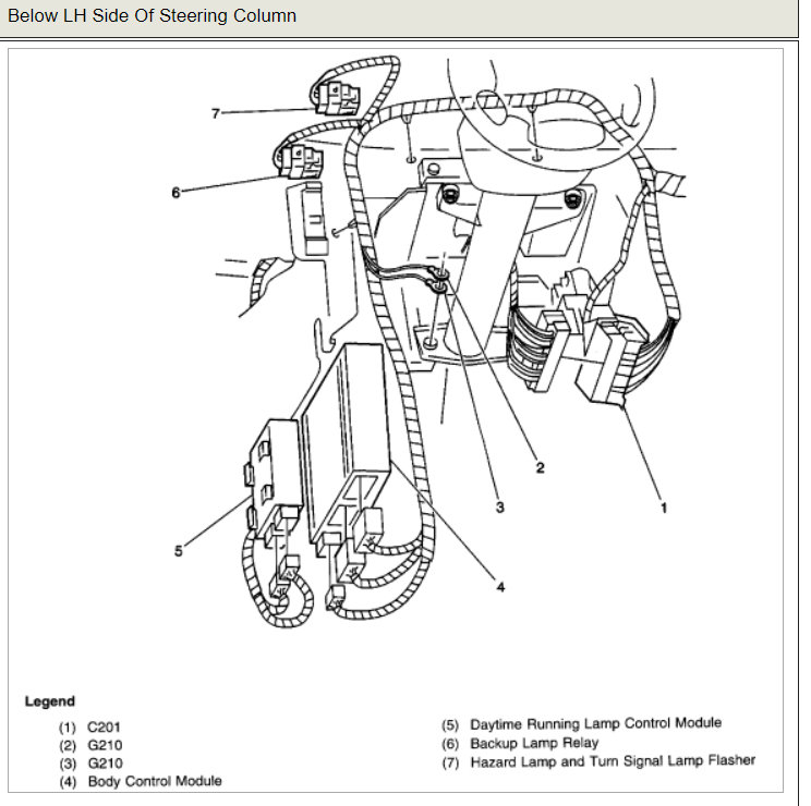

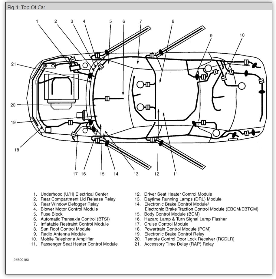

Where is the body control module located?
Nov 27, 2020 at 3:56 PM (Merged)
It looks like the BCM Body Control Module is located behind left side of dash, left of steering column. See the image below: #15. I would try a used one.
Please let me know if you need anything else to get the problem fixed. look at the diagrams *BELOW)
