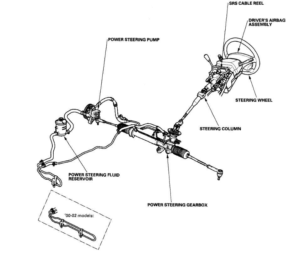

I am sorry to hear about your troubles, I will try to help. If you could upload a short video of the van making the noise that would make it easier for us. Also, it could have been damaged by the thieves or the tow truck driver, there is no way to tell until the van gets on a lift for inspection. We need to see the damage or the noise to have an idea of what's wrong, it sounds like the rack and pinion may have gotten damaged. Here is the power steering system so you can see how it works and what to look for under the hood. Please use a flashlight and look for anything out of the ordinary. Check out the images (below). Please let us know what happens.
