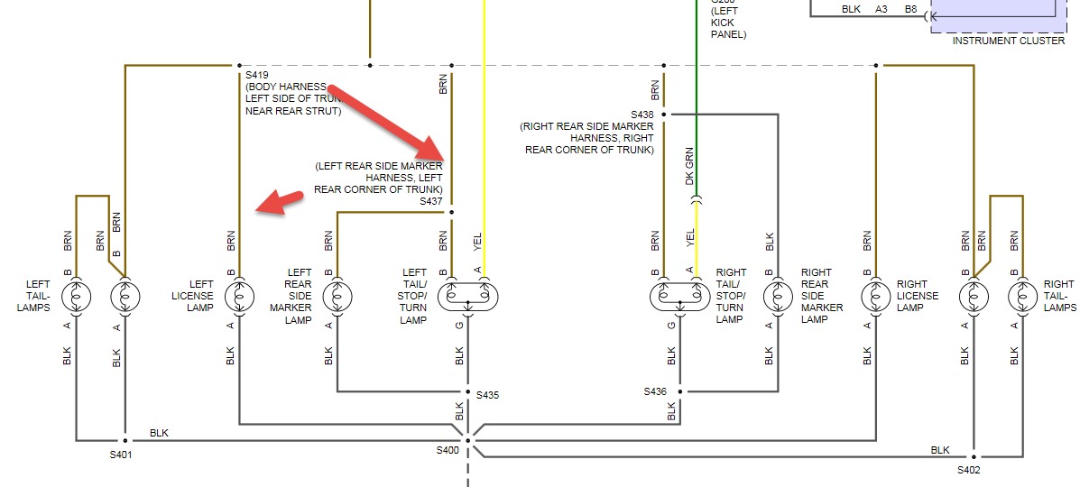

Hello, have a 1999 buick lesabre with the taillights not working while in park or driving. Brake lights and turn signal lights work. Changed bulbs and fuses. Need a picture of taillight wiring diagram. Thanks,

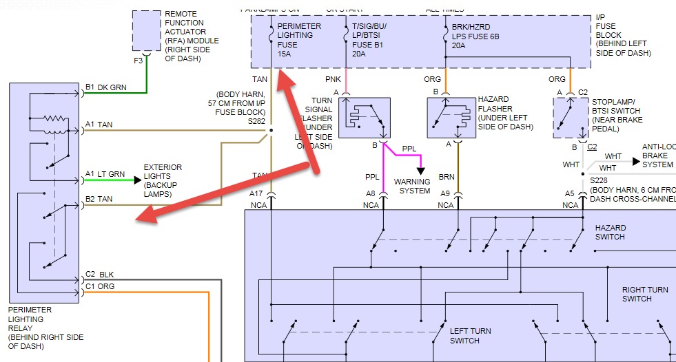

first check fuse in dash and relay then check brown wire in back if no power have it scanned as it may be a lighting module bad. Check out the diagrams (Below). Please let us know if you need anything else to get the problem fixed.
