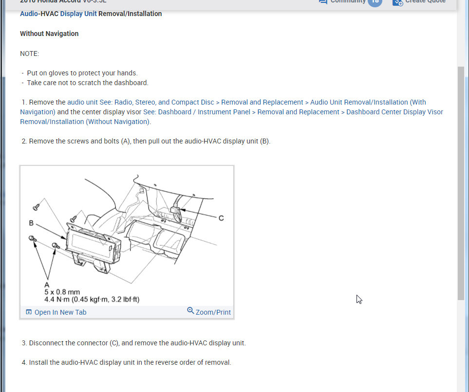

Unfortunately this message is indicating an internal error. The fact that the dust is in there either indicates that the circuit board is burned up or someone put something inside of it.
Either way the most likely only correction is to replace the unit.
I attached the info below on how to replace this unit. Let us know what other info you need. Thanks
