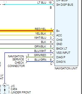

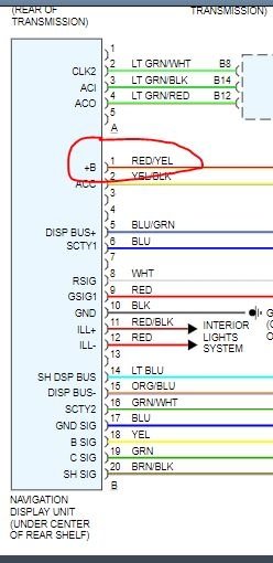

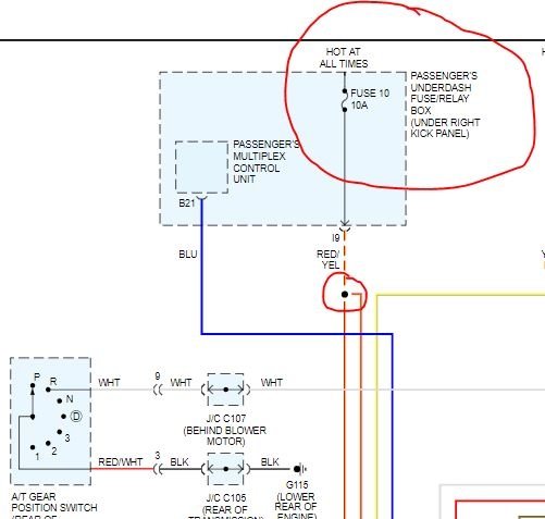

Just bought the car listed above Type S for $700.00. It runs great. Only problem, really, only one, is that the navigation screen doesn't come on. The temperature control below comes on, and the fans is set on high.I can't adjust the speed of the fan, as it looks like that is tied into the navigation, which doesn't come on.
Radio comes on as well. Just the navigation doesn't. Any advice? I thought I checked all the fuses, maybe I missed one.
Just checked the trunk, there is no 6 disc CD changer there. There is the spot for something, a metal bracket on the top of the trunk. I see 3 plugs there, but they aren't plugged into anything, as whatever is suppose to be there, isn't there.
