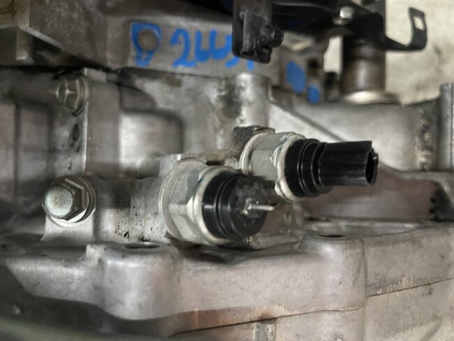

What is the name of this transmission sensor?
2013 HONDA ACCORD
180,000 MILES • V6 • 2WD • AUTOMATIC
BHAMDOC1973
  • 2,008 POSTS

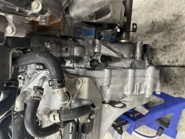

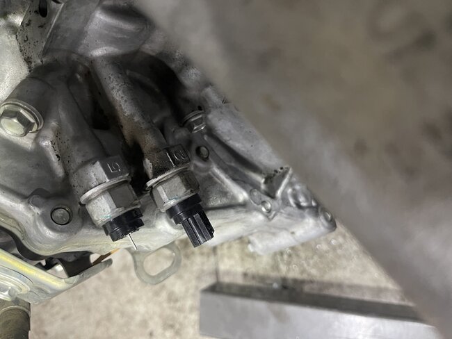

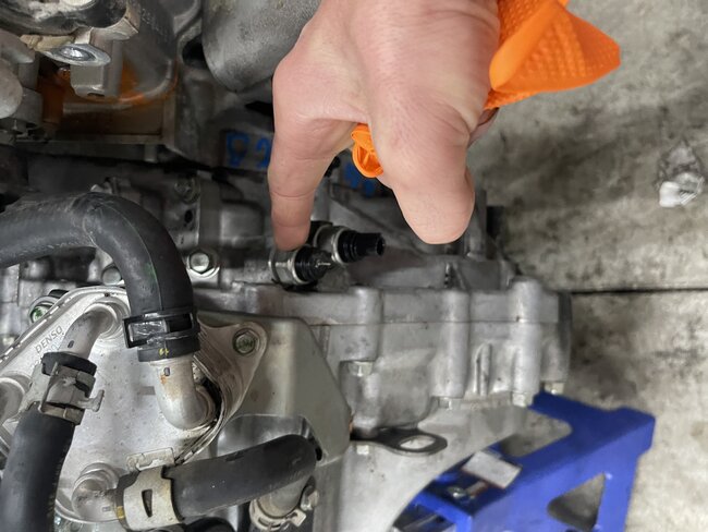

While putting together the engine and transmission i cracked the plastic part of the sensor. so, i don't want to take a chance on whether the connector would still hold with the female part, so i want to replace it. Do you have access to transmission diagrams and the name of this part? It's right by the oil cooler, top of the 2, and both have numbers on side not sure what they mean.
V6, 3.5l motor

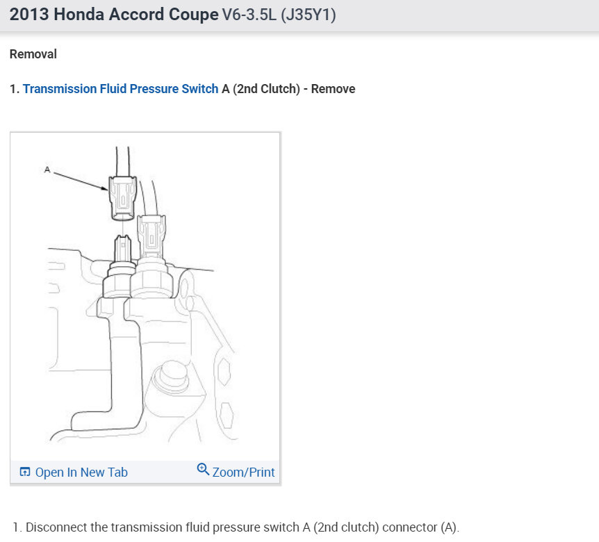

Yes, it looks like it's a fluid pressure switch A here is a diagram in the images below to help you see what it is called. Check out the images (below). Please let us know if you need anything else to get the problem fixed.

So, are they both pressure switches? Each clutch has one.
Mar 31, 2023 at 10:55 AM
Yes, it looks that way.
