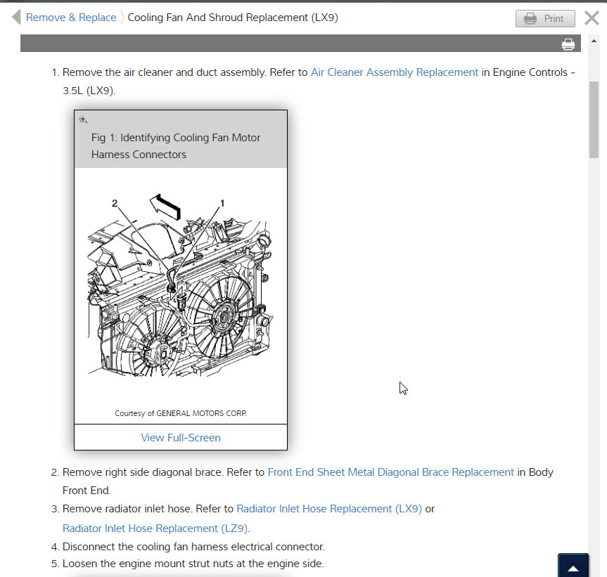

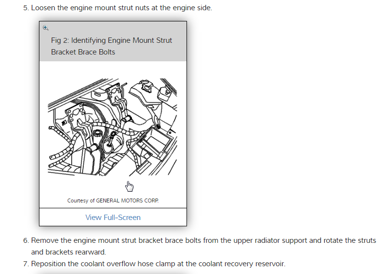

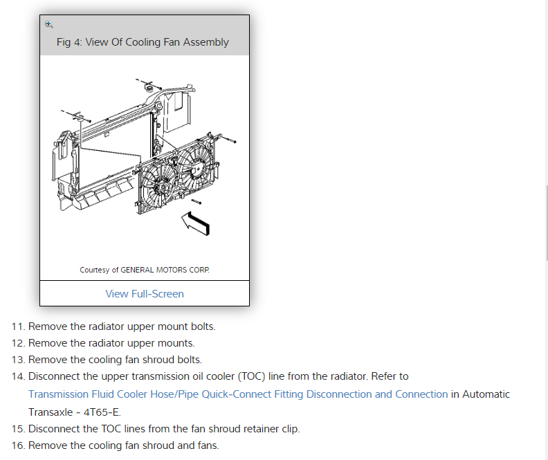

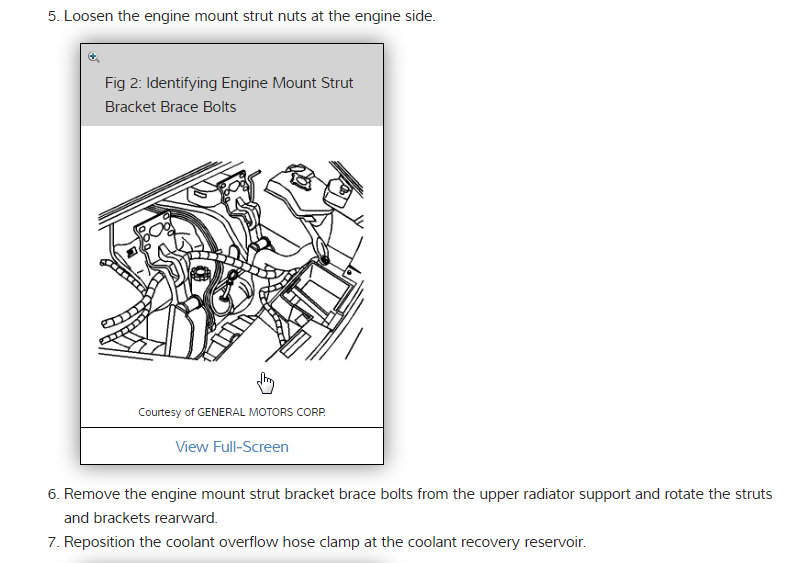

My van is leaking transmission fluid I believe from the cooler radiator. I need to Know how to get the fan off so I can get to it better.
Dec 7, 2019 at 12:03 AM
CERTIFIED EXPERT
18,907 POSTS

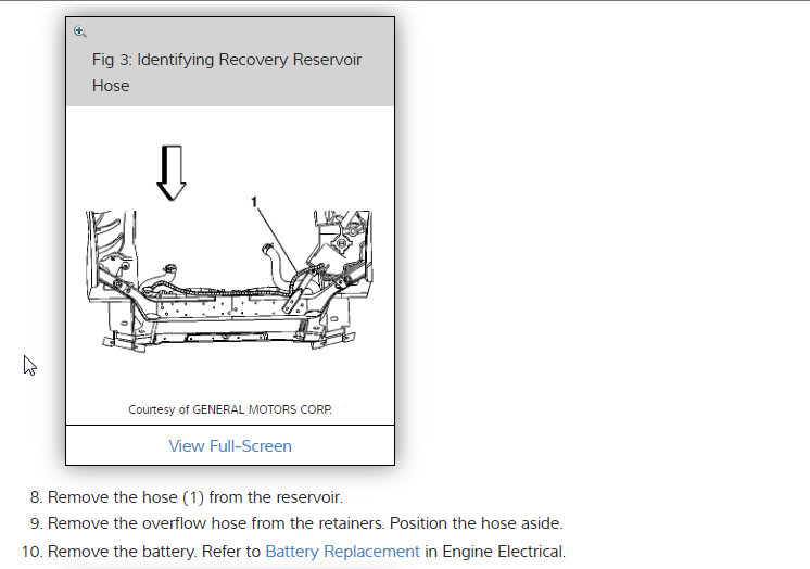

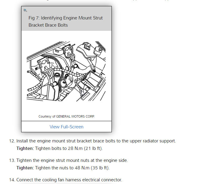

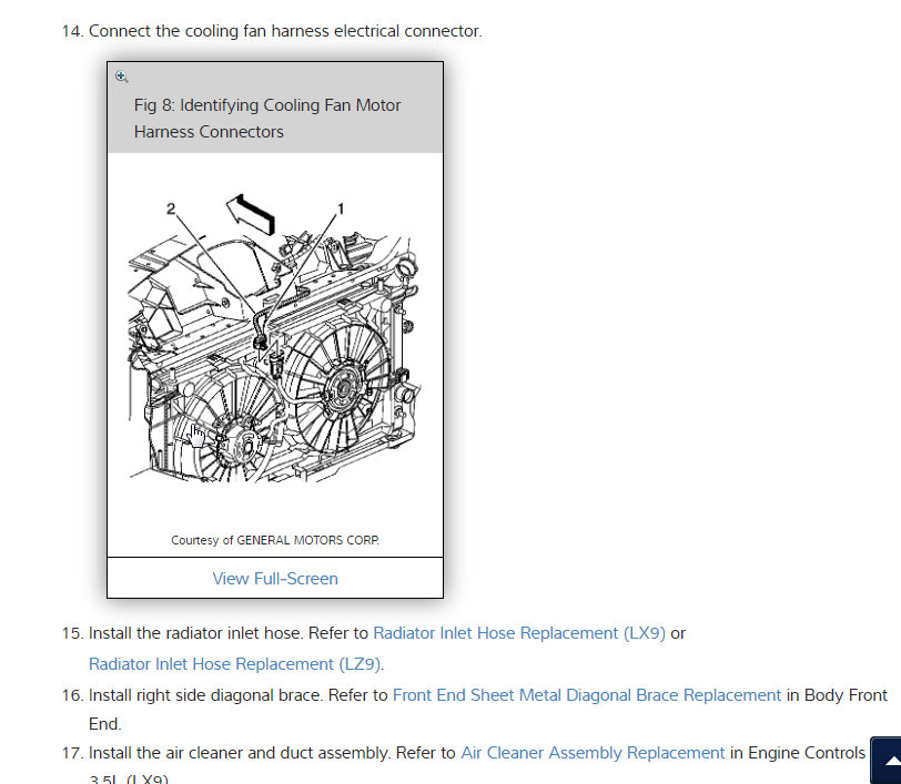

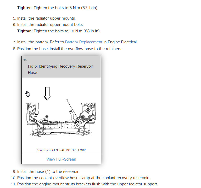

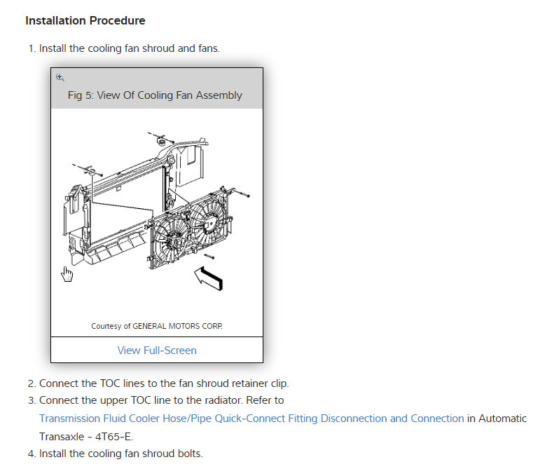

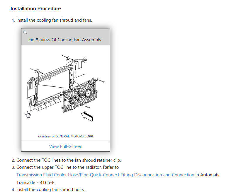

I attached the process for removing the fans. Let me know if you have any other questions. Check out the diagrams (Below). Please let us know if you need anything else to get the problem fixed. Thanks
