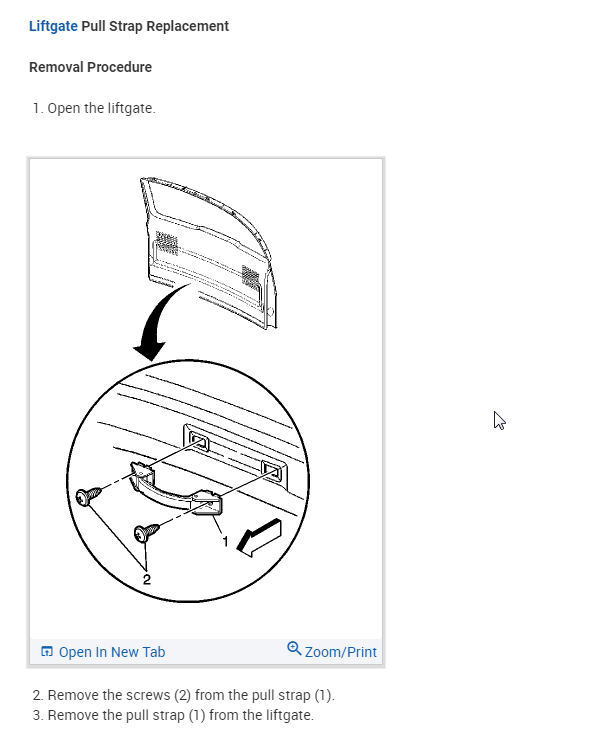

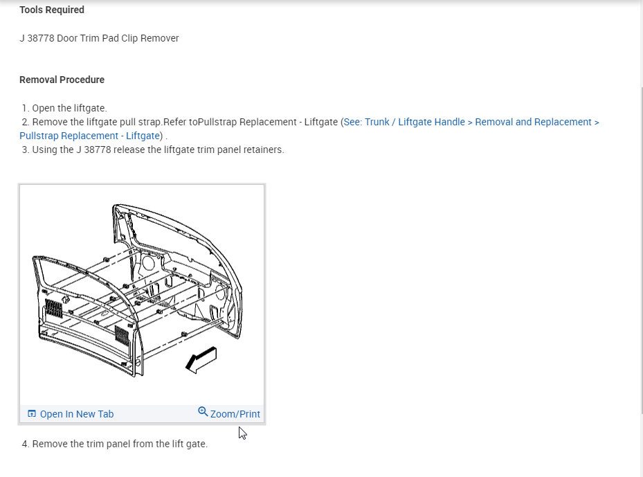

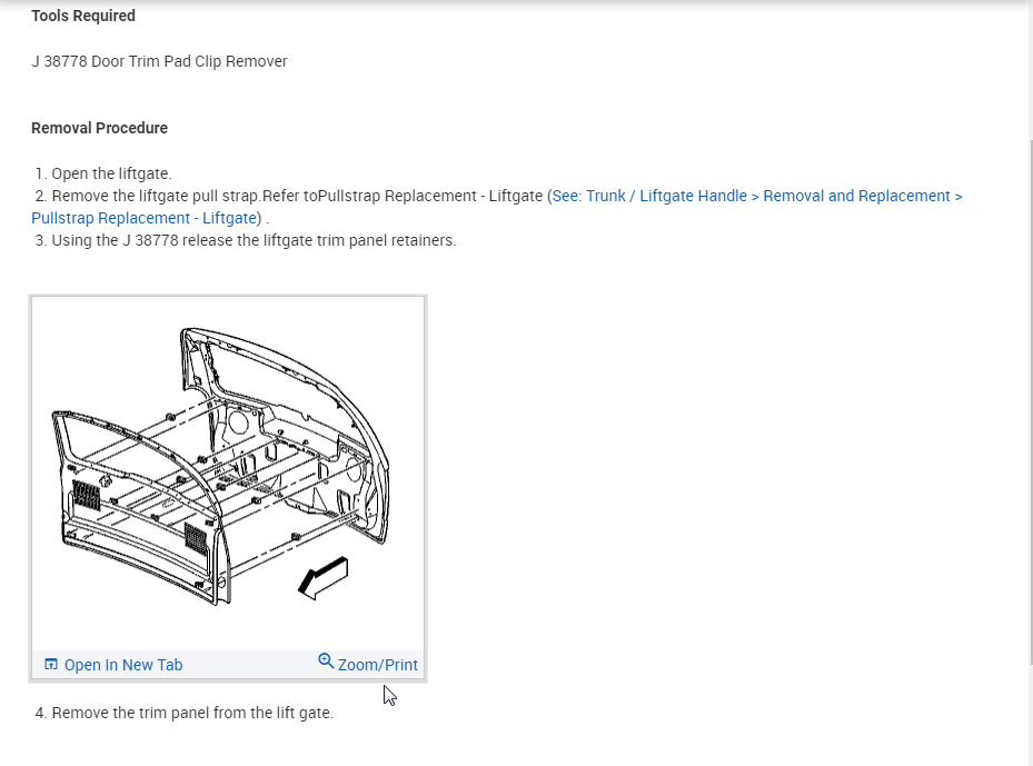

More than likely this is the wiper motor because I am not aware of any other components in the lift-gate itself. However, before you replace anything, you need to pull the trim panel off and identify for sure what it is.
I attached the procedure on how to remove the panel.
