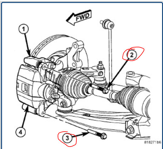

Melissa, you are very welcome. As far as the slide pins are concerned, they just bolt in. I attached a pic below.
When I service brakes, I remove the rubber dist covers and spray the inside of the caliper and the slide pins with brake cleaner. Then I clean out where they go into the caliper with a rag to make sure all dirt is removed.
Once that is done, using brake grease, I relubricate the pins and where they press into the caliper. I don't think you put it together wrong, but I do want to point out that the slide pins are different.
One of the pins will have something like a rubber boot at the end. That is to help release the brake pads when you take your foot off the pedal. Make sure that one is the top slide. It may not be releasing enough if it is at the bottom, and you are hearing the pads making contact. (See pic below)
Also, before you take anything apart, lift that wheel and see if it turns easily. Do it when the steering is turned (the point where you would normally hear the noise) and then straight to see if it goes away.
Let me know what I can do to help.
See pic below.
