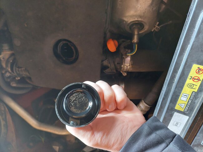

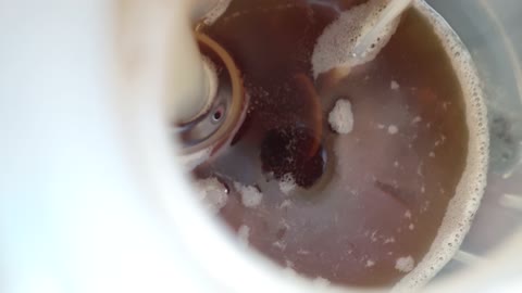

Hello, thank you dearly for replying. I've skimmed through the guides You provided, and I have pictures and videos. So, I've noticed that after a 20 minute ish drive the radiator hoses get really hard, like hard to put a dent in, I've checked the oil cap and there is nothing on it, I've had an oil change like 5 days ago and nobody reported anything being in the oil. The coolant i show in the video from the outside of the reservoir had gone down overnight, I believe it leaked on the bottle because of that extra pressure, I didn't open it to release the pressure just to see if it will leak more. I've also got a video for the bubbling coolant inside the reservoir and as far as i can, i don't see it happen. I said " nasty to touch" like it being soaked in coolant, somewhat. Also, there's no white smoke or blue smoke or anything coming out of the car, i also got a video of it freshly started and it was pretty cold, yet there wasn't any really visible white smoke as I've seen in the guide. Now I believe something is putting pressure inside the reservoir, or maybe the reservoir is the problem itself, or the EGR filter. Though I don't know. I can only speculate because mechanics tell me different stories. Maybe it still could be a faulty head gasket but it's not showing that many symptoms as of yet?
