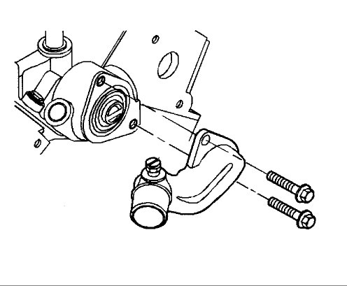

check your upper hose first thing in the morning. If the hose collapses then the radiator cap is defective. Also, I would have it checked for air in the system. I usually use an air lift tool to pull the air out the system when it is empty. There should be a bleed screw at the thermostat housing. Usually opening it up and pumping pressure with the pressure tester will push out the air but you would need to do it several times until just coolant comes out. The brown stuff is very common on Chevrolet and Dex-cool. When there is air introduced from a leak the coolant starts to turn that color? You can try and wash it out, but it would be better to just replace the bottle. Also when pressure testing, have him recheck for leaks. The lower intake gasket on those always to seem to leak as well.
