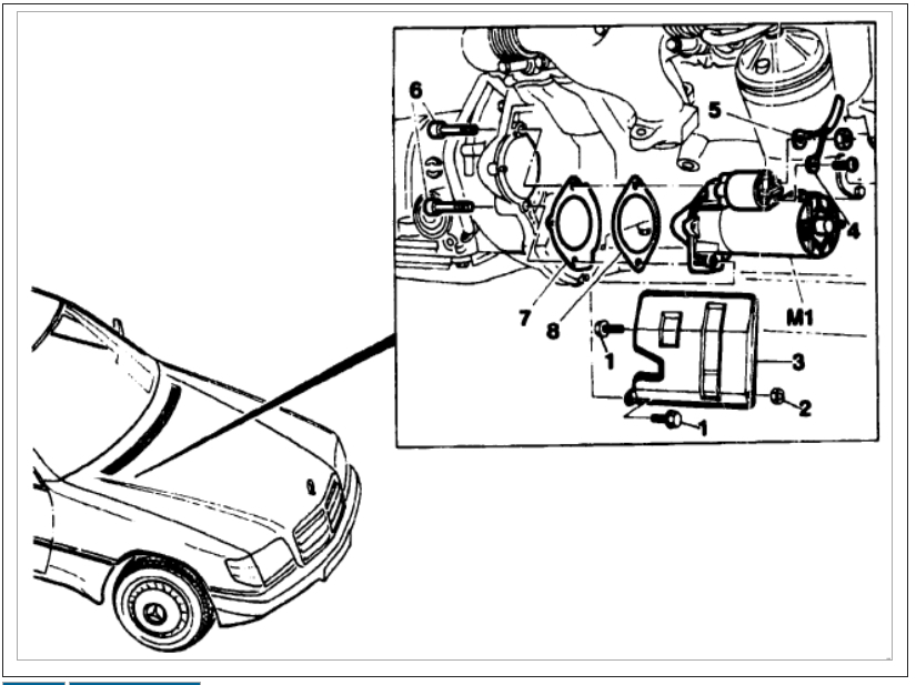

It sounds like the engine is hurt or the starter motor is bad.
Here is a guide that will show you what you are in for when changing he starter motor out.
Here is diagrams to help you see what it will be like on your car.
