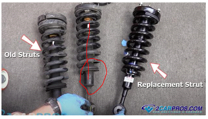

When the tire hit hard, did anything under the vehicle hit as well? I ask because you indicated you feel it under the seat. I'm wondering if an exhaust hanger or something similar was damaged and you feel it bumping against the floor.
Also, you could have blown out a shock. If that happened, you would likely see oil leaking from the shock/strut assembly.
If you look at the pic below, I circled where the oil would likely end up. The vertical line is the shock portion of the strut assembly. Chances are it would leak from the top and run down to where I circled. Look under the driver's side of the vehicle and inspect the strut for leaks. Also, check to see if there is anything that appears it may have been damaged from being hit.
Let me know what you find. Also, let me know if you hear anything when you feel it under the seat.
See pic below.
