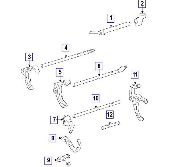

It sounds like you have an internal issue with the transmission. You have a shift rail in the top of the transmission. That is what controls the gears you select.

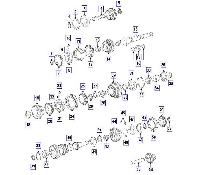

From driving in one gear home, you may have damaged the clutch as well. The transmission has to come out anyway and while it is out, it should be opened up and inspected for the failure.
