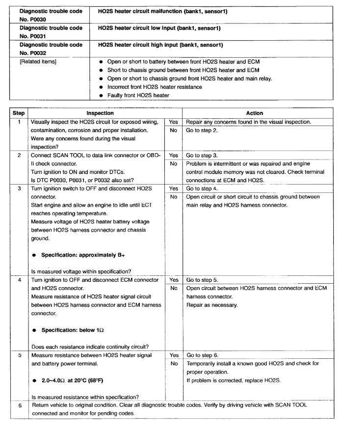

P0030 - Bank 1 Sensor 1 o2 sensor malfunction

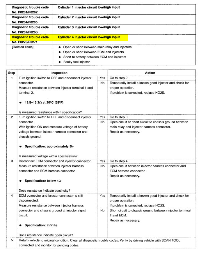

P0270 - Cylinder 4 injector circuit malfunction

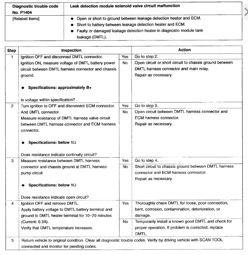

P1404 - Leak detection pump circuit malfunction
Start with the P0270 code and go through that testing. I suspect that is the cause of the others so if we fix that issue then we will fix the others.
Are you familiar with how to test for open circuits and shorts?
Here is a guide that goes through the basics:
Please let me know what you find or if you run into issues and we can walk through this but unfortunately I suspect you have a wiring issue so we need to go through this testing. Thanks
