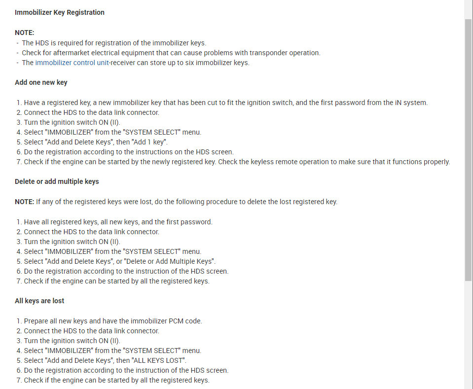

If that does not work, then unfortunately you are going to have to replace the key and have it programmed.
This means we are going to need a scan tool capable of programming this new key.
I attached the process below for your review. Let me know if you have questions on this and if this trick works. Thanks
