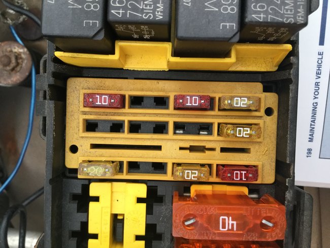

I did the test light and found the fuse that is drawing the power it seems to operate my radio and my gauges. It is in the power distribution box under the hood and it is not the factory radio so I pulled it out and the light on the tester was still on. It is a mini fuse I pulled the fuse out in the picture. it is in the middle between the 10 amp and 20 amp. Thanks
