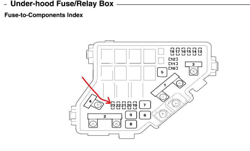

So, I have the car listed above EX model. I was installing LED dome lights yesterday, LED lights worked for front and back. As soon as I tried to change my trunk light, I pulled out the halogen bulb and then there was a small spark, after that none of my interior and trunk light was working. Everything else is fine, it’s just map, dome and trunk light not working.

Sure, please check the #22 fuse under the hood it should be a 7.5 amp. Here is a guide to help and the fuse location in the images below:
