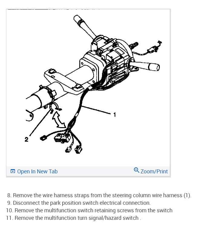

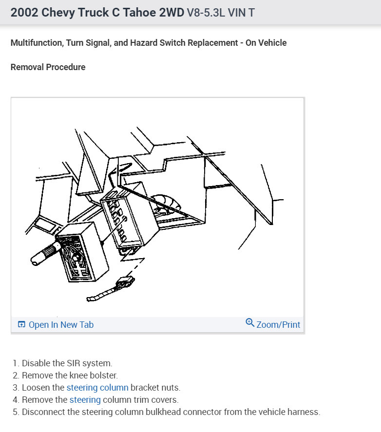

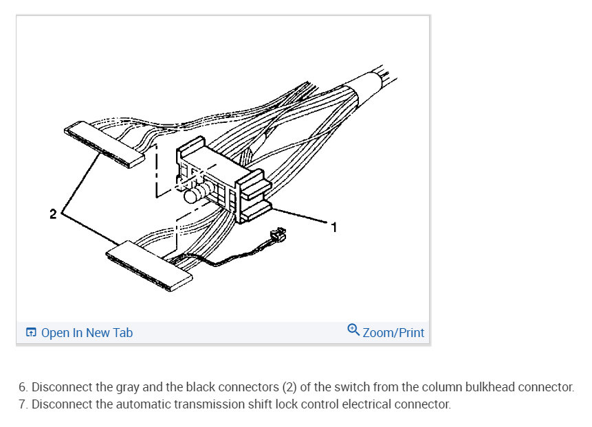

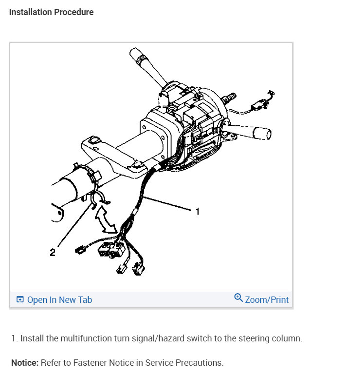

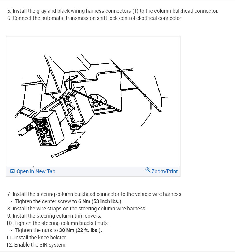

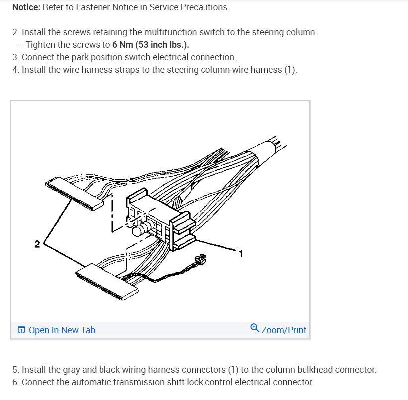

Yep, none of the blinkers will work right if the hazard switch is broken because the blinkers run through the switch, it is not too bad to change the switch out which is called a multi-function switch. You will need to remove the plastic cover around the steering column the screws are in the bottom of the cover. I have left instructions in the diagrams below on how to change the switch out. Check out the diagrams (below). Please let us know if you need anything else to get the problem fixed.
