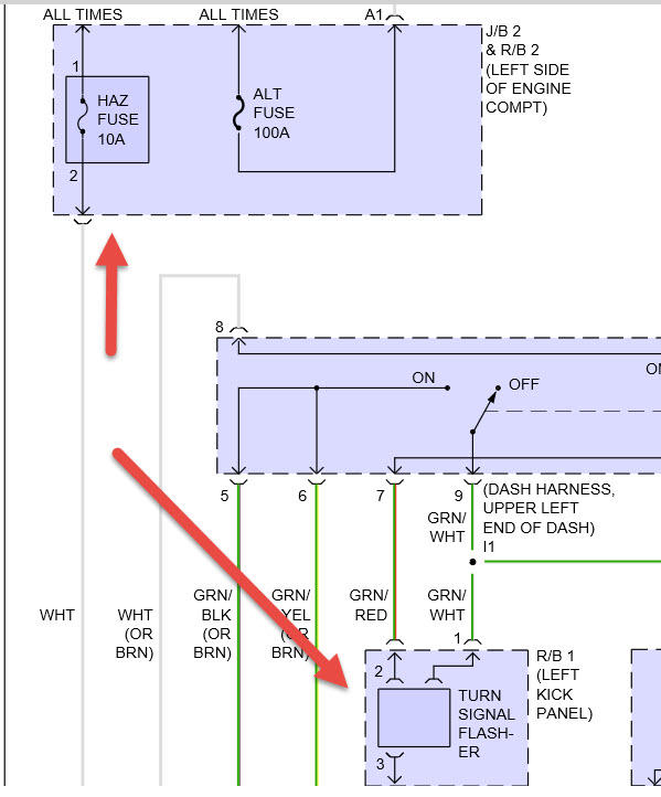

My hazards and blinkers wont work
1998 TOYOTA CELICA
1.8L • 4 CYL • FWD • MANUAL
SCOOBYLOU
They just stop working there is no noise at all

check items in pic then have multi function switch checked as it may be bad.
