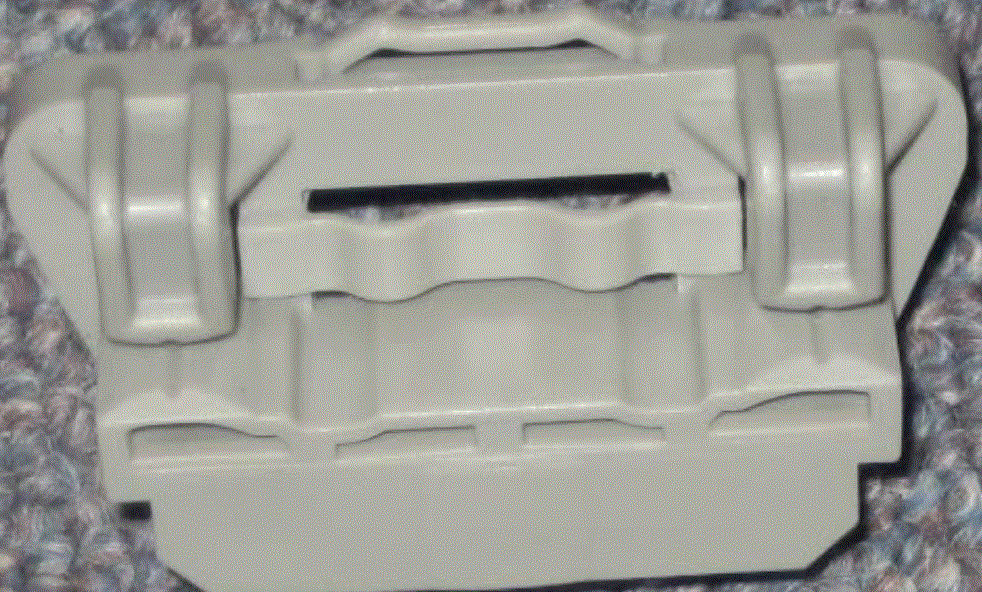

I attached a pic below. Can you tell me which part has broken?

The two outer plastic clips on outsides’ or on top and bottom based on picture.

Stacy, those are simply called window regulator attachment clips. They attach the glass to the regulator assembly.
Take a look at the pic below. If that is the part you are referring to, you can find them online or even eBay. They are cheap. Simply look up window regulator repair clips and it should bring it up for you.
