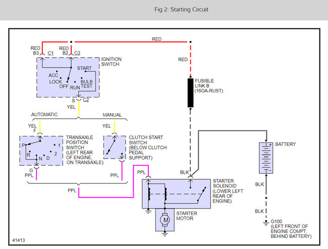

I wired a new starter in and I wired it wrong. So when I to start the car and it tried twice then everything went out. Now my dash will not turn back on, but my headlights and interior lights work.
