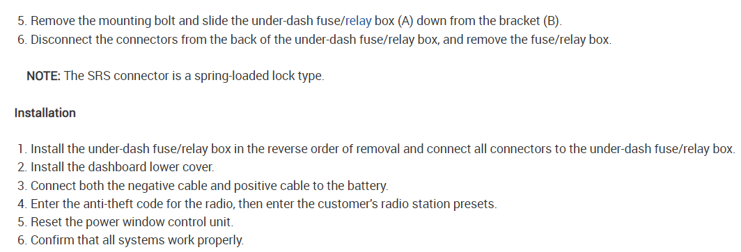

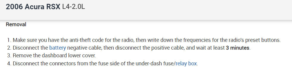

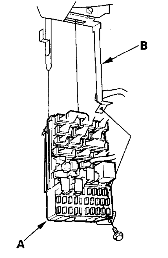

This is common when the multiplex unit goes out which is under the left side of the dash. Here is how to change it out to help fix the problem. Check out the images (below). Let us know how it goes.
