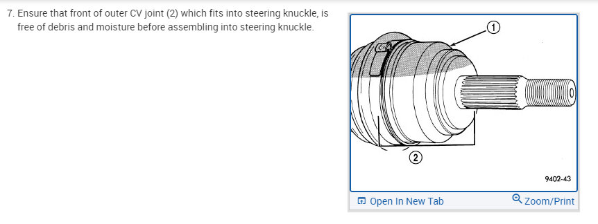

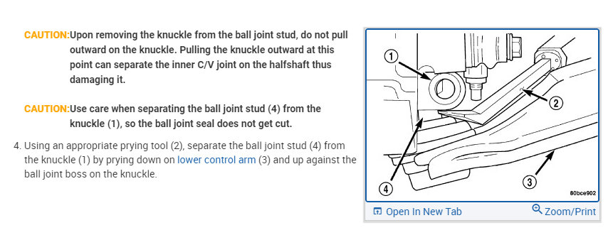

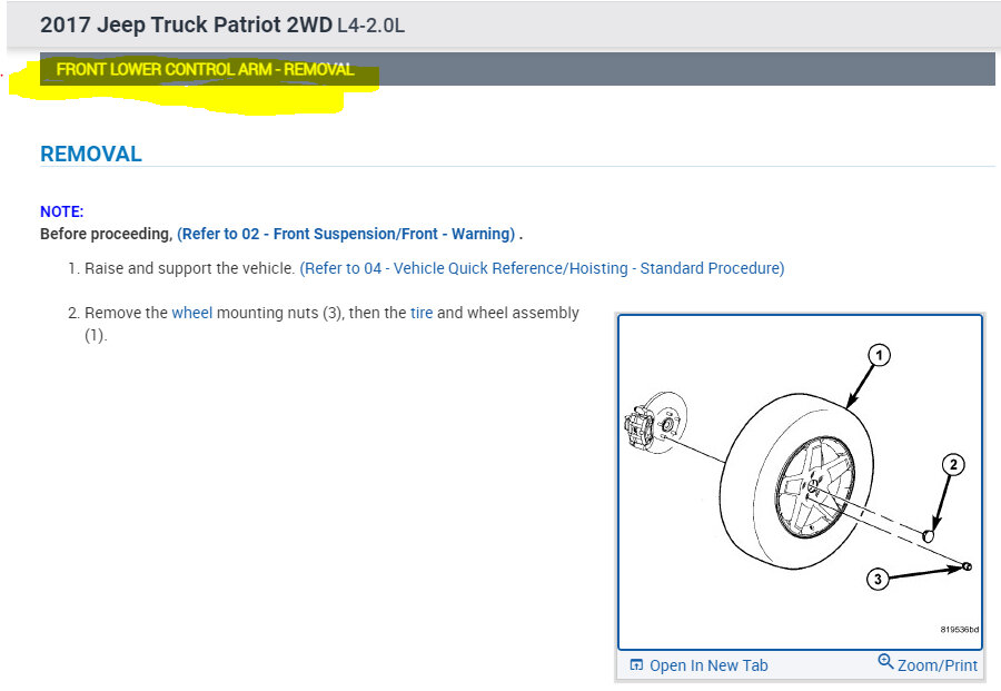

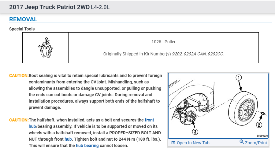

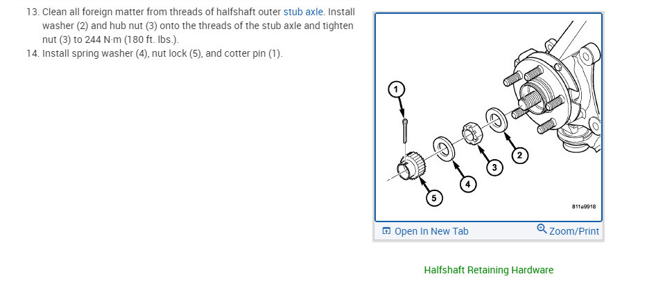

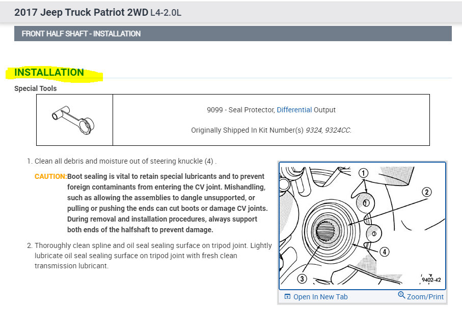

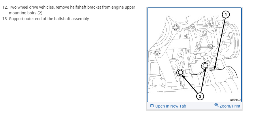

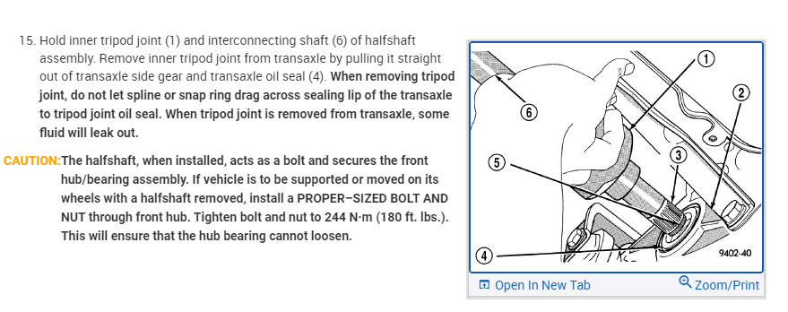

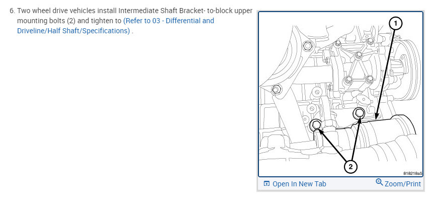

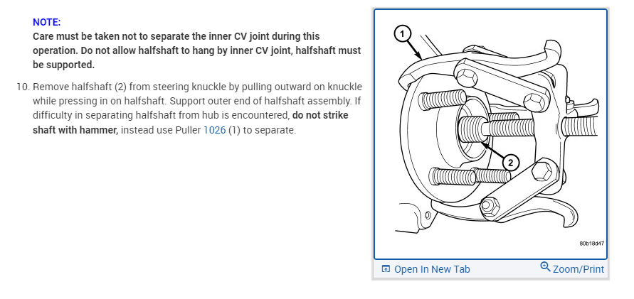

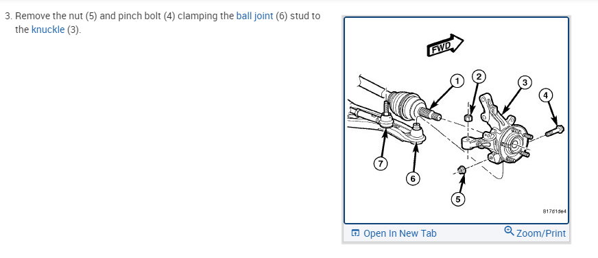

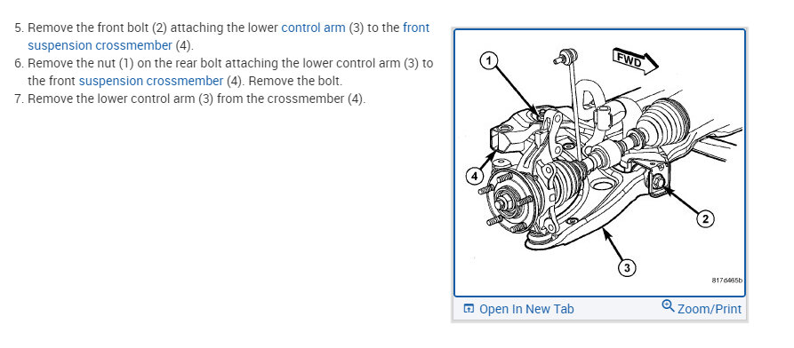

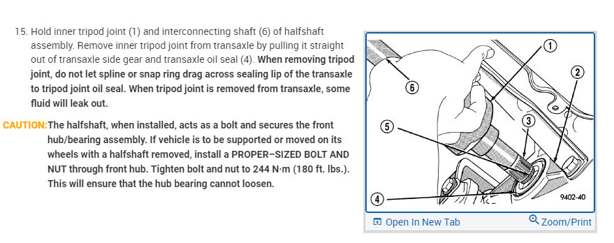

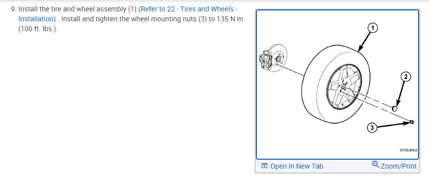

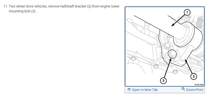

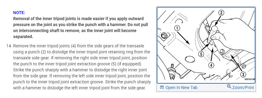

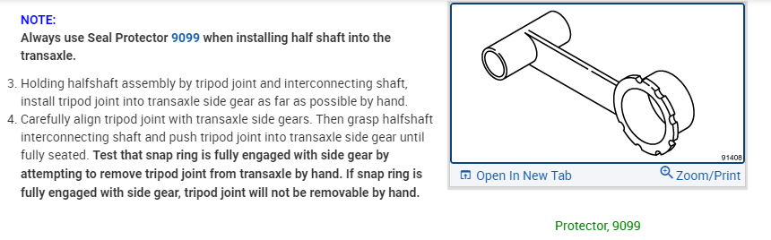

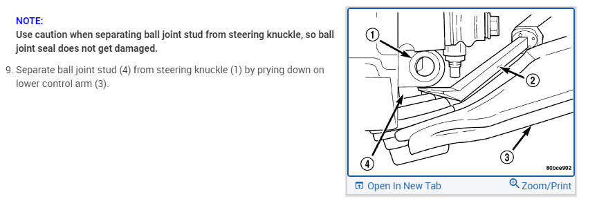

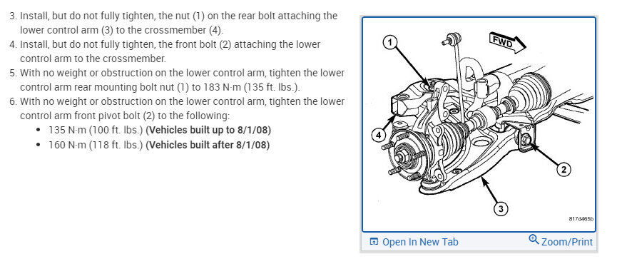

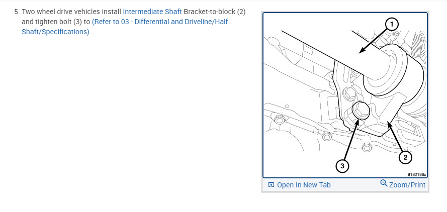

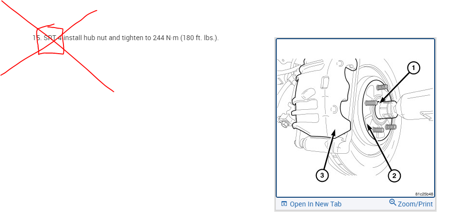

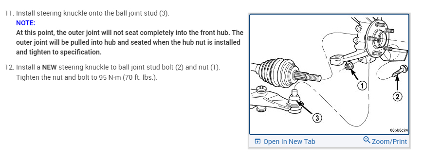

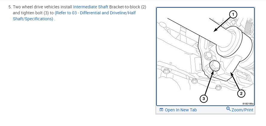

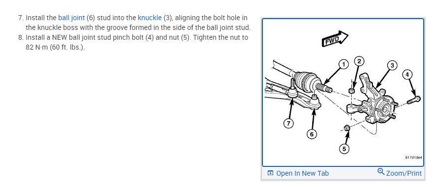

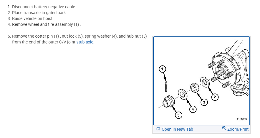

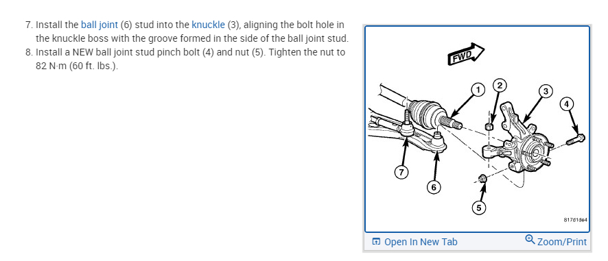

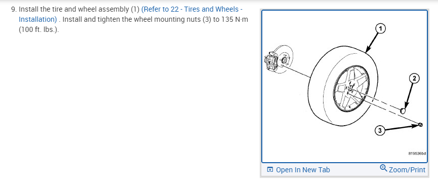

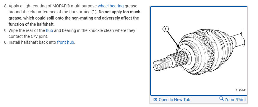

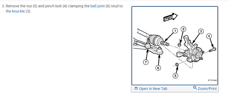

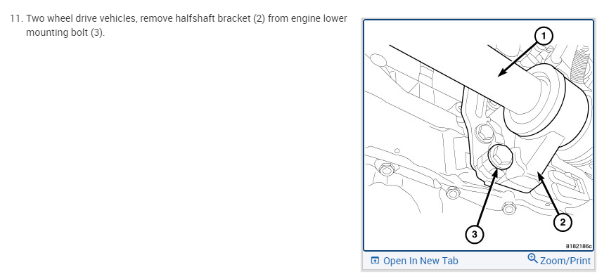

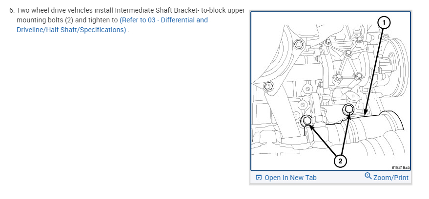

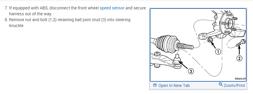

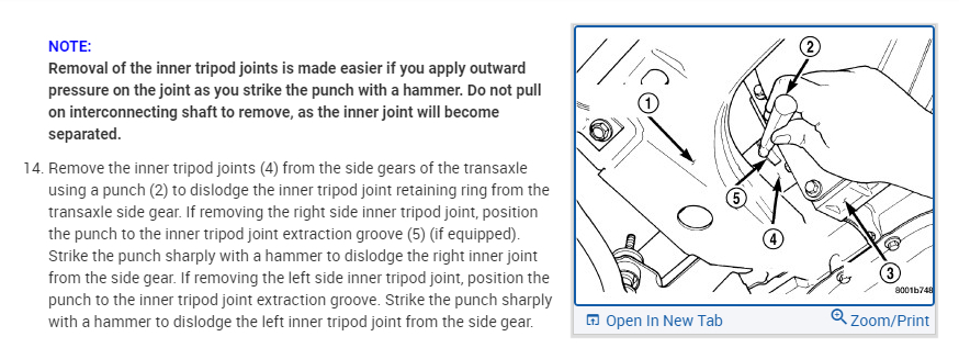

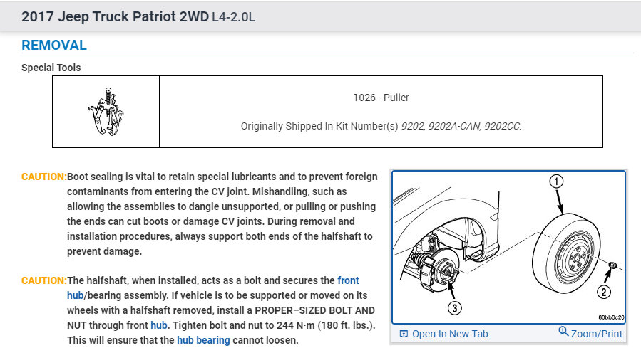

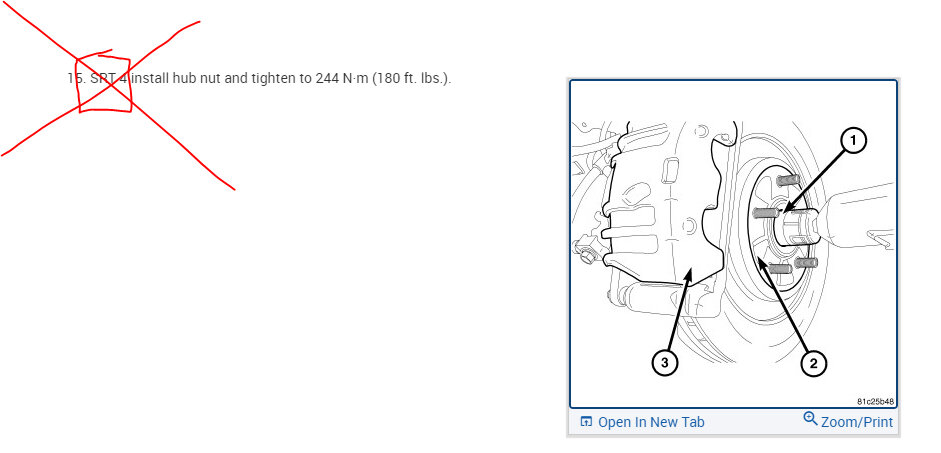

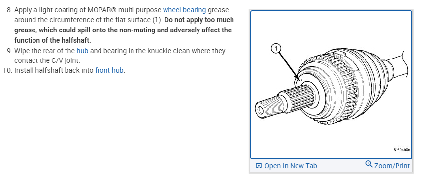

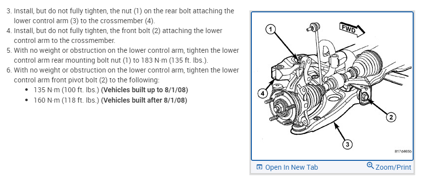

As far as tools, the axle assembly, you will need a puller (seen in directions) and a hub nut socket which is somewhat large, and a torque wrench that can reach 180 ft/lbs. Also, there is a seal protector tool indicated. Keep in mind, most parts stores will lend you the tools you need.
If you look below, I started with the directions for replacing the axle assembly. Once the lower ball joint is removed and the axle is removed, then you can work on the lower control arm.
The remaining pics are for the control arm. Note that some of the directions are the same as axle replacement.
Let me know if you have questions or if I can help in any way.

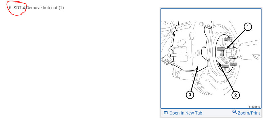

See pics below. Note: In the directions, it shows two hub nut designs. One is for an SRT 4. I don't think that is what you have, so ignore that set of directions and focus on the one prior to it.

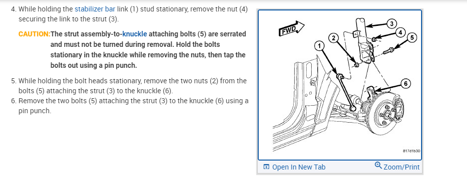

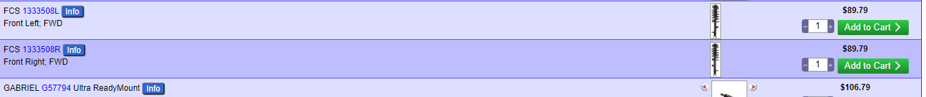

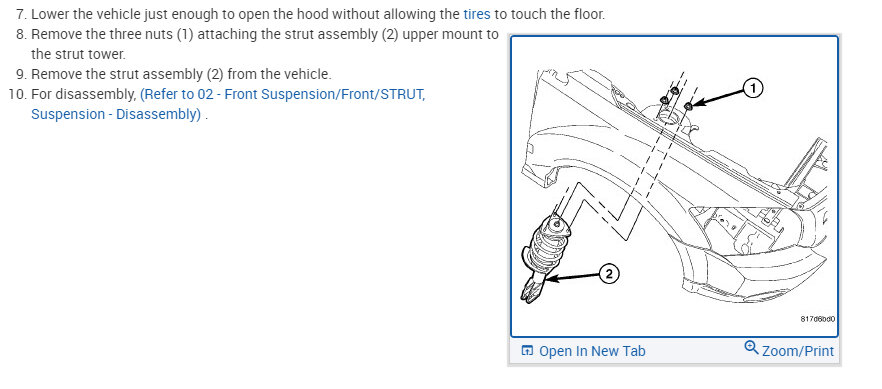

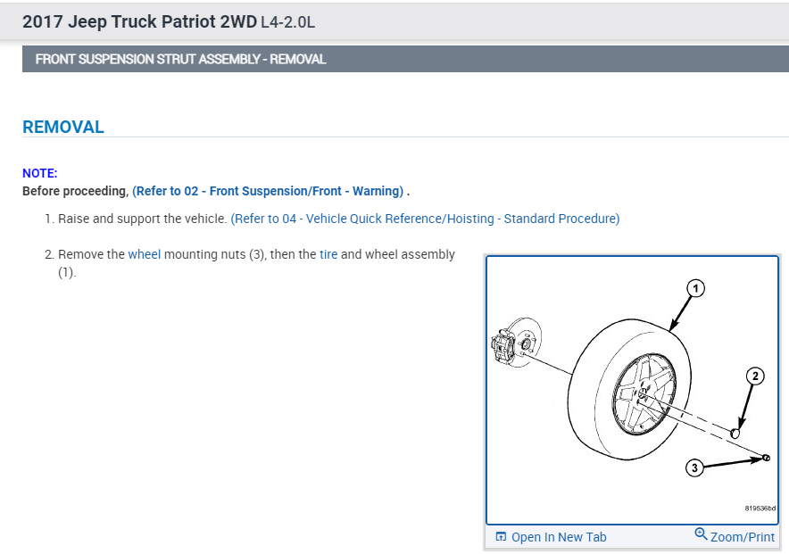

Melissa,

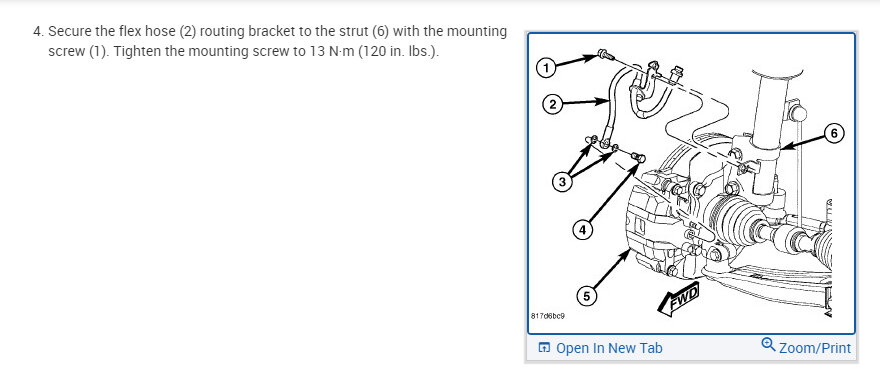

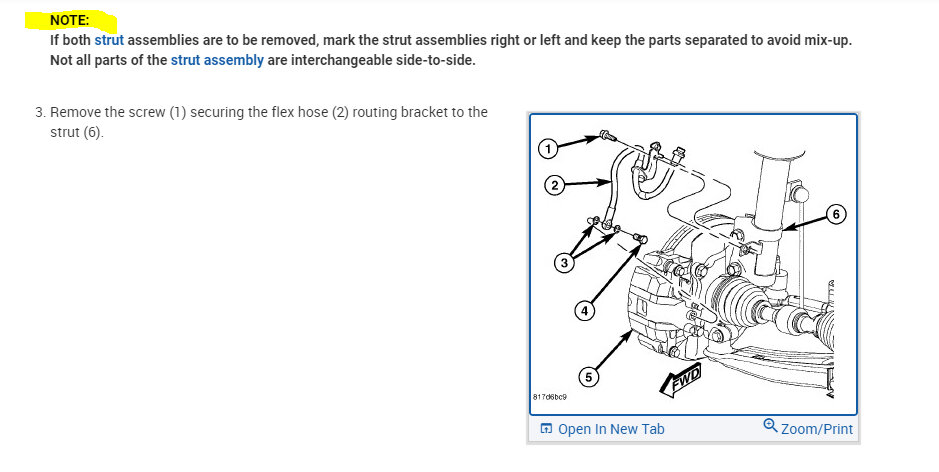

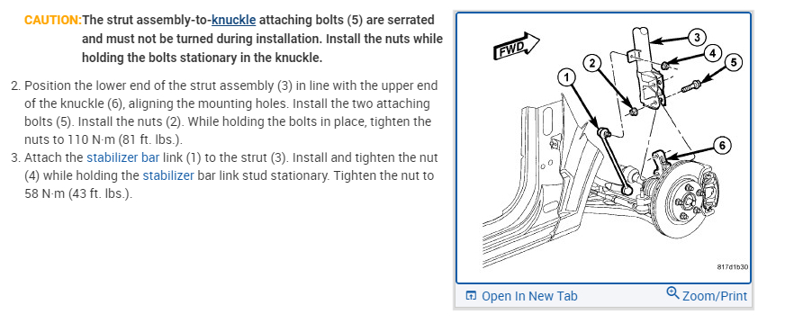

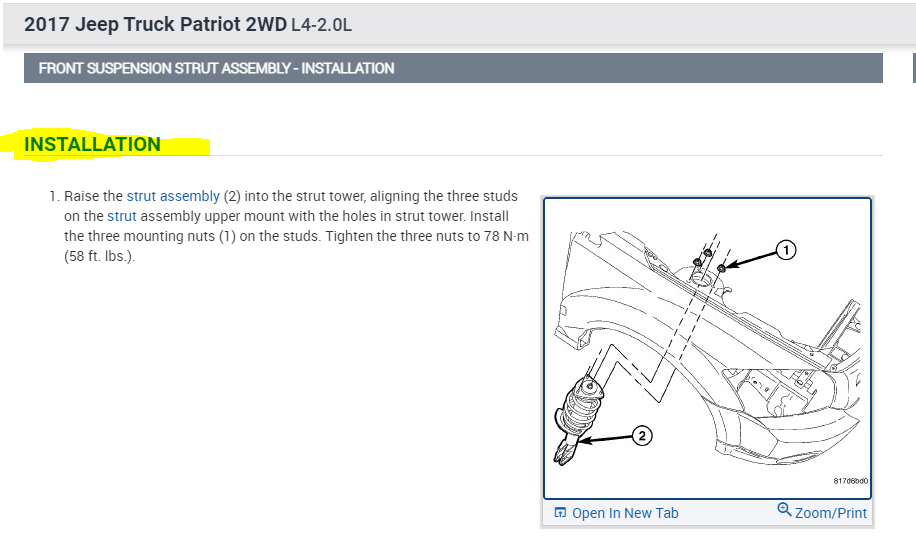

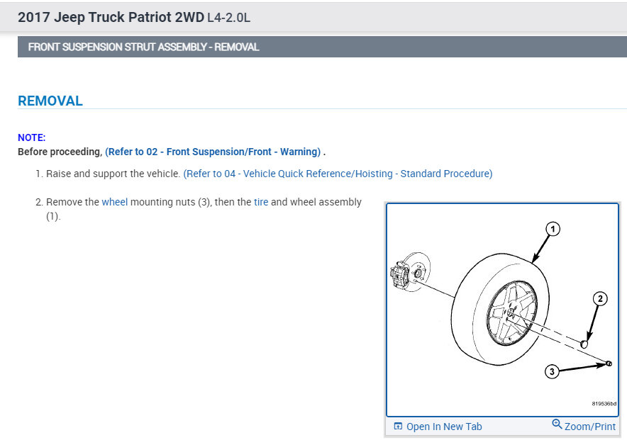

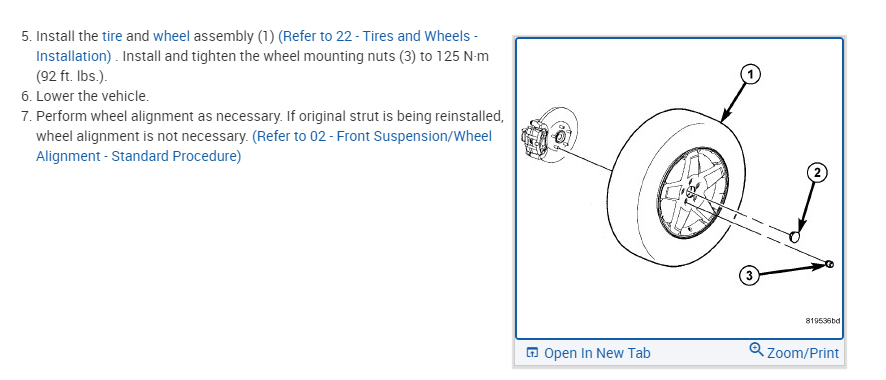

If the strut is the issue, here is what I recommend. I would suggest replacing the entire strut assembly that includes the coil spring and the upper mount assembly. They sell them on Rockauto.com. See pic below. I have a feeling the upper mount is bad as well as the strut. If you get all the parts individually, then you have to put it together which requires tooling, and it will be more expensive.
If you decide you want to get them from where I suggested, let me know. I can get you an additional 5% off.
After they are replaced, the front end will need to be aligned, so keep that in the back of your mind.
Also, please understand that neither I nor our site has anything to do with rockauto. I've learned from experience they have the best price for the entire assembly. I don't want you to think I get a kickback. LOL
I attached the directions below for replacing the entire assembly.
See pics below.
Feb 1, 2023 at 1:39 PM

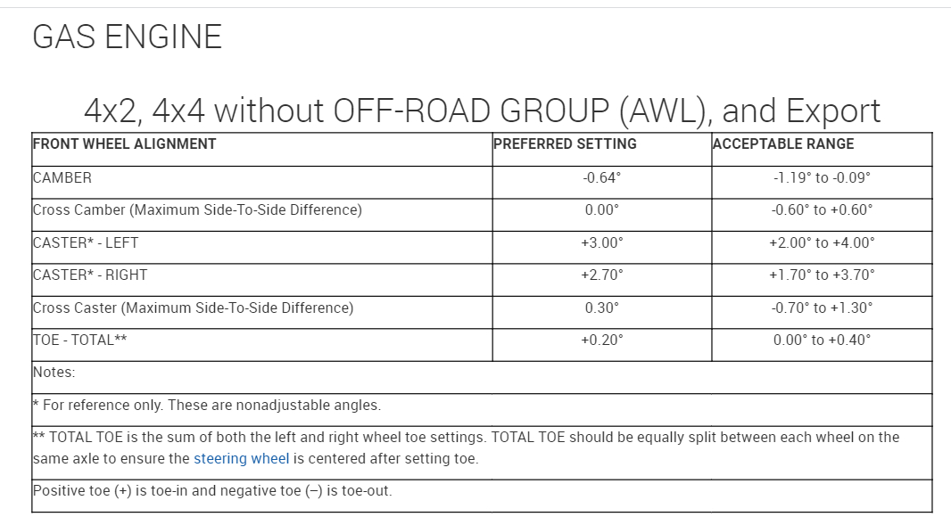

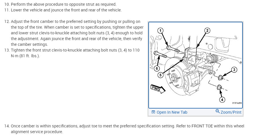

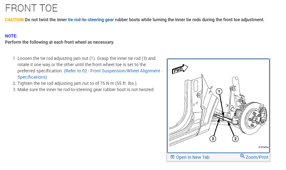

I received my strut package, which includes everything so I don't have to buy it all separately, and I have installed it, but I have not done my alignment because I don't know what degree my vehicle should be at. I tried to look it up and find a video or chart that shows me the correct information, but I keep getting off the wall information that has nothing to do with aligning a vehicle. Once I installed the new strut package my truck is back to being level and doesn't make any weird sounds that scare me and make me not want to drive my truck. I would like to thank you for all the help along the way. Without you, my love of my life, Zach Acosta, and my mother, Jacqueline Frank, I wouldn't have been able to get it done. All of you were a great help to me every step of the way. I appreciate everything.
Feb 6, 2023 at 6:56 AM

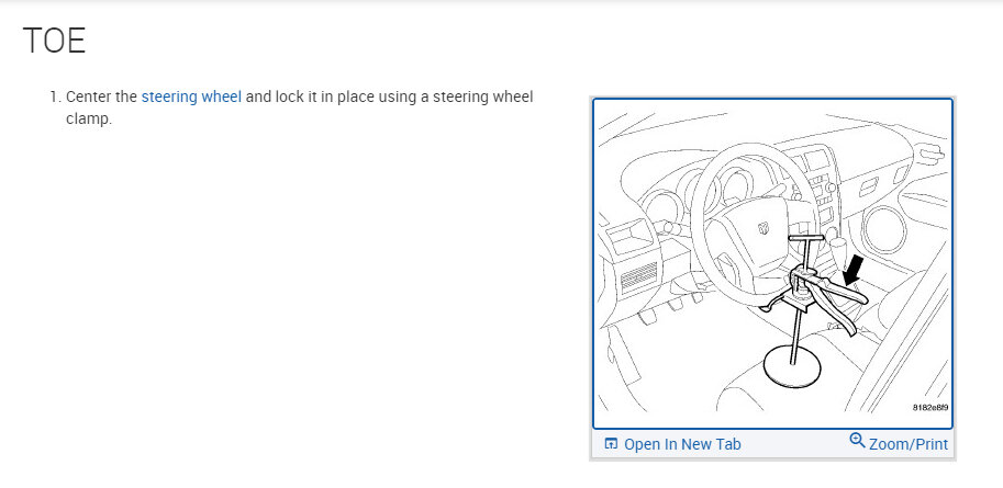

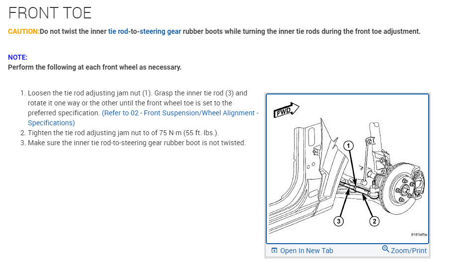

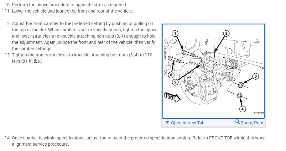

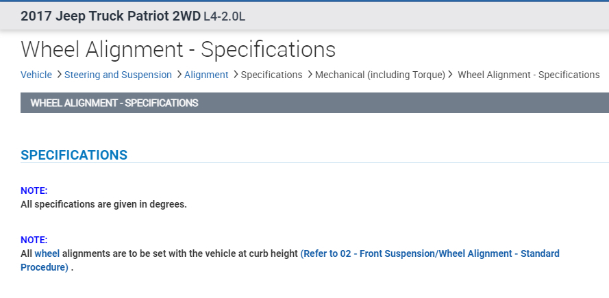

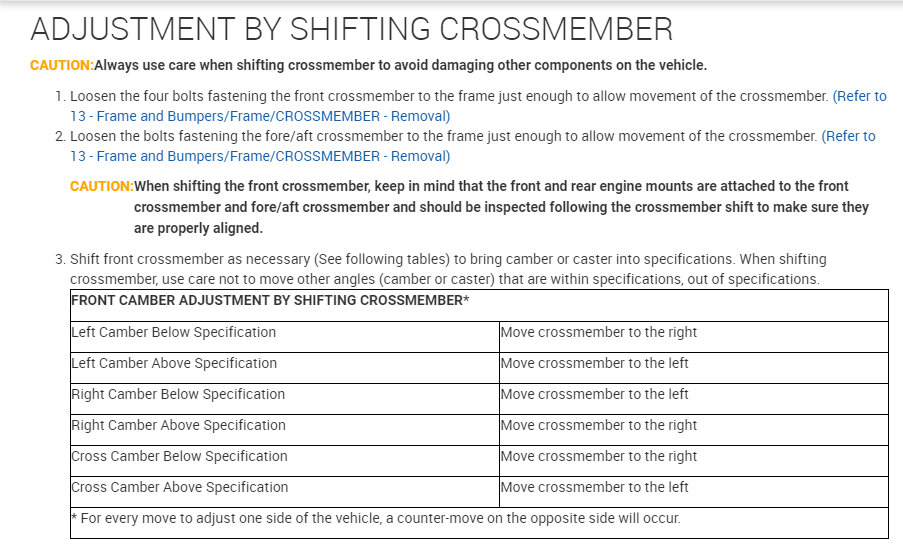

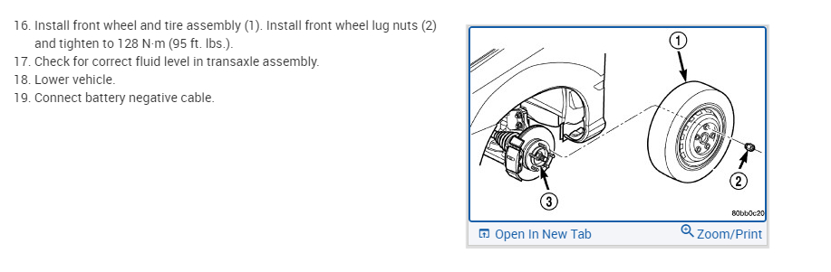

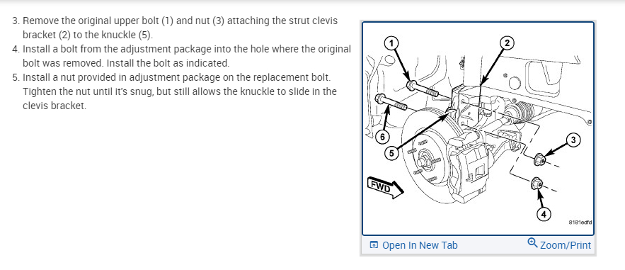

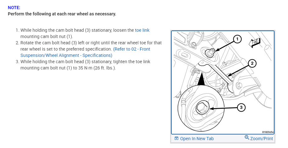

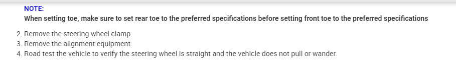

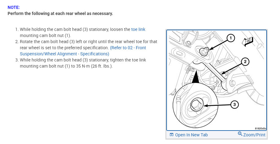

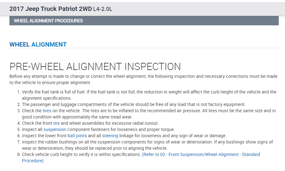

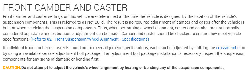

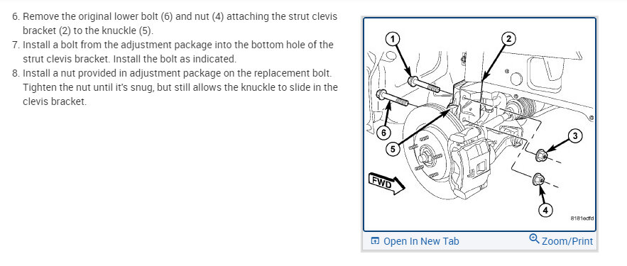

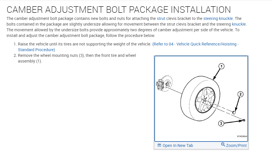

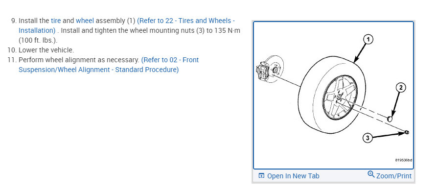

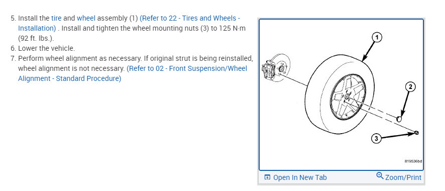

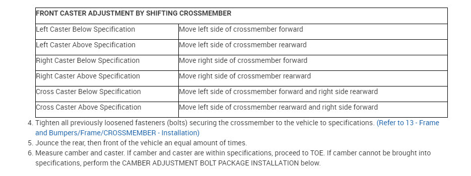

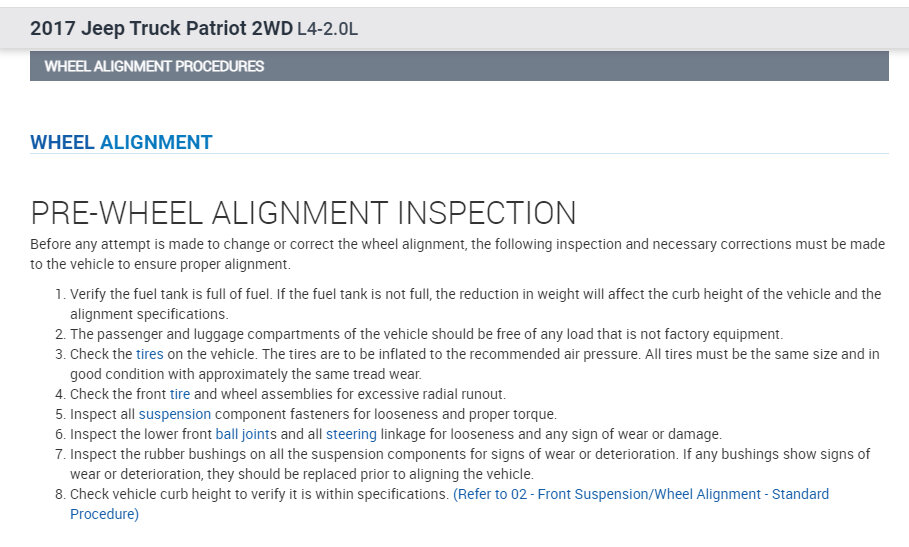

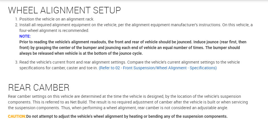

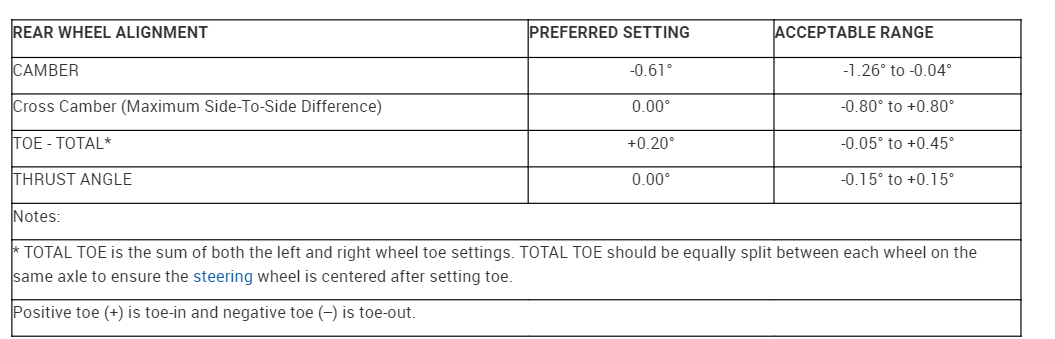

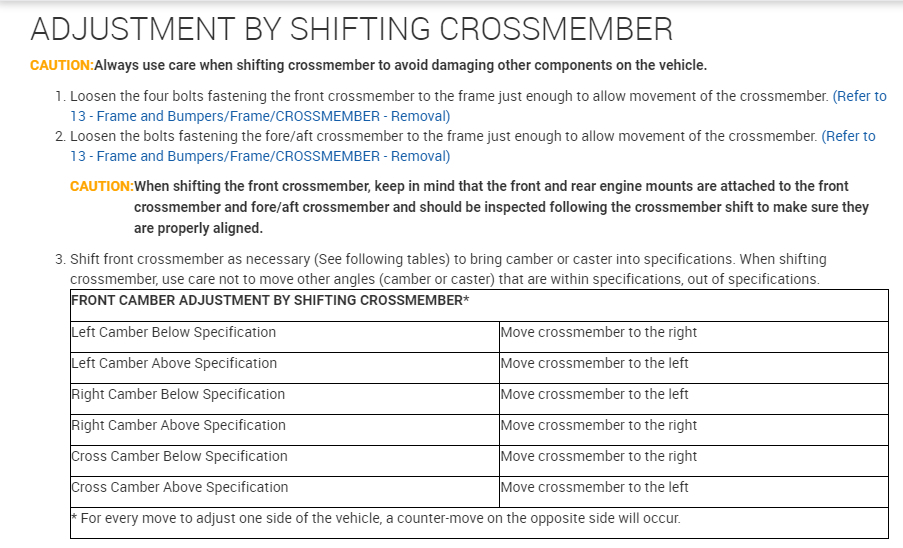

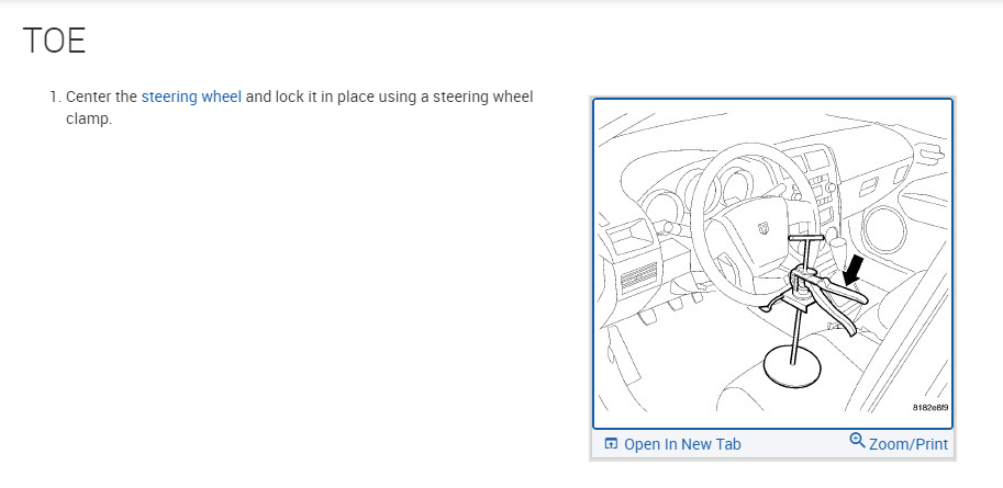

You are very welcome. I'm glad to know it was helpful. As far as the alignment is concerned, I do them on an alignment machine. I have all the specifications, but they are in degrees.
If you look at the first three pics below, they provide the specifications. The remaining pics are the directions. The directions provide adjusting caster, camber, and toe-in. The only thing you need to really worry about after the work you've done is camber. That is what is adjusted by the lower bolts on the strut assembly.
Let me know if this helps.
See pics below.
