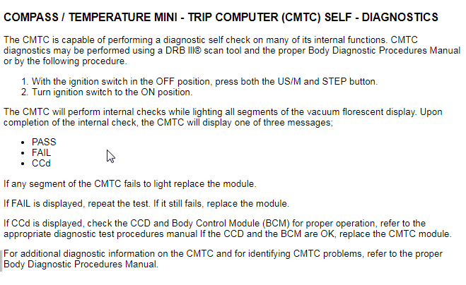

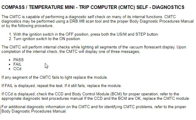

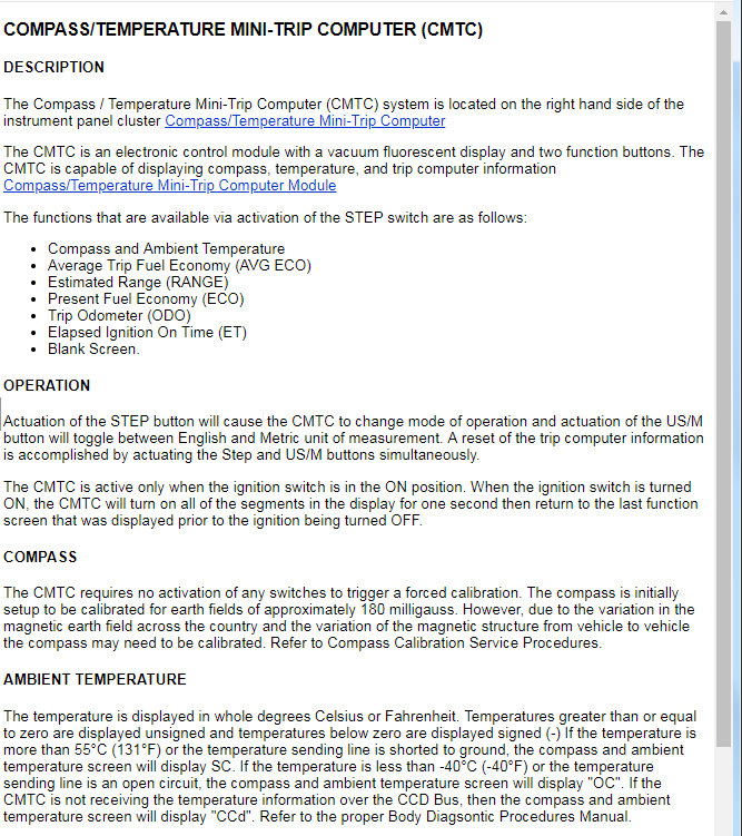

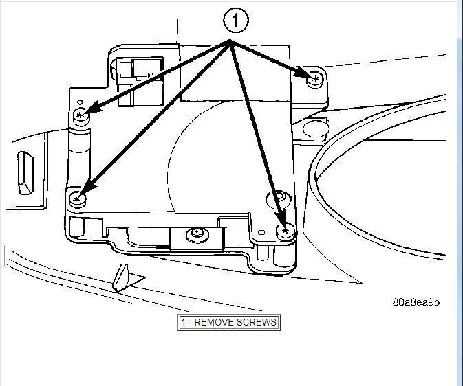

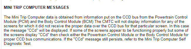

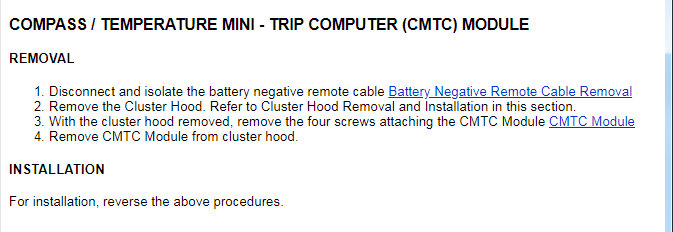

Here is the information on this module. There is a test that needs to be performed. Unfortunately, this is done with the scan tool called the DRB III. If you don't have access to one, I would think that the safe bet is this module has failed.
Please let me know if you have questions. Thanks
