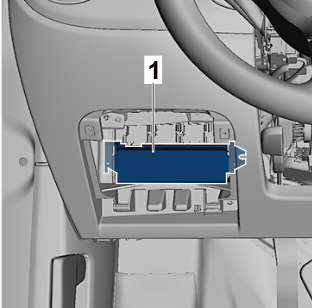

I got you covered, please check the fuse #30 - 20 amp in the fuse panel in the left end of the dash. The ground G44 for the cigarette lighter is at the left bottom of the kick panel. Here is a guide to help you check the fuse:
Here is the fuse box location. Check out the images (below). Please let us know what happens.
