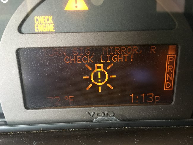

It mostly happens when the temperature is really hot outside. I turn the key and nothing happens. The battery is fine. I pulled the pilot bushing out and replaced the seals on it since the plug going inside had a little oil on it. I checked the TCU which is behind the metal plate under the passenger side floor carpet. No oil or water damage it looks brand new still. I have already checked all fuses multiple times and all fuses are good. I've run many different full scans on the car and it never shows any codes for the transmission. Only codes after scanning the motor. The security system is okay also. I drove it all morning a couple different times around town everything was fine. I went to get in it earlier and it started up fine took off and shifted fine about a mile down the road I lost the speedometer and the LCD dash display everything showed - - - and didn't get any readout on anything. It also got stuck in third gear or maybe second I couldn't tell. This has happened several different times. When I stop the car and turn it off and try to start it will never start again. Sometimes I can let it sit overnight and not touch it and it will start again the next morning sometimes it won't. I don't know what to try next.

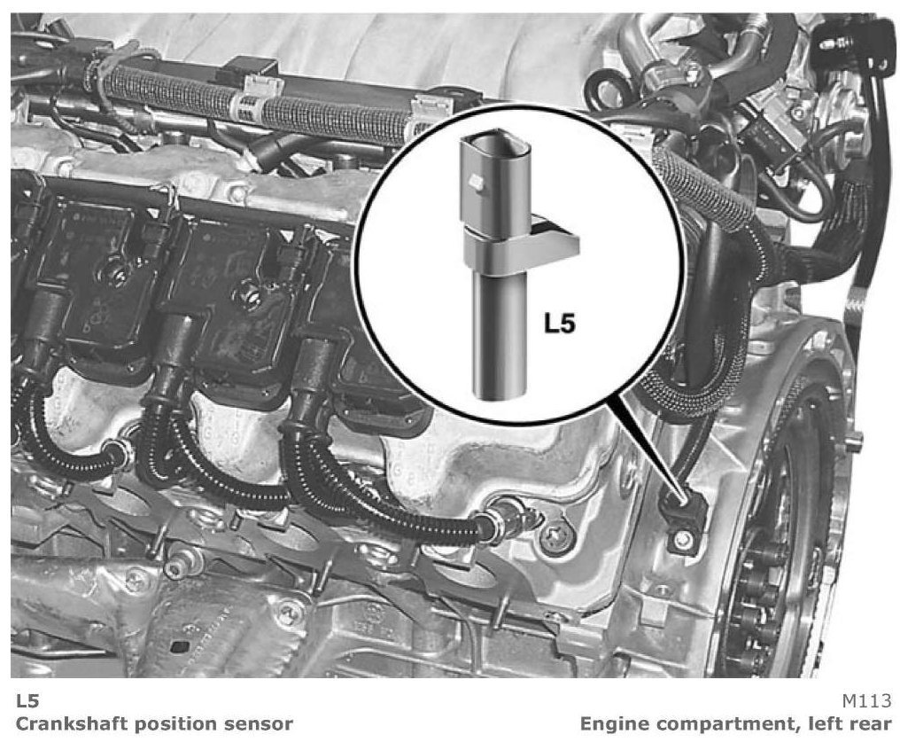

Your description sounds a lot like a failing crankshaft position sensor or a corroded connection to it. The hot vehicle no start is a common issue when those sensors start to fail. Many times they won't set a code if they are dropping out, only when they are out of sync with the camshaft signals. The sensor is tucked down on the transmission flange at the rear of the engine, just above the starter. It isn't hard to change but you need to re-initialize them using the MB Star scan tool or an equivalent or the engine won't even start.

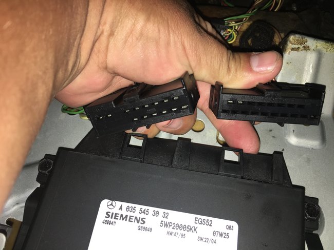

It's definitely not that sensor. I originally thought it was the pilot bushing after looking up many different websites with the same symptoms so I changed it and that didn't fix it. Then I realized that it wasn't showing any gear indicator on the LCD dash. When turning the key on it showed the S blocked out in yellow instead of P. I know if the car doesn't detect that it's in P it will not start. So I then researched this and found that people said the shift module inside the shifter can do this causing it not to register that it's in park. So I bought a used one from a salvage yard and still the same issue. Just earlier after two days of not starting or even trying too I decided to screw around with the relays. I pulled the K (AT relay) and S (starter relay) and swapped them around and when I did that I went inside and turned the key on and the P registered so I thought I had it. I tried to start the car and it seemed like it was trying to turn over but not enough juice in the battery like something was draining the battery. So as of right now, I have a battery charger on the car and soon I'll go give it a shot again and see what happens.

No, I've never changed that sensor before because it's never been a thought in my mind. A Mercedes pilot bushing goes inside the transmission it's where the 13-pin connector plugs into the transmission. It's a known issue where the o ring goes bad and it leaks oil into the connector shorting out the transmission harness and making the TCU stop the car from starting or shifting correctly. I've never had any issues at all with the motor running well. When it starts and runs it runs excellent the only issues I've had were always pertaining to the transmission. Going down the road and losing the speedometer and the transmission locking into one gear which is limp mode then getting it home turning it off and then it won't start again till the next day. I didn't realize till recently the reason why it wasn't starting is that the gear indication light wasn't showing the transmission in Park. If you looked on the dash you'd see no gear selected. I've uploaded an image to show you want I mean. Well, today I swapped the two relays mentioned earlier around and the gear indicator started working again it shows P when I turn on the key now where for two days it didn't. I've already checked the TCU it looks brand new inside and out all connectors look great and the ECU looks great too all looks brand new I've already checked both of those weeks ago and again recently. Photos attached of the TCU. ECU looks just as good all connections super clean and no damage inside. I just don't have any images of the ECU.
I want to mention though that the gear indicator is now working it shows P when I turn on the key so that part of the issue is fixed the issue I'm having now is it's still not starting when I turn the key the dash lights all come on all that good stuff but when I turn the key I get nothing at all. It doesn't even crank over. I feel like its the starter relay since I swapped those relays around.

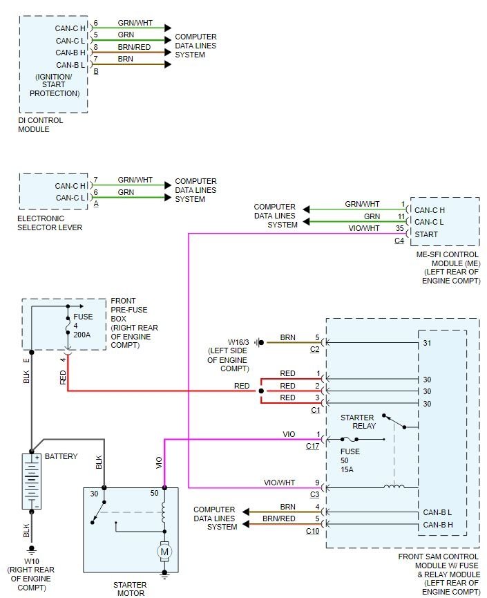

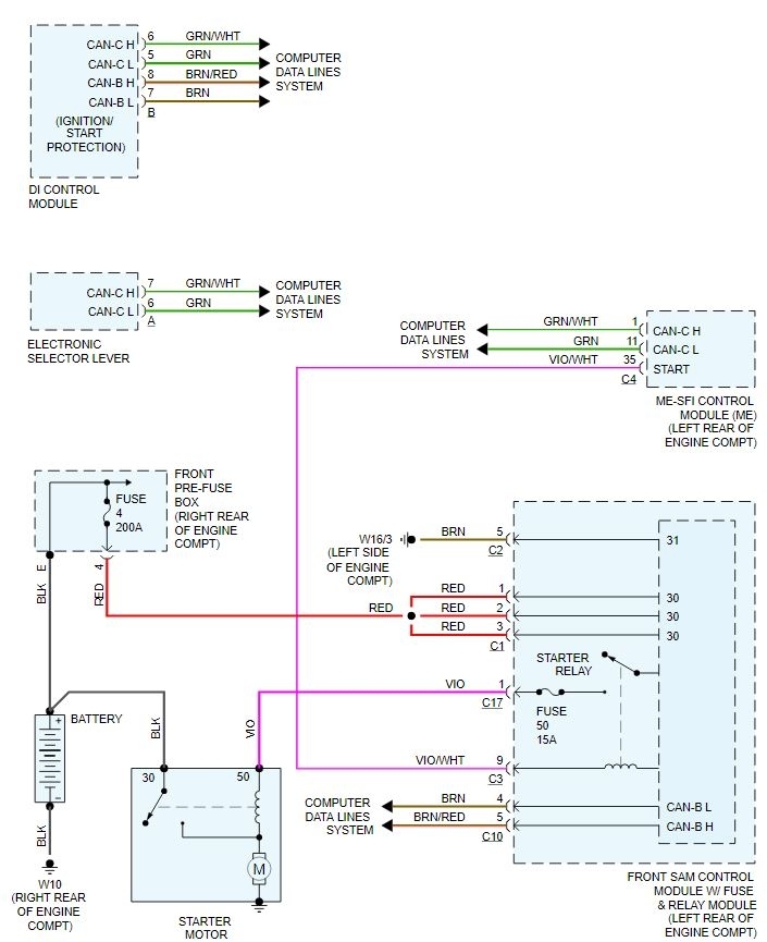

Reading back through your posts that it's doing nothing when you turn the key. Can you hear the starter solenoid engage when you try to start it? A quick test. With the key off pull fuse #50 in the front SAM. Take a jumper wire connected to battery positive and probe both fuse terminals. This bypasses all of the starting circuitry and should trigger just the solenoid and the starter motor itself. If it turns over the starter isn't the issue. If it doesn't see if you can turn the engine over by hand just to ensure it isn't something worse.
If it does turn over, try turning the key on and see if it now starts. That would narrow the problem into just the starting circuit. If it doesn't start and run then it's something back in the system farther.
If you have a test light you can also test that same fuse location to see if there is starting voltage there. With the fuse out, key off, connect the test light to battery negative. Have someone turn the key to start. Touch the fuse terminals one at a time. If the starter circuit is sending power to the starter the light should come on on one terminal. If you get nothing on both terminals it points to something in the rest of the circuit, possibly a CAN buss failure.

You have the wrong diagram for my car the stater fuse for my car is #52 the #50 fuse is for mass air flow, light switch module, etc. Here is the diagram for my car's front SAM:

Okay, so I ran a wire to the battery and touched it on #50 fuse and it sparked a little but no starter engagement at all. I don't know how the stater just magically went out when it has been starting this car with no issues for months but I guess it happens. That's one heck of a freaking job to change out a starter. I don't know what else it could be if I can't get it to engage then it has to be bad. You can do the same thing by jumping the starter relay which is what I tried yesterday and it sparked a little too but I couldn't get it to engage the starter either. The engine is definitely not locked up I don't need to check that at all. This engine runs flawlessly when it's actually running. If you have any more suggestions I'd like to hear them before I go try and buy and replace this starter. This is going to be an act of nature to remove this starter I don't know anyone who has a lift to put this car on which is really what is needed to do this job I need to get all four wheels off the ground as high as I can in order to remove the exhaust. Without removing the exhaust I can't access the starter at all. I wish this had been one of the Mercedes where the starter was under the intake manifold I'd be much happier right now.

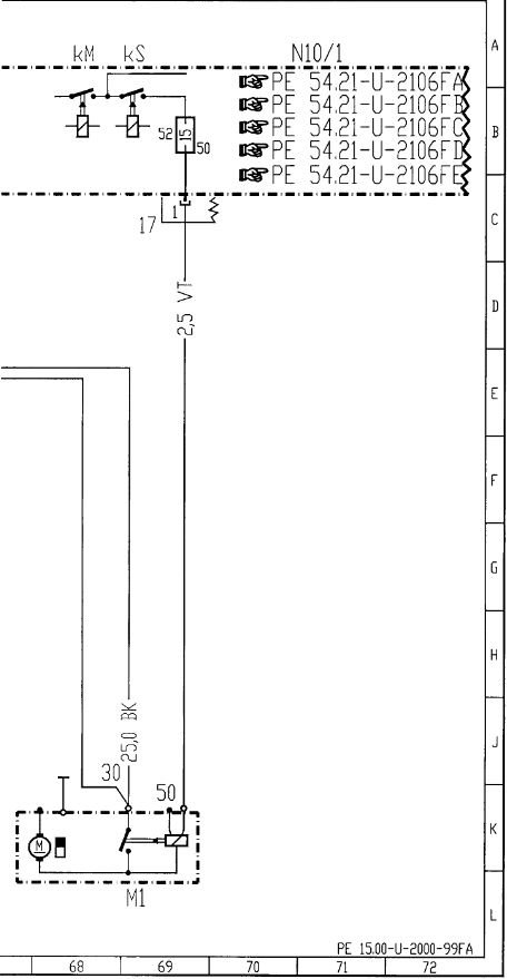

The safety switch is part of the shift module that you changed out already. This is the OEM wiring and they show it as circuit 50. With the fuse as #52 in this one. Thanks for posting the fuse diagram, looks like Bosch has some things wrongly marked. They used the circuit number instead of the fuse number. Try the same power jump for it. If the starter works this time then it's okay. The idea is to test the starter and bypass the relay, CAN and all the rest of the circuit.

If you apply power to fuse 52 does the starter turn? There won't be power to it unless the key is in the start position. That fuse is between the starting relay and the starter solenoid. One side of the fuse goes to the solenoid the other comes from the relay. It is just a bridge in the wire. Next would be to verify that the relay is sending power to that fuse if it is jumpered out. From there I would stick a factory level scan tool on it and see if the CAN buss is sending the correct signals when you turn the key. One of the reasons with all the tech in the cars it makes something simple into a mess, and they are getting worse.

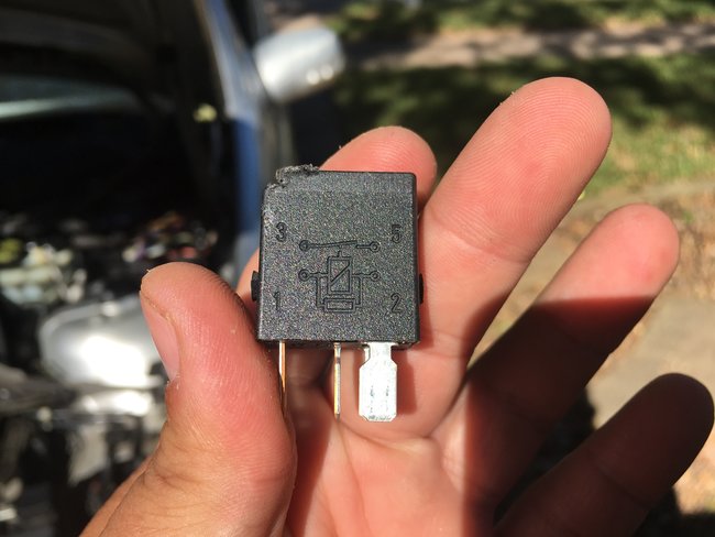

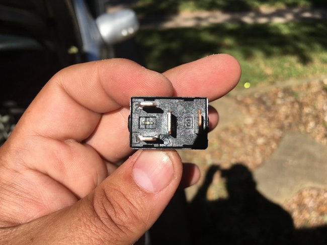

I've already pulled the starter relay and put a jumper between 3 and 5 which should be 30 and 87 on the SAM or whatever and turned the key on and no engagement on the starter once again. Both the relay and the fuse jumper didn't get the starter to turn over. Picture of relay attached.

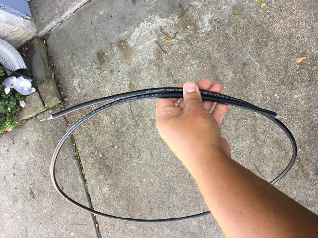

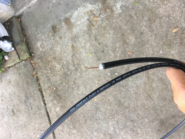

When I jumped the relay and then tried to jump the fuse after I used a cable TV wire for the jumper it seemed plenty big enough to at least do test pictures attached.
