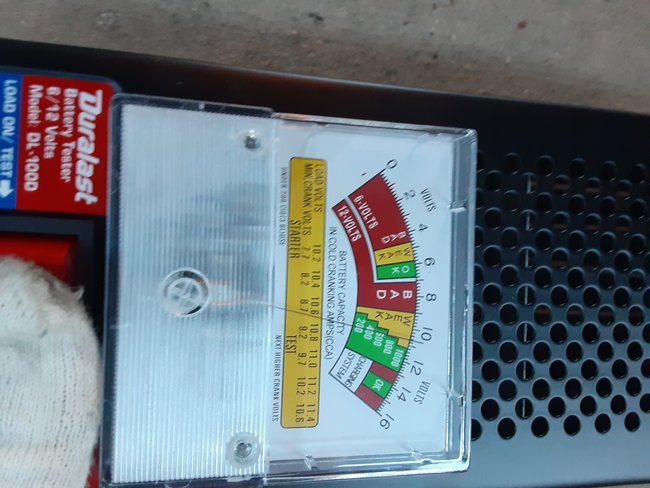

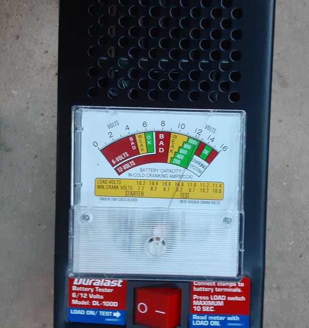

I did I tightened it and cleaned the connections first and the same thing one click. I borrowed a battery tester and the result after I turned it on. Is that good or weak?
Jan 4, 2021 at 11:13 AM
JOSEPH2007PENA
  • 5 POSTS
Before I switched the test on.
Okay, the battery test looks good. Since the starter clicks, either we have a bad starter or the engine is locked up not allowing the starter to turn it.

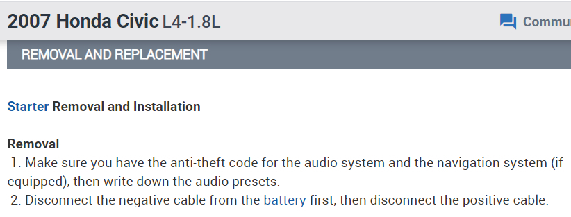

2007 Honda Civic L4-1.8L
Removal and Replacement
Vehicle Starting and Charging Starting System Starter Motor Service and Repair Removal and Replacement
REMOVAL AND REPLACEMENT
Starter Removal and Installation
Removal
1. Make sure you have the anti-theft code for the audio system and the navigation system (if equipped), then write down the audio presets.
2. Disconnect the negative cable from the battery first, then disconnect the positive cable.

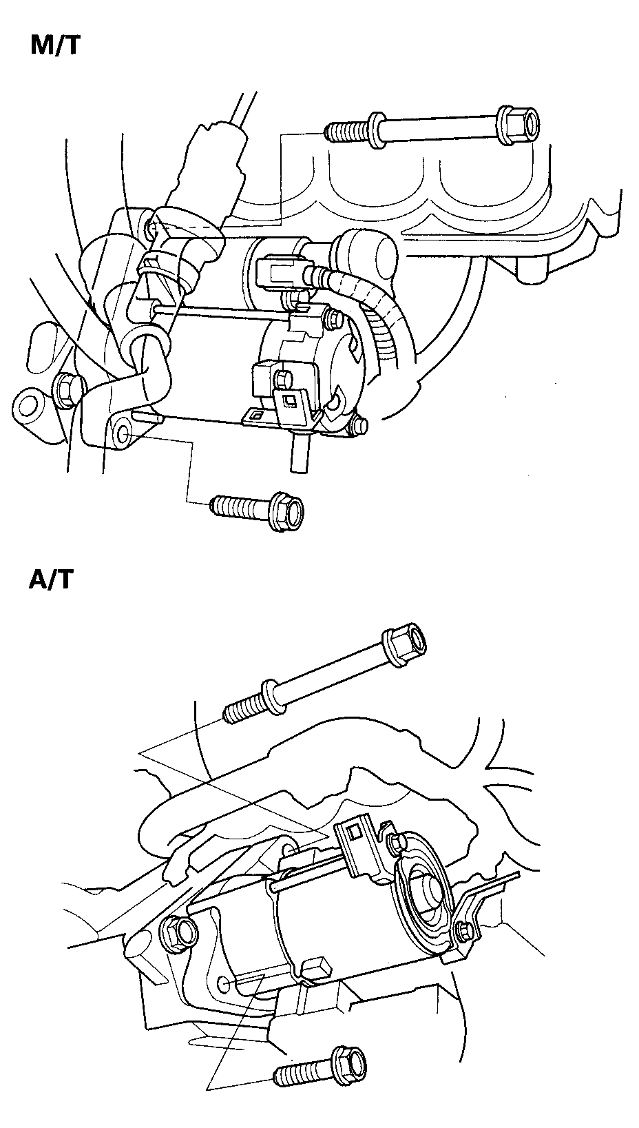

see pic 1

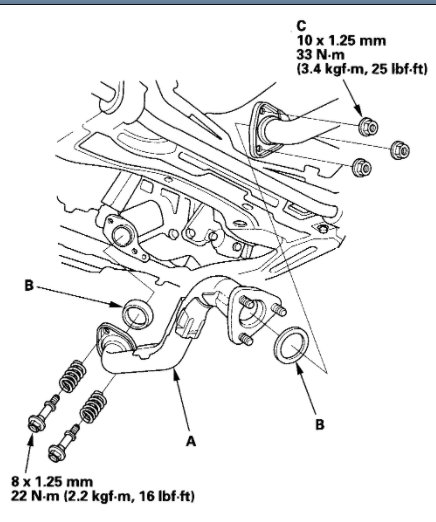

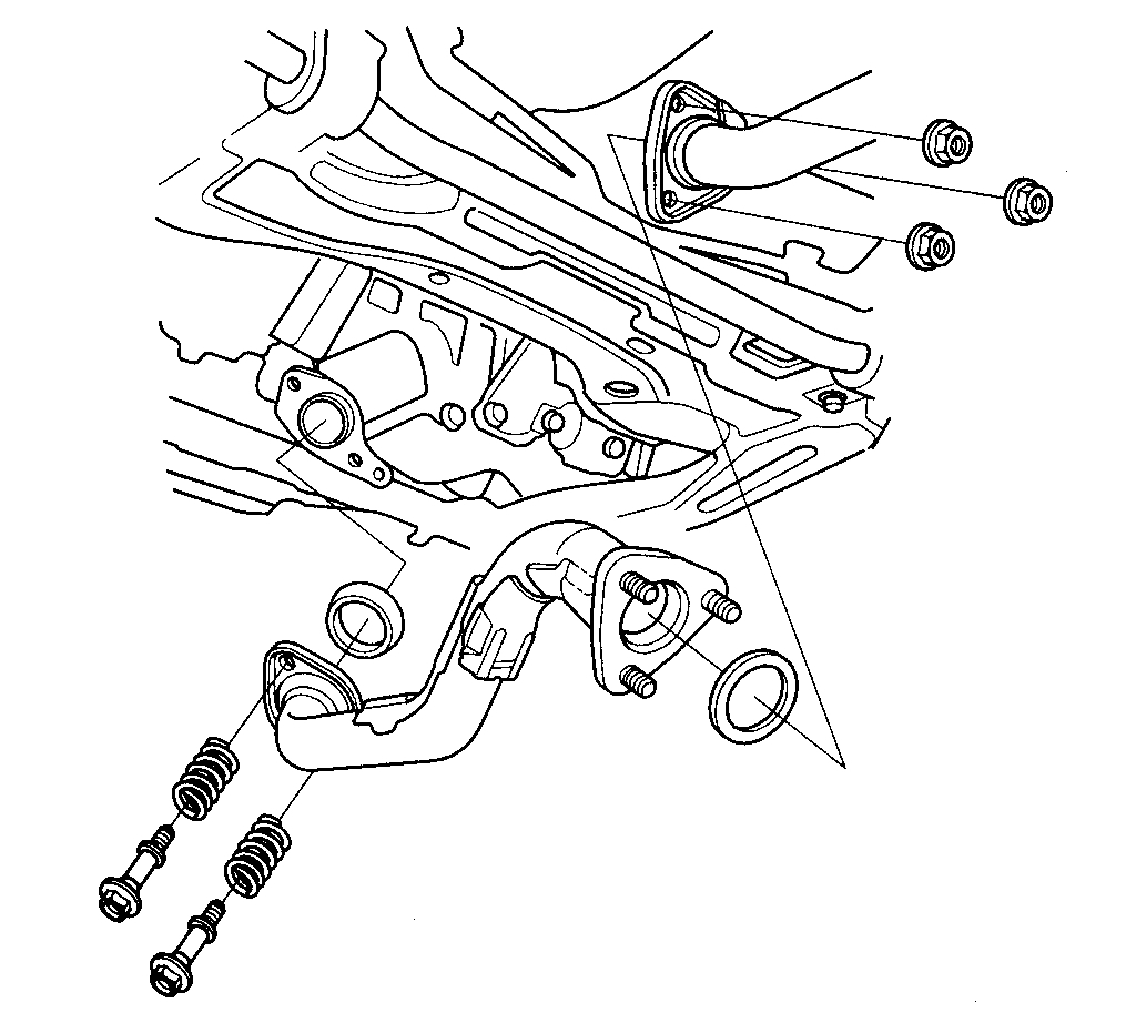

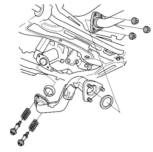

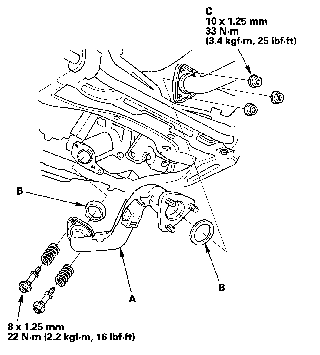

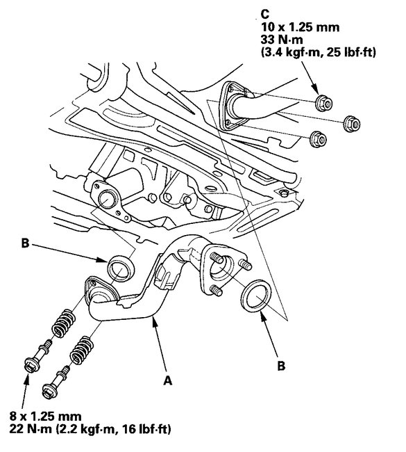

3. Remove exhaust pipe A.
pic 2

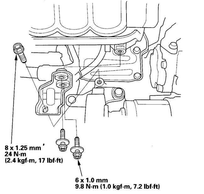

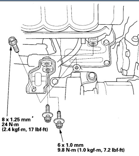

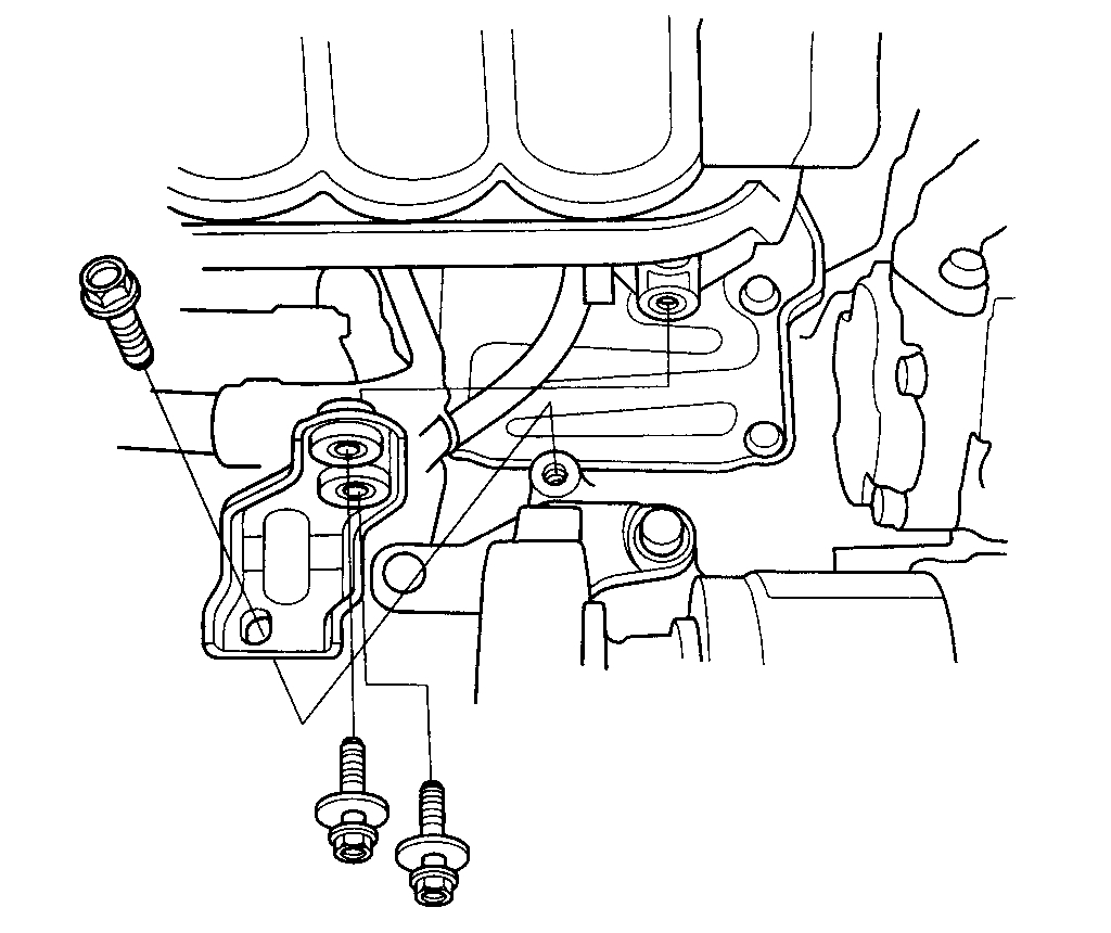

4. Remove the intake manifold bracket.
Pic 3
pic 4

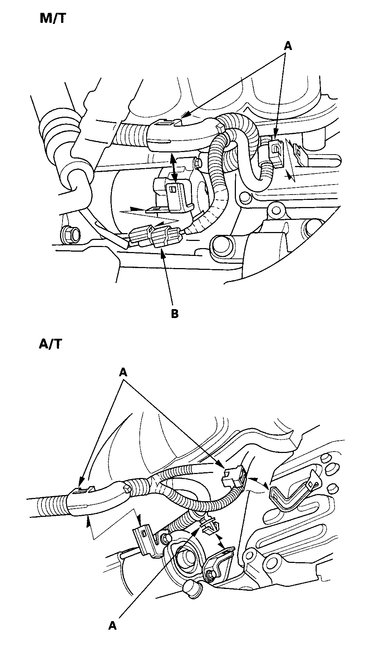

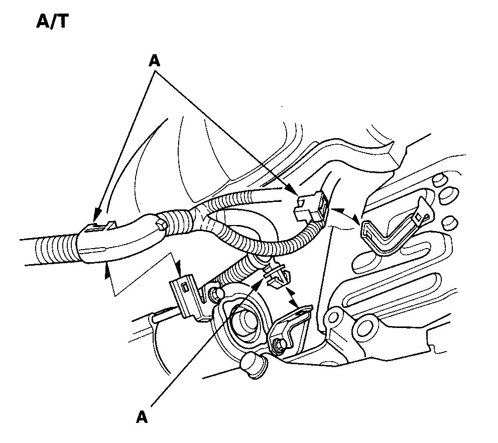

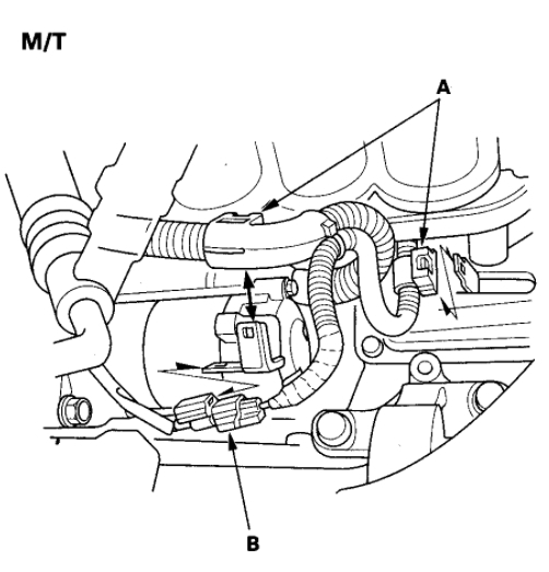

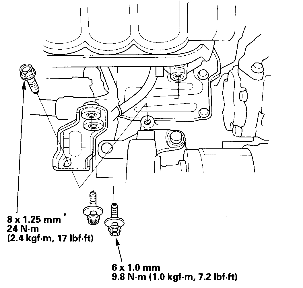

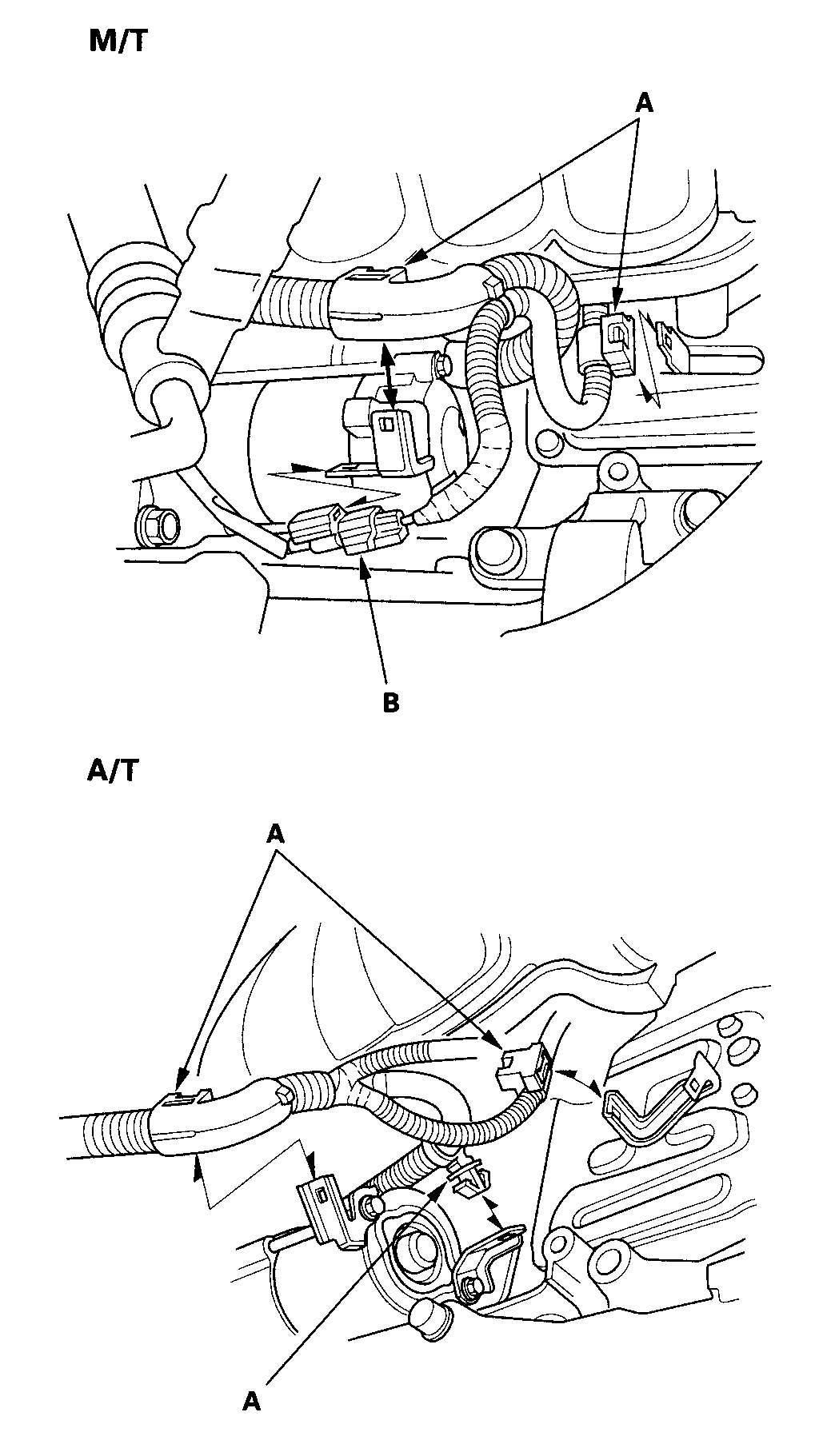

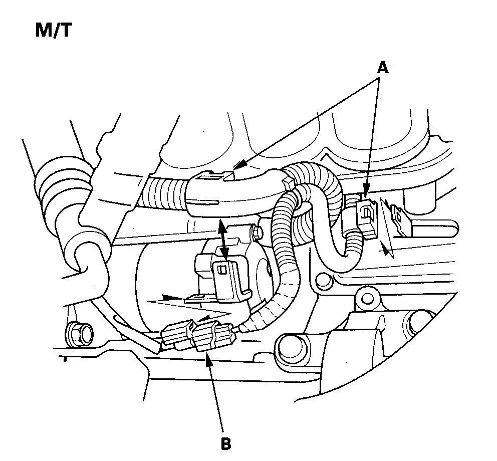

5. Remove the harness clamps (A) and harness connector (B) from each clamp.
pic 5

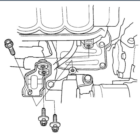

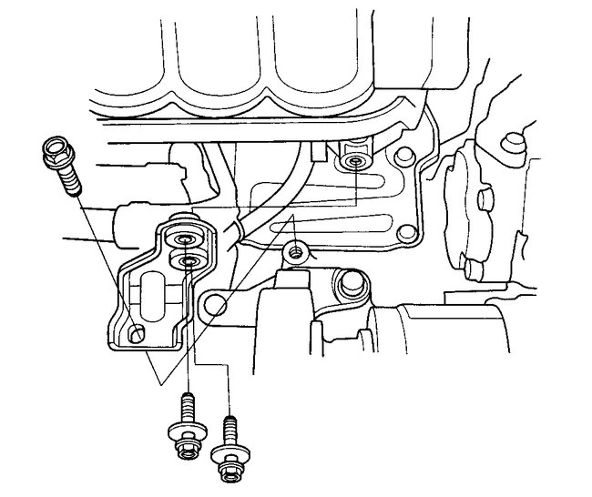

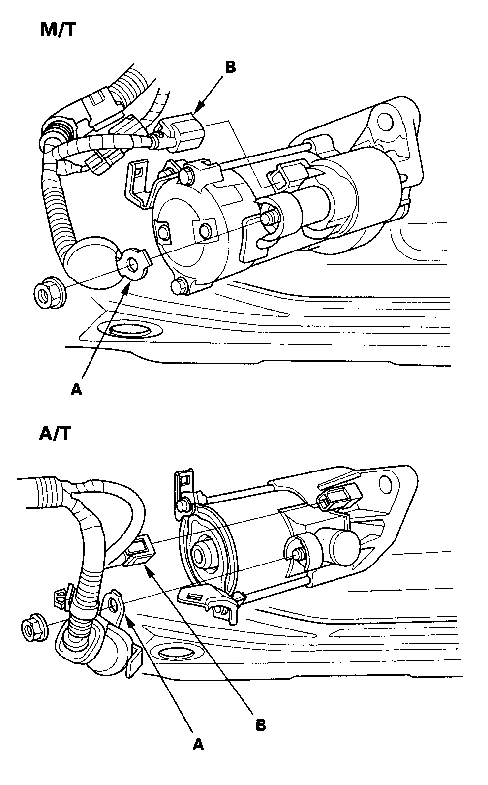

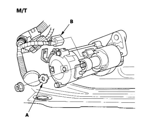

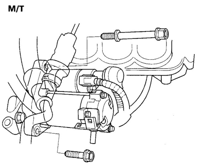

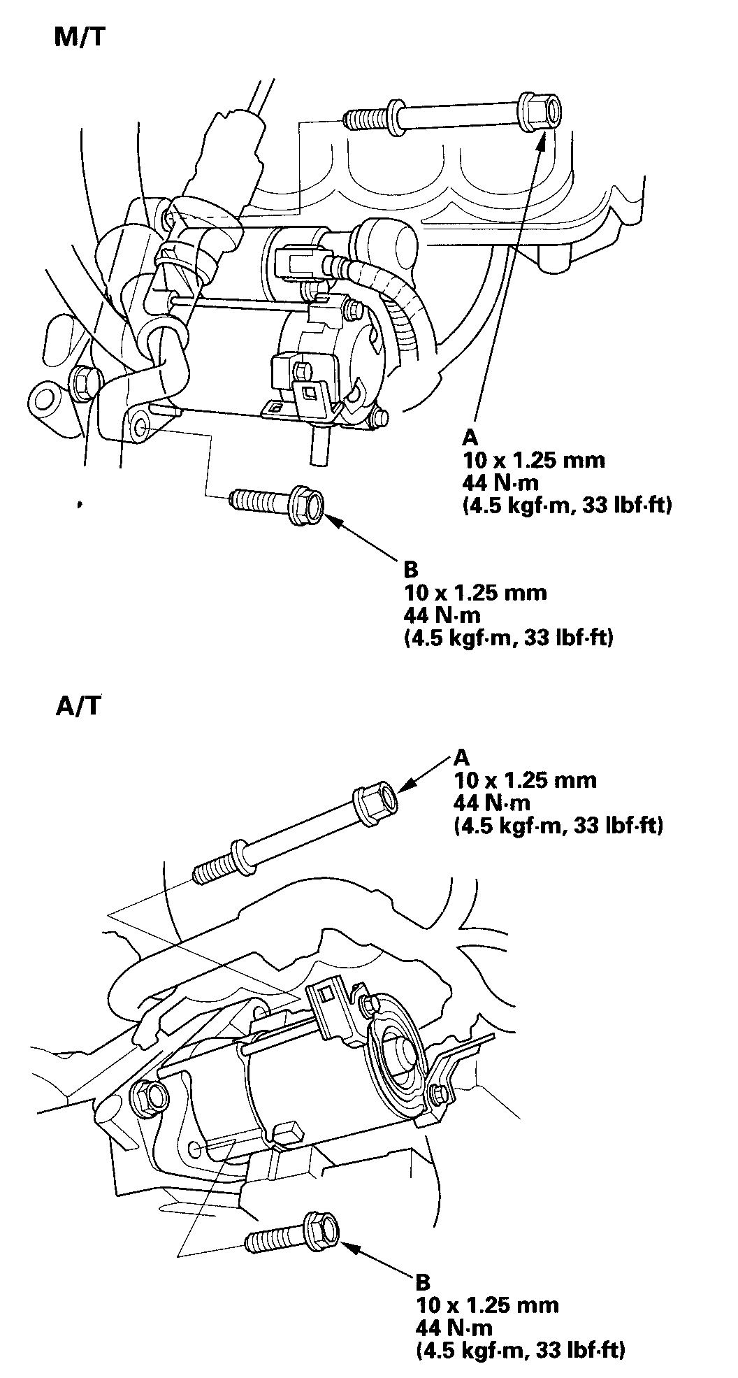

6. Remove the two bolts securing the starter, then remove the starter from the engine.
pic 6

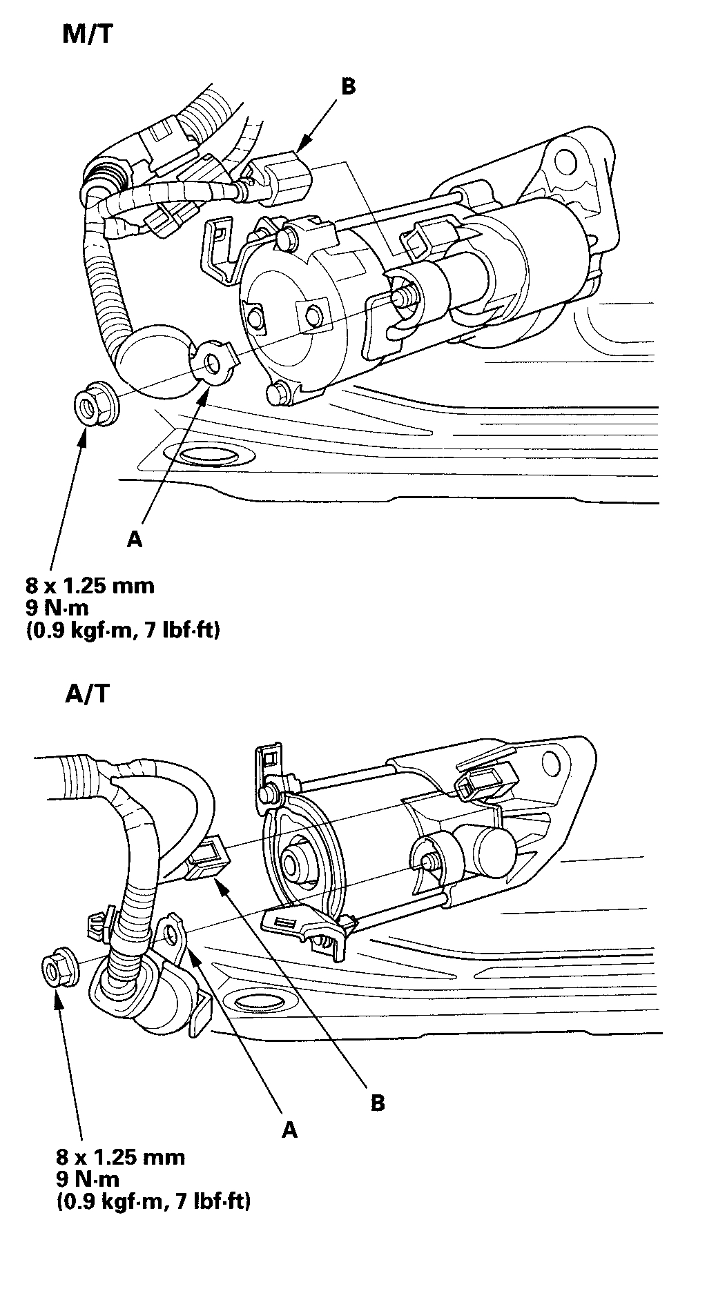

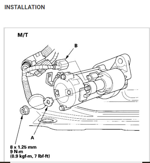

7. Disconnect the starter cable (A) from the B terminal. Disconnect the connector (B) from the S terminal, then remove the starter.

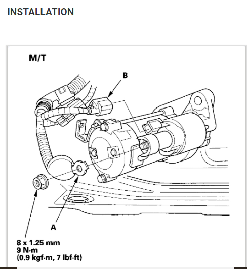

INSTALLATION
pic 7

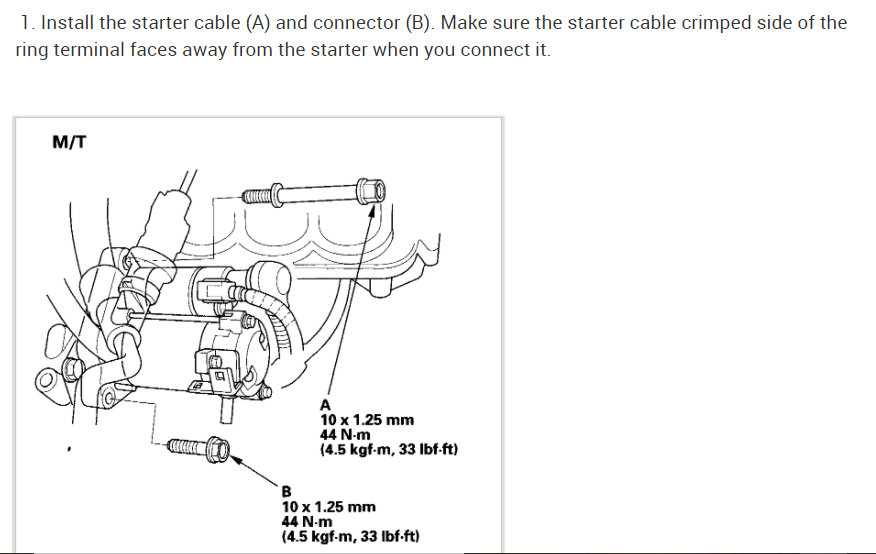

1. Install the starter cable (A) and connector (B). Make sure the starter cable crimped side of the ring terminal faces away from the starter when you connect it.
pic 8

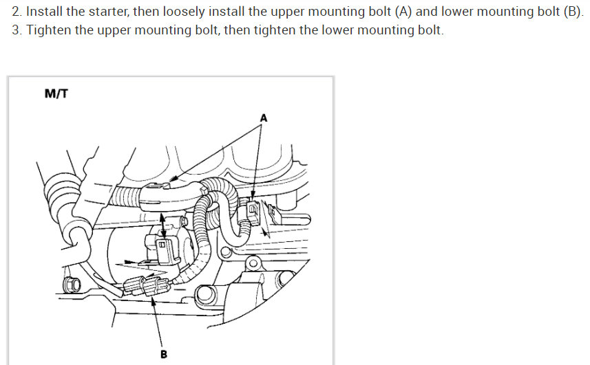

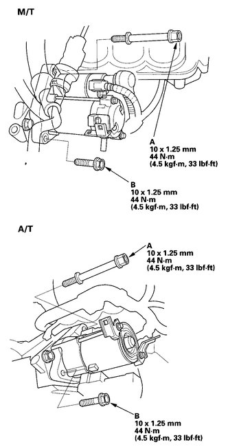

2. Install the starter, then loosely install the upper mounting bolt (A) and lower mounting bolt (B).
3. Tighten the upper mounting bolt, then tighten the lower mounting bolt.
pic 9

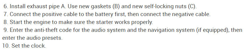

6. Install exhaust pipe A. Use new gaskets (B) and new self-locking nuts (C).
7. Connect the positive cable to the battery first, then connect the negative cable.
8. Start the engine to make sure the starter works properly.
9. Enter the anti-theft code for the audio system and the navigation system (if equipped), then enter the audio presets.
10. Set the clock.

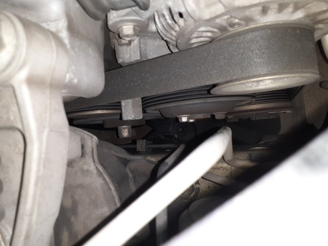

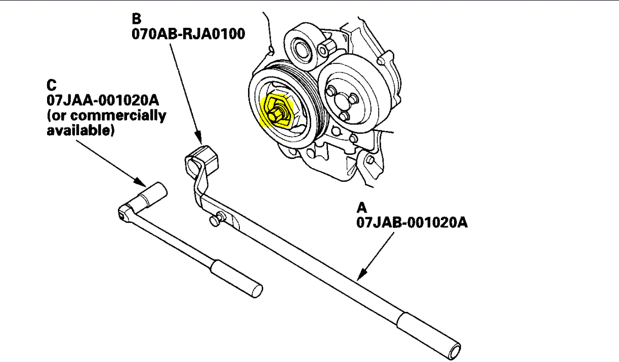

Also, before going to this trouble, make sure the engine isn't locked. See if you can turn it at the crankshaft. You will need a socket and breaker bar. Make sure it can turn.
JOSEPH2007PENA
  • 5 POSTS
To check if my engine is locked how would I do that? I'm not sure if I was looking at the correct bolts on the side of the belt. Do I need to have the car in neutral? Do I need to have it lifted? Do I keep the battery disconnected?
The crank pulley is at the bottom of the engine. See pic 1. I highlighted the bolt I'm referring to.
As far as what gear to put it in, since it's an automatic, it won't make a difference. You should be able to turn the engine regardless.
The battery being disconnected is actually a good idea. Not that you are going to damage it, but you are placing steel tools into the engine compartment and we don't want to cause a short.
Also, there is no need to lift the vehicle. You should be able to reach the bolt from the top.
Let me know if I can help.
