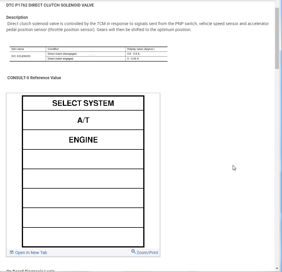

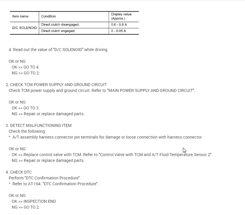

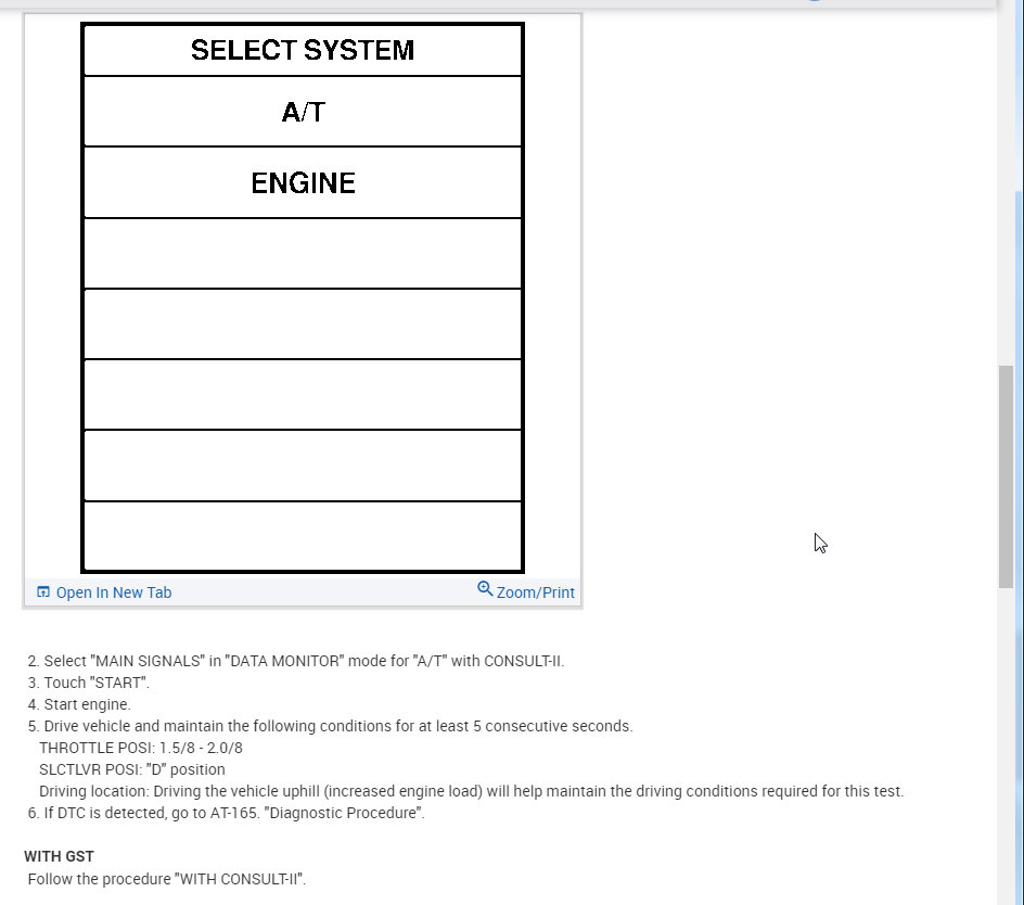

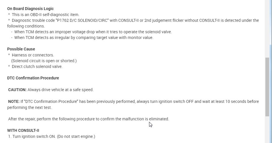

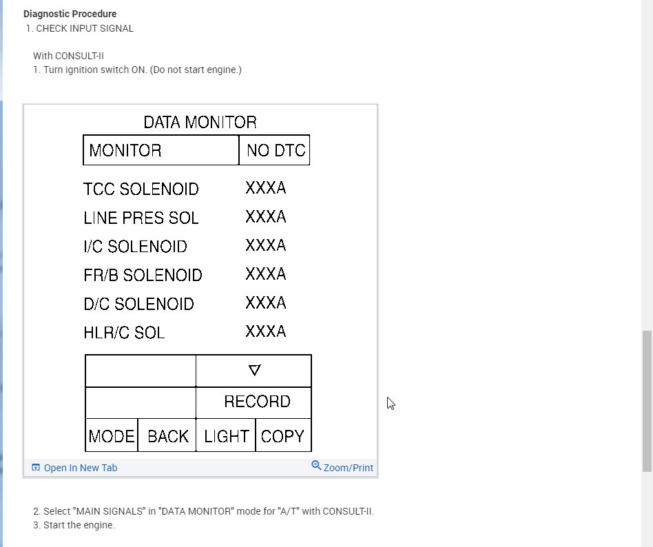

I was driving for about 15 minutes and as i approached a red light I noticed the car revving but losing power and all of the sudden it just stopped running. it wouldn't go in reverse nor in drive. And I plugged in a OBD2 and this code appear P1762 Direct Clutch Solenoid Valve. I don't understand what it exactly means though?
