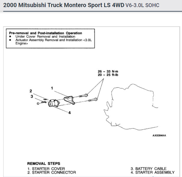

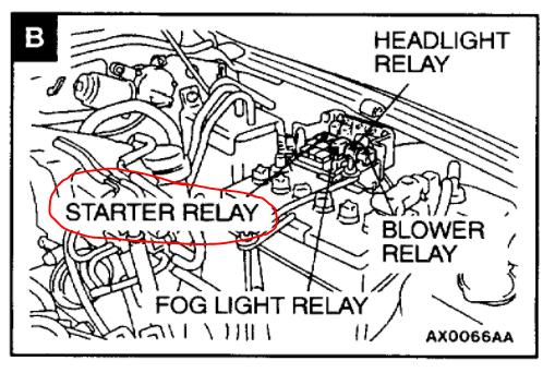

Just a quick question first. When trying to start does the starter motor engage and spin the engine over and crank or does the engine not spin over and do nothing? If it is not spinning over I think you have a starter motor issue. Here are a few no start tutorials and how to test a relay:
https://www.2carpros.com/articles/starter-not-working-repair
I've attached a picture of the starter motor relay location and how to change the starter motor. Let us know what you find and we'll go from there. Hope this helps and thanks for using 2CarPros.
