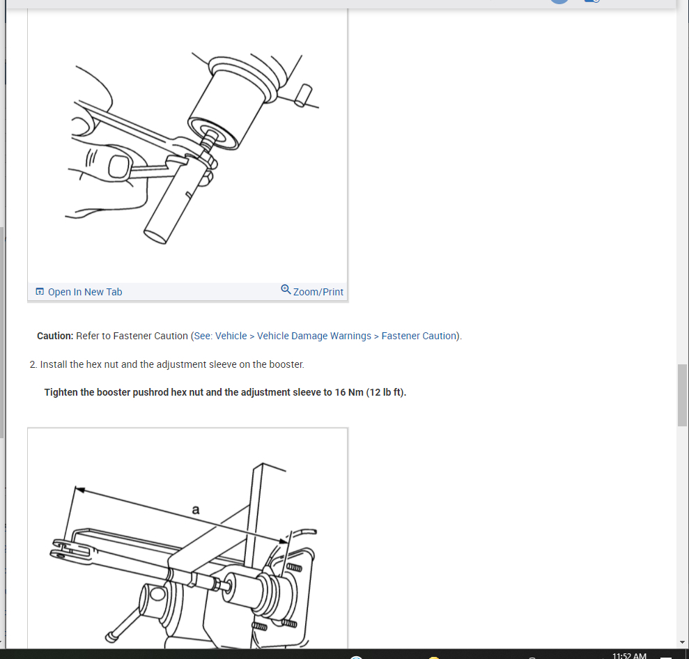

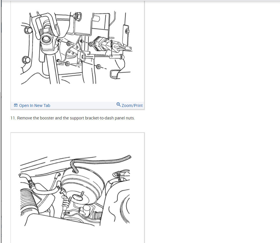

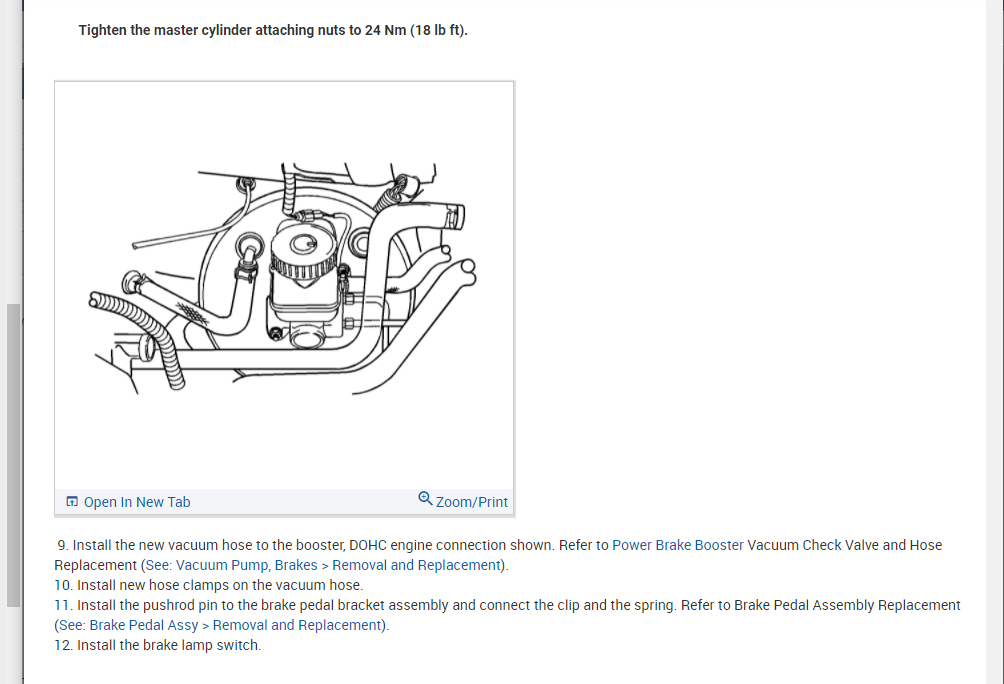

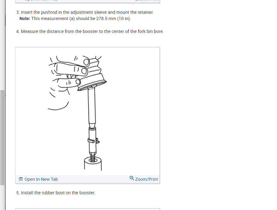

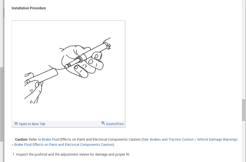

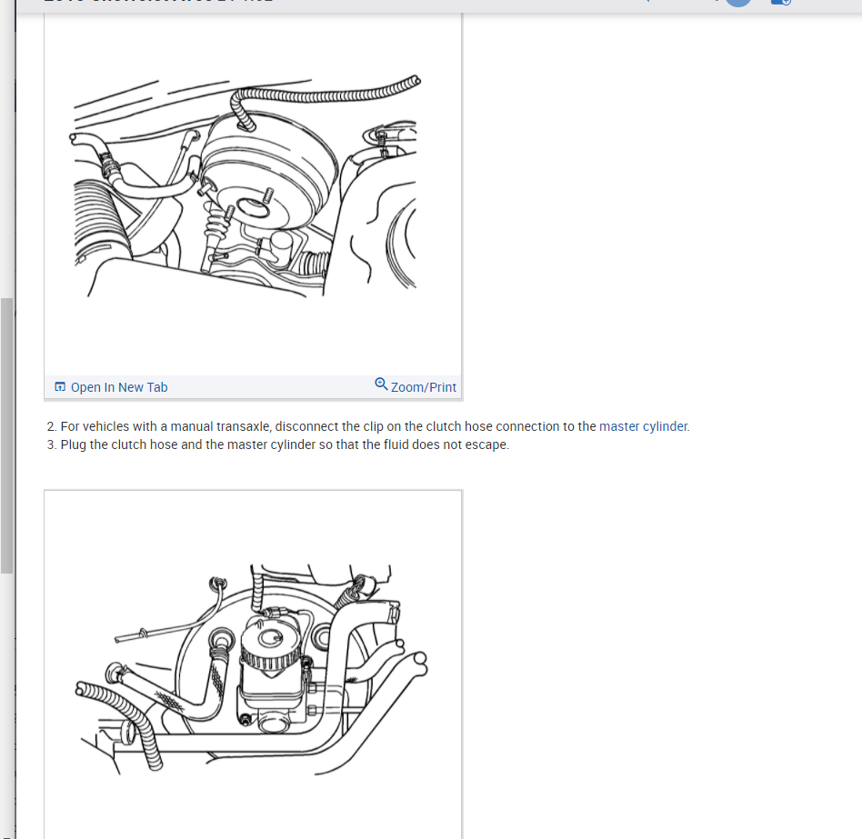

I think you have an issue with the brake booster. Basically this is a vacuum operated diaphragm that helps you push the pedal. It is just an assist system that runs off the engine vacuum so when there is a leak in the booster, it sometimes bleeds off too much vacuum and the engine will actually stall or come close to stalling. Normally when you are coming to a stop as that is when idle is the lowest and braking force is the highest.
Also, if there is a leak it will cause the pedal to be hard or could even cause the dragging that you are seeing.

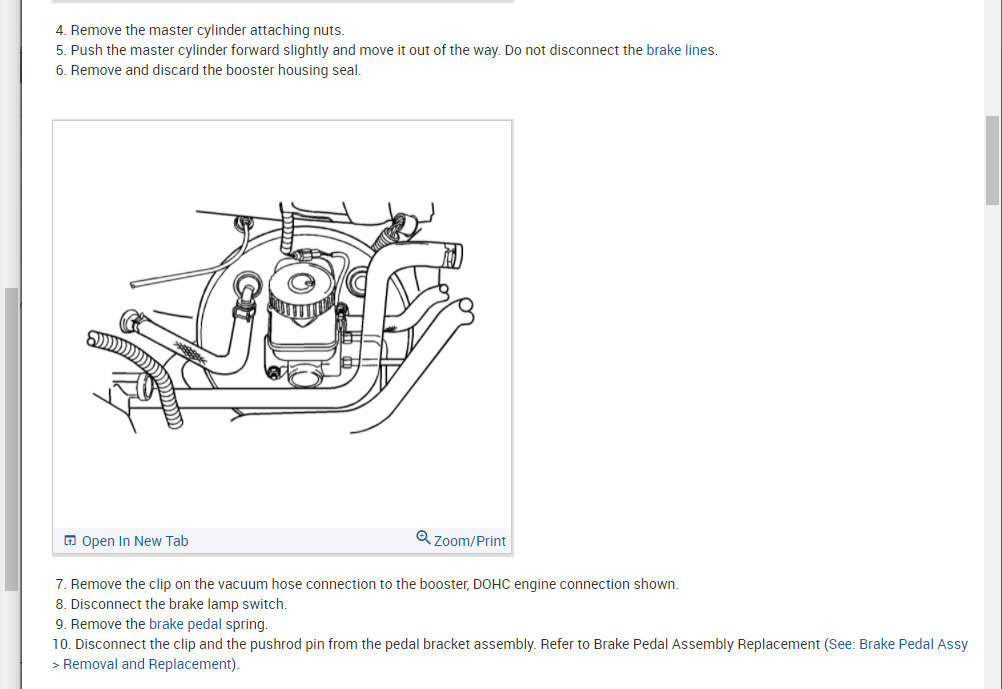

What I would do is unhook the booster plug the vacuum line with a bolt so that the engine vacuum remains constant and drive the vehicle and see if this acts up again. You are going to have manual breaks so do this in a safe location as the pedal will be hard to press all the time.

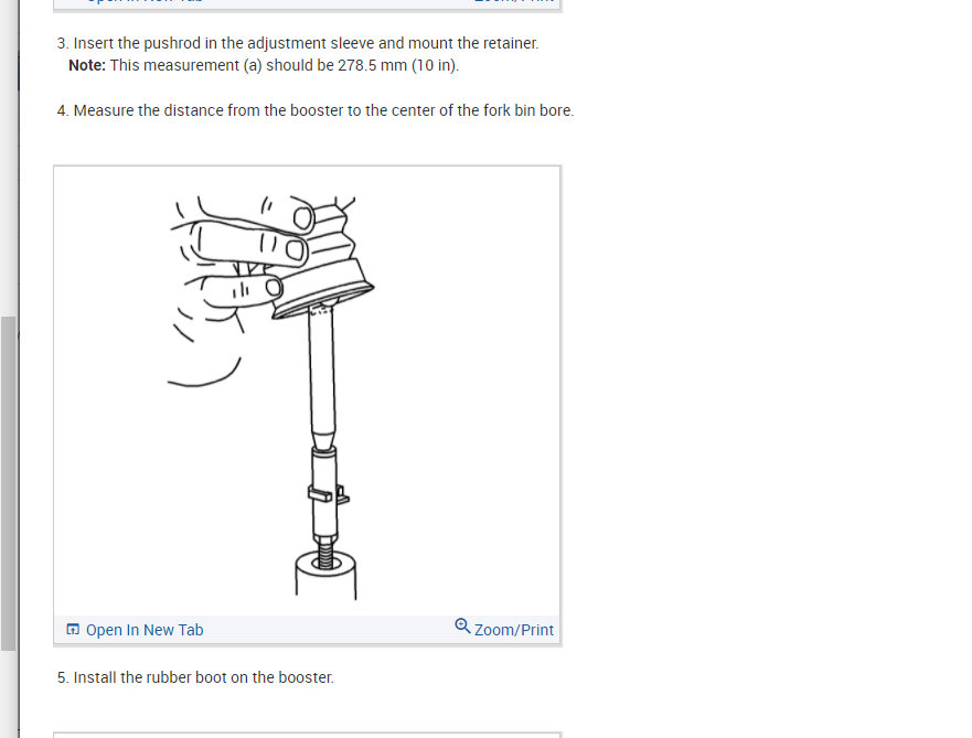

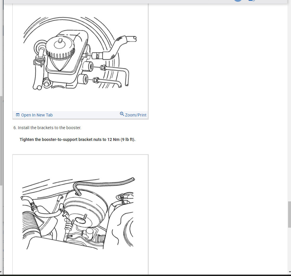

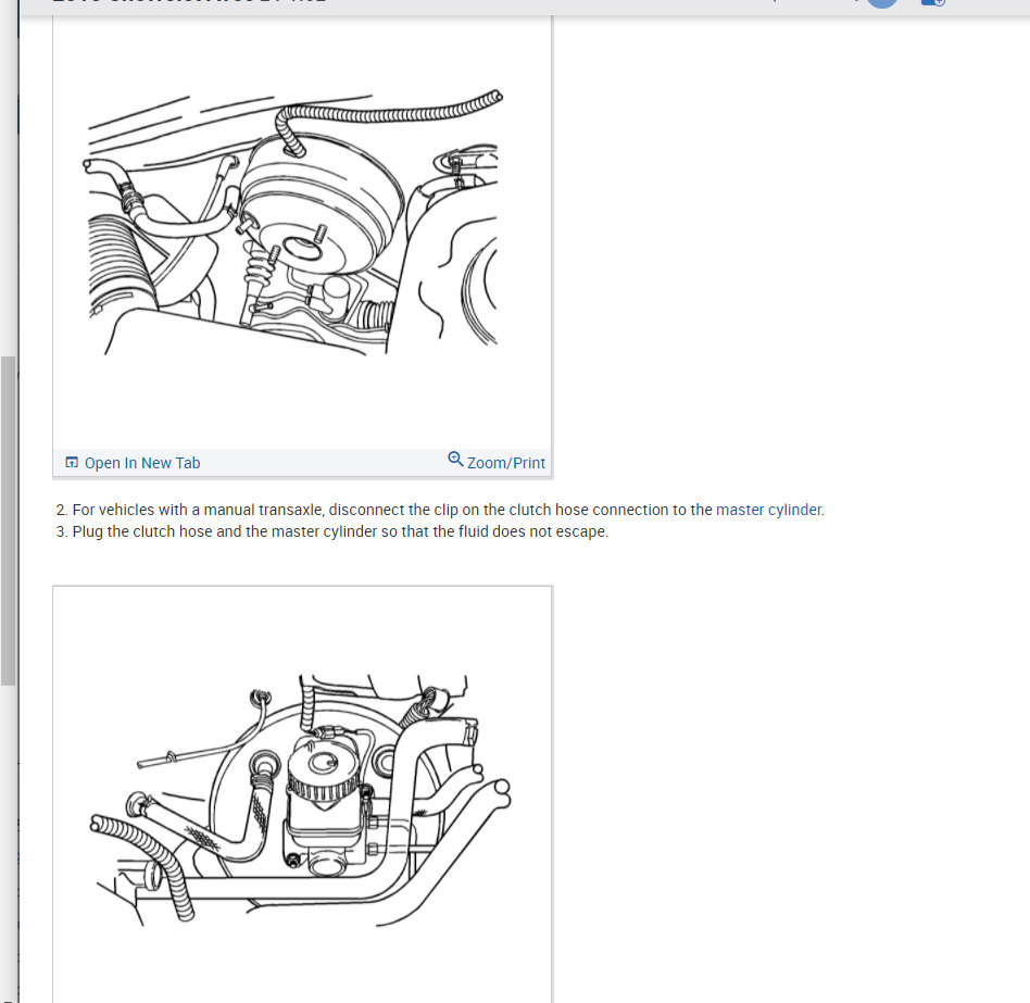

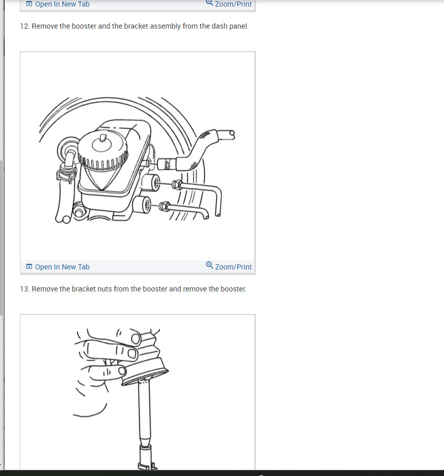

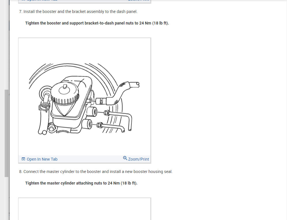

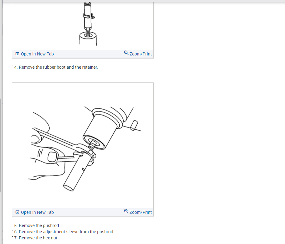

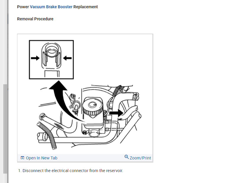

Please see the info below on the booster. This shows how to replace it but that includes the line to unhook.
Let me know if you have questions and we can go from there. Thanks

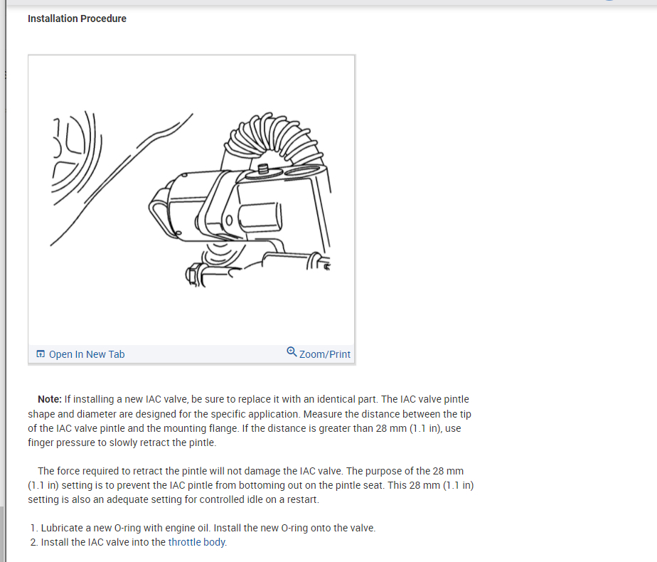

One other guy said, it could be the idle air control valve is not functioning properly. The A/C compressor turns off and on do to the drag on the engine. But with this car because it’s newer, I don’t know if the computer needs to be reprogramed or if it’s something simple and I could just clean the idle control valve.

You could be correct however, if there is a leak in the booster and that bleeds off engine vacuum then you will loose power.
The way that works is the engine relies on engine vacuum to continue to pull air in so that it can mix it with fuel. The engine makes power by burning more fuel. However, it will not burn that fuel if the air mixture is off. Basically when it is too rich, the engine loose power just as if it was too lean.
So the easiest way to prove out the booster issue is unhook and cap the line from the engine so that you don't have a leak due to an open line.
You won't have brake assist but if this doesn't happen and smooths out then the booster is the issue.

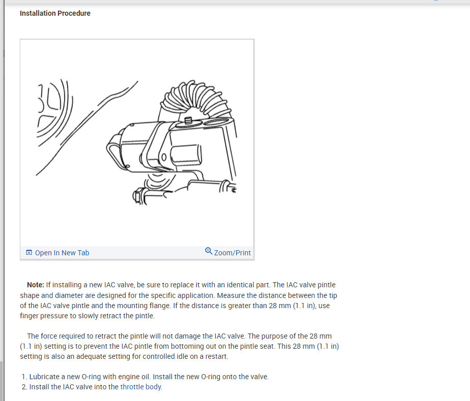

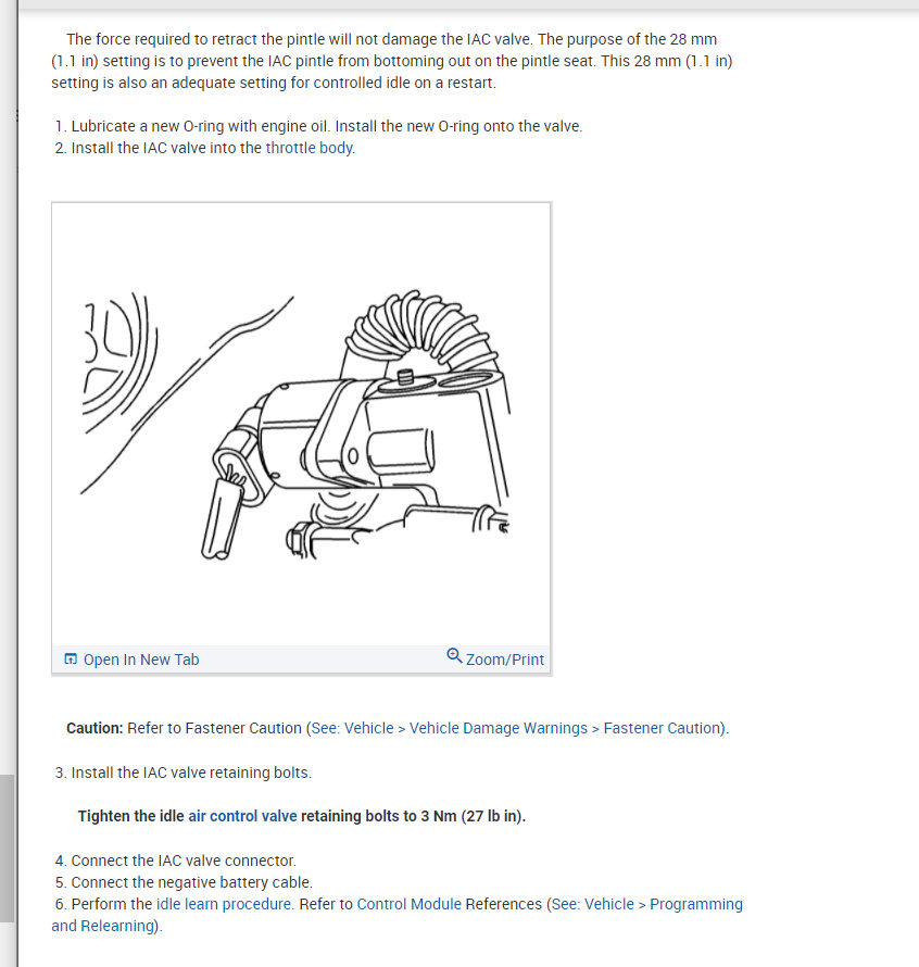

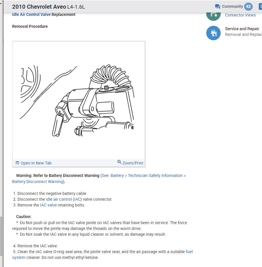

Also, the idle control valve could be an issue but again this would normally only cause issues during idling but it is worth checking. I attached the info below on this.

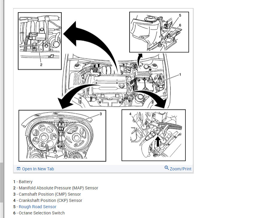

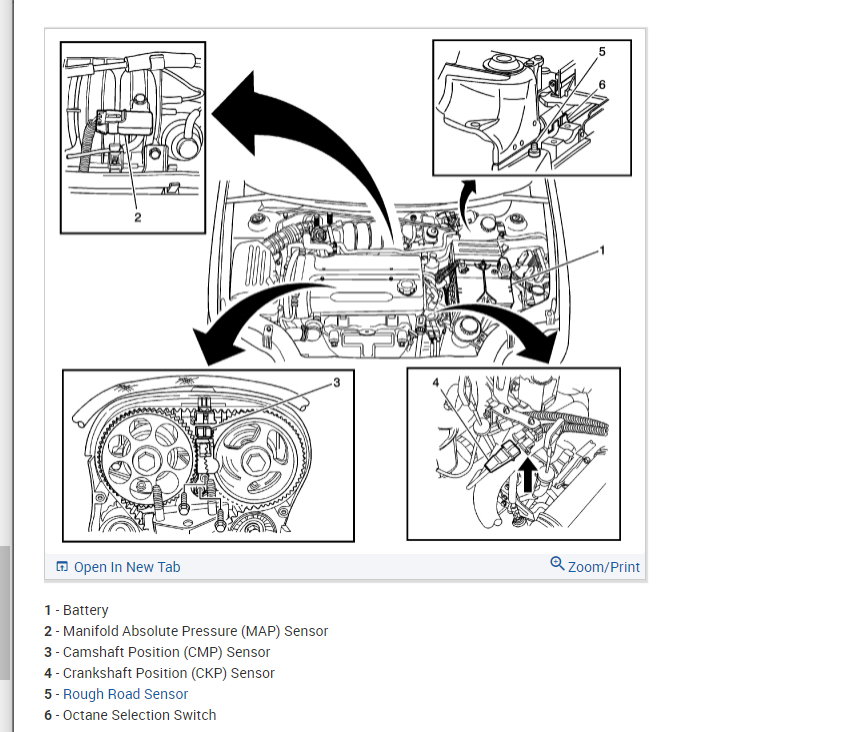

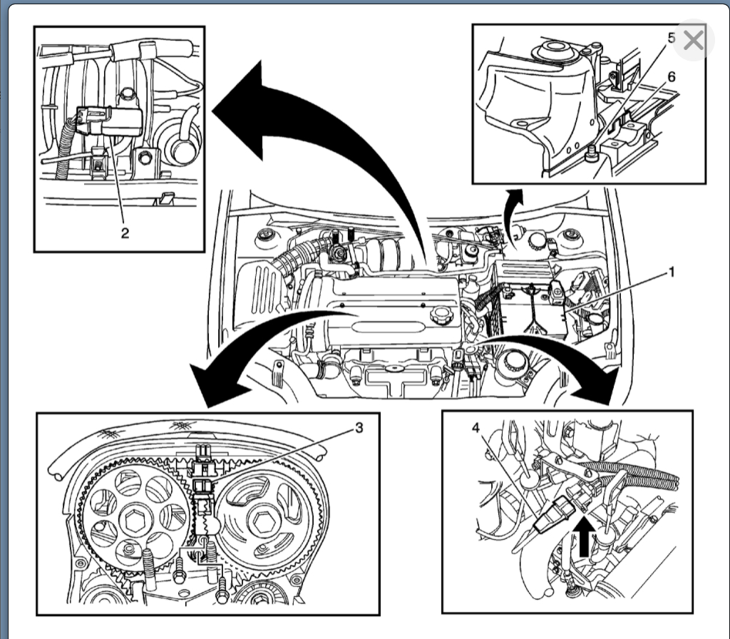

The next thing I would do is unplug the MAP sensor and see if this smooths out. This could be throwing off the PCM when the additional load is introduced.
Please see the info below.

I just checked the dealer with my vin number and they told me I don’t have a idle air control valve. I have a MAP sensor. If I disconnect the MAP sensor and idle smooths out could it be the MAP sensor that’s bad?
As for the brake booster, what do you mean by “You won't have brake assist but if this doesn't happen and smooths out then the booster is the issue”
Aug 25, 2021 at 2:09 PM
Yes. That would indicate that the MAP sensor is giving incorrect info.

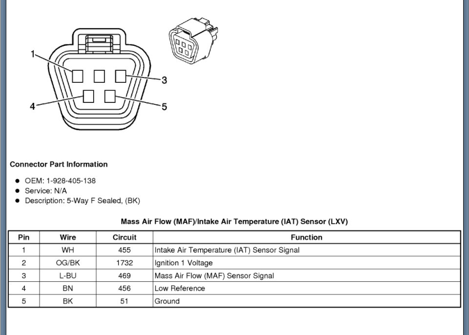

The way to check the MAF sensor is to monitor the voltage at the sensor.
First, disconnect the sensor and make sure you have 5 volts between pin 4 and 5 with the key in the on position. Then plug the sensor back in and back probe the signal wire at pin 3 and 5 and start the engine. I expect at idle, you to have around 1 volt. Then as you rev the engine up and down the voltage should smoothly increase and decrease with the engine RPM.
See below for the connector pin out to do this.

Kenny, if you are reading this thread, I want to check back with you. I was able to finally get around checking the mass air flow sensor, although it hasn’t given me problems. But I was curious to see if it was working so I looked over the specs you sent me. I did not get 5 volts between pin 4 and 5, it was more around 7.1. But I did get around 0 to 1 volts between pin 3 and 5 while revving rpms at idle and it was where it should be. The connection is clean and not damaged. I found a very slight splice at the connectors wire for pin 5. But the connector overall seems tight.
Mar 8, 2022 at 1:06 PM
That does appear to be fine. I did say that it was a 5-volt signal but that I don't think is correct. This is a 12-volt feed and then the low reference is going to be lower than 12 volts so 7 seems fine.
Clearly if the sensor is not giving an issue, then the readings are accurate so that is why it is not 5 volts.
