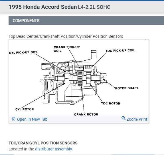

The car listed above is a 1995 not a 1991. I want to know where crankshaft sensor.
I don't find it.

I am not showing a 1.8L Accord for 1995. They used a 2.2L on these. As far as the crankshaft position sensor, it is in the distributor on the 2.2L.
If you look below, I attached a pic showing the part.
See pic below.

Thanks.
I forget electric in distributer and injector.
