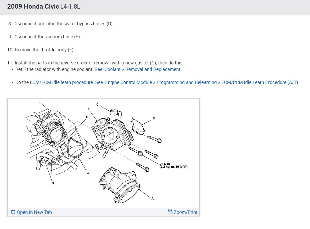

Here is a guide to help you with diagrams below to help walk you through the steps:
