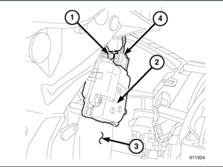

pic 1
1. Disconnect and isolate the negative battery cable. If equipped with an Intelligent Battery Sensor (IBS), disconnect the IBS connector first before disconnecting the negative battery cable.
2. Remove the steering column. See: Steering Column > Removal and Replacement > Steering Column - Removal.
3. Remove the two screws (4) that secure the blend door actuator (1) to the left side of the HVAC air distribution housing (3).
4. Remove the blend door actuator from the air distribution housing. Disconnect the HVAC wire harness connector (2) and remove the actuator from the vehicle.

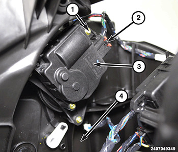

RIGHT SIDE

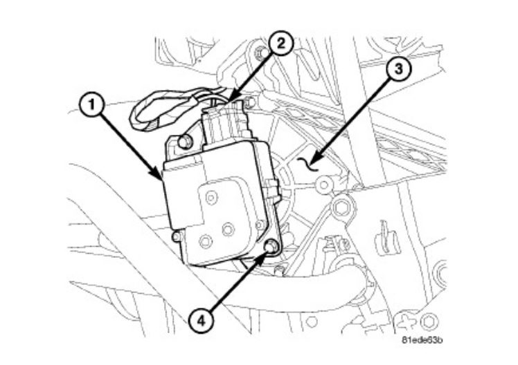

pic 2

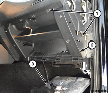

2. Remove the push fasteners, disconnect the wire harness connector and remove the instrument panel closeout (3).
3. Remove the glove box and the glove box trim panel from the instrument panel. See: Glove Compartment > Removal and Replacement > Instrument Panel Glove Box - Removal.
pic 3
4. Remove the two screws (1) that secure the blend door actuator (3) to the right side of the HVAC air distribution housing (4).
5. Remove the blend door actuator from the air distribution housing. Disconnect the HVAC wire harness connector (2) and remove the actuator from the vehicle.

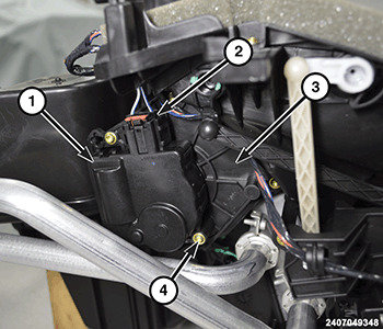

DUAL ZONE PASSENGER SIDE
2. Remove the glove box from the instrument panel See: Glove Compartment > Removal and Replacement > Instrument Panel Glove Box - Removal.
3. Remove the two screws (1) that secure the blend door actuator (4) to the passenger side of the HVAC air distribution housing (3).
4. Remove the blend door actuator from the air distribution housing and disconnect the HVAC wire harness connector (2) and remove the actuator from the vehicle.

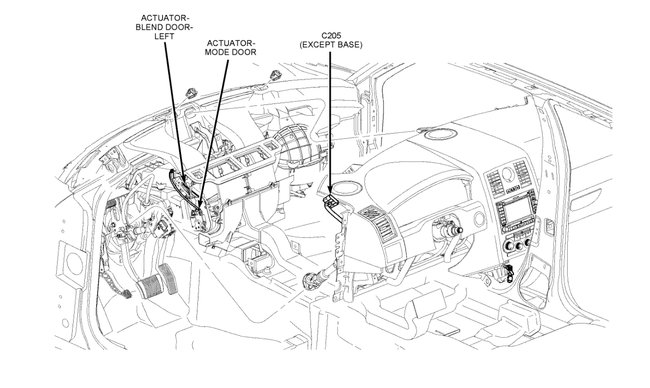

It sounds like the mode blend door actuator is not working right here isa guide to show you step by step how to replace it with diagrams below to help you see on your car.
and this may help as well
https://www.2carpros.com/articles/car-heater-not-working
Check out the diagrams (Below). Please let us know what happens.
